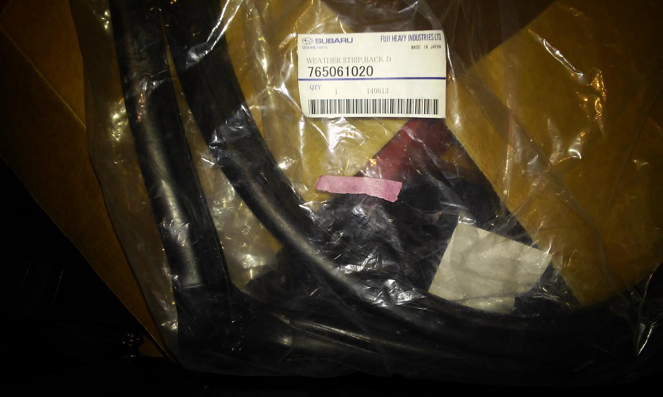

I know it's not engine related but, some amazing genuine parts goodness came my way today :D So the rear windscreen glass will be going in soon as well, which leaves me with only 1 window rubber I don't have. Probably going to have to go the custom made route.

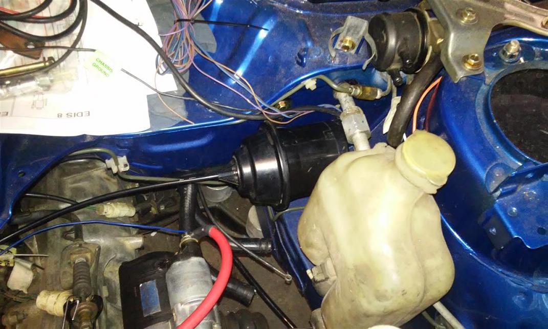

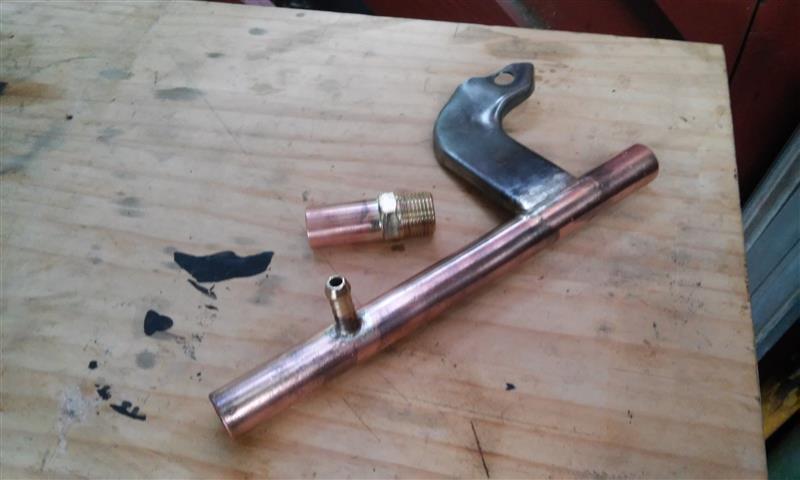

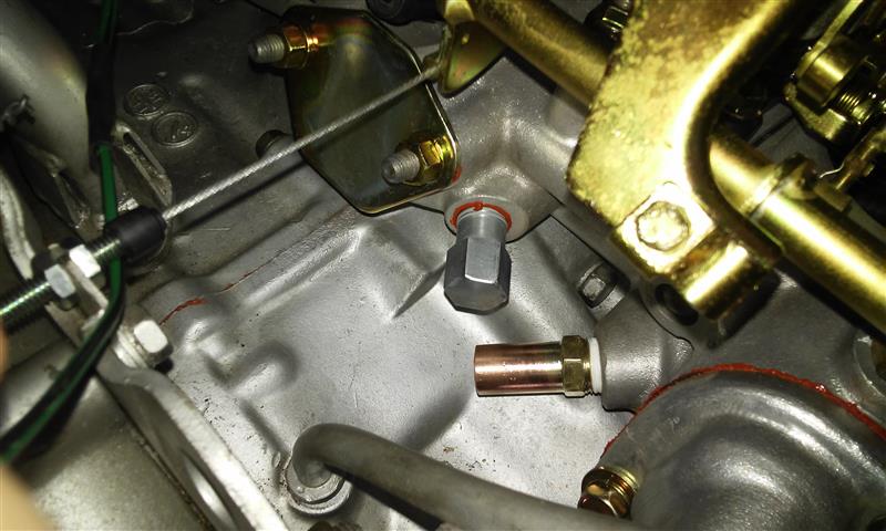

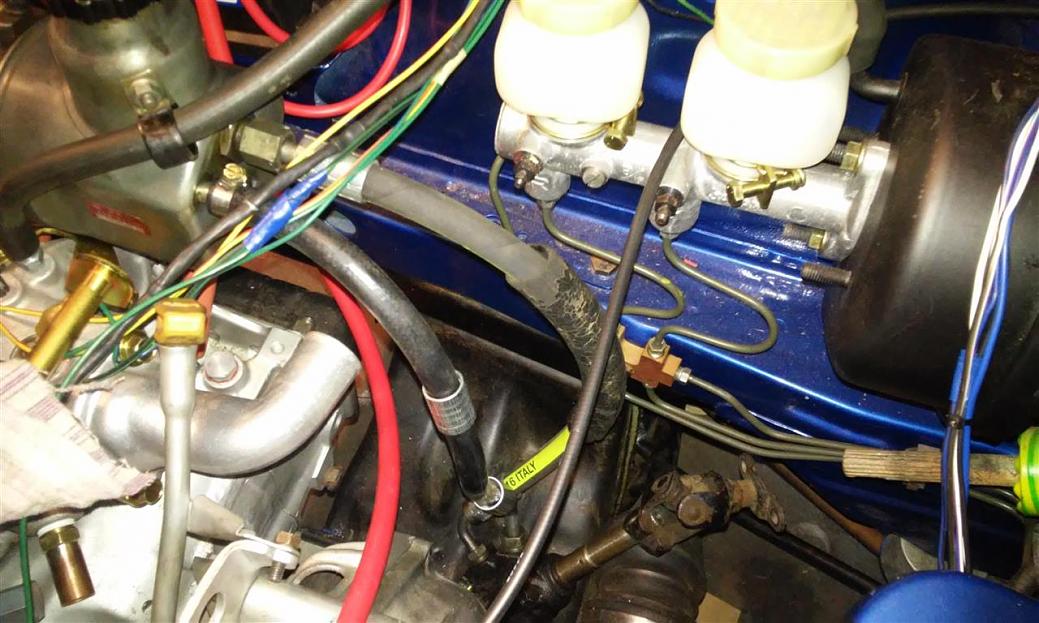

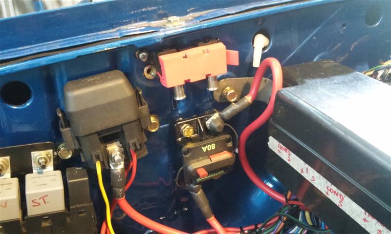

A little more progress; solved one of my main concerns/sticking points with the cooling system - the heater pipe that runs under the manifold. The old one had rusted to oblivion and I don't have the gear to braze one up myself, so got a friend to do it at his workshop. It is copper pipe with a brass 6mm barb sticking up, and the original steel bracket cut off the old rusty one and brazed onto the pipe. Gave it a clean up with a wire wheel and it looks a million bucks! Also the hole in the manifold where the old heater return pipe used to be (now a 5/8" BSP threaded hole) got a similar dealie - a brass plug with a piece of copper pipe brazed on makes for a nice place to run a rubber hose up to.

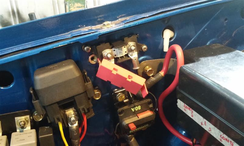

Also added another fuse block to my already fuse/breaker laden engine bay :-P This one is a MIDI fuse for the alternator line - 125A to start with. I love this little system, cable lugs get bolted directly to the fuse so nothing in between that can fail before the fuse. And if I ever need to change the rating of this fuse, MIDI fuses go from 80A I think up to 300A or so :) Easy to swap. Only downside to all the work I've done to my wiring is now I have about 6 different kinds of fuse in the system which isn't really good. Just have to keep a box tucked away somewhere with every kind of spare I might need.
One other thing, I sent my L series 2 piece tailshaft off to be assessed, I've got the word back that a custom single piece tailshaft is very do-able :) So expect to see that some time soon as well.
You'll have to ignore the un-used, mis-placed rivnut behind the MIDI fuse!

If you can afford a single piece tailshaft it may eliminate untidy flat bar sitting underneath, avoids trying to line things up. I went single after a long time, the tube diameter was a little bigger and found lost fifth gear while in motion - a lump of weld was hitting on the shift lever as I went for fifth and got this knuck, knuck noise and feel trying to shift. Thought I'd blown the box with my EA82Mongrel !
Sexy pics Sam, and um what is positive crankcase ventilation ?

Also, PCV is still there, all those other plugs you see are for the omitted EGR system.

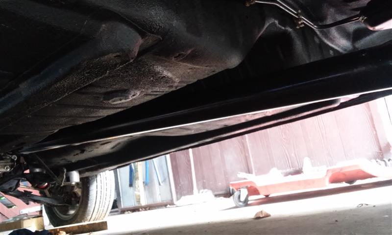

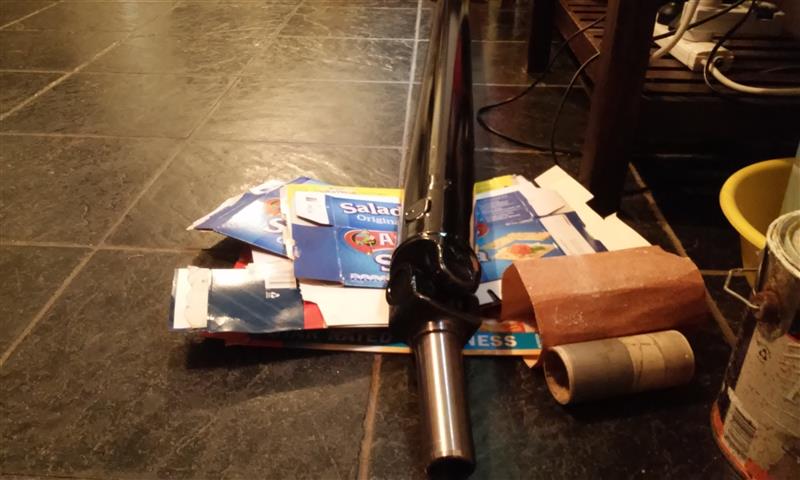

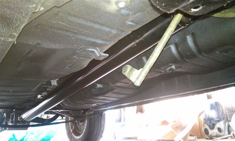

And here it is :) Just a little teaser of my custom single piece shaft that arrived today. Rebuild-able new uni's, 3 inch pipe, balanced and ready to go.
Not a very good pic, couldn't get it all in. That should be going into the car tomorrow :)

Post by steptoe » Sat May 28, 2016 8:27 am
what measures did you use centre of uni to centre of uni ? Not same as a two piece shaft ?

Post by Silverbullet » Sat May 28, 2016 3:27 pm
Jonno, used mounting face of rear diff flange to middle of the oil seal at gearbox end for measurement. It can be plus or minus 5mm so tape measure end clamped to the diff flange and Mk. 1 eyeball from underneath at the other end was good enough. Turns out the 2 piece one was the perfect length, so I sent it in as a sample, told him not to send it back :rolleyes: In a first for me, getting this done was all done entirely over the phone and through couriers; The place was an hour away from my work and I finish at 5 so no way I could get there and meet the guy face to face. When it was done, asked them to stick a courier sticker on it send it back to my work place and add it to my bill, paid over the phone and it turned up 2 hours later...I should do it this way more often :cool:
Just installed it and this shaft is absolutely perfect, really happy with it and glad I spent the money. Sometimes I'd rather spend the money to get something done professionally (and done right!) than fiddle about with it myself and possibly stuff it up. E.g the paint job and carbies. From the start I didn't want to drill holes in my floor so this was the best way to me.
For those interested this whole thing cost $550.
You'll have to excuse the range selection rod dangling in the breeze :mrgreen:

Post by steptoe » Sat May 28, 2016 4:16 pm
I was thinking if one went of the L Series tail shaft and copied its length and not allow for the assumed kink at the centre bearing it should be a smidge shorter .....
I have flat bar centre bearing mount and it looks a bit rough :(

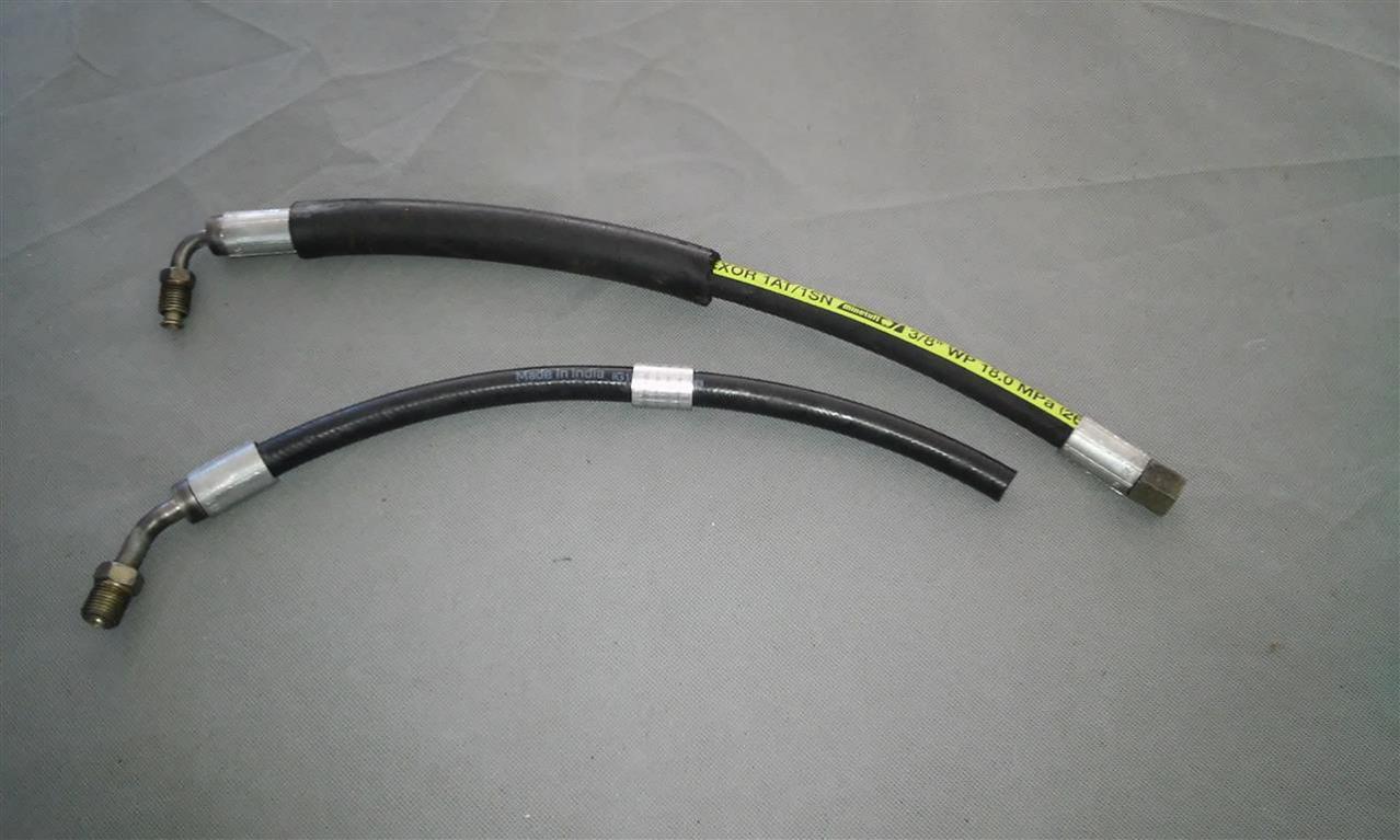

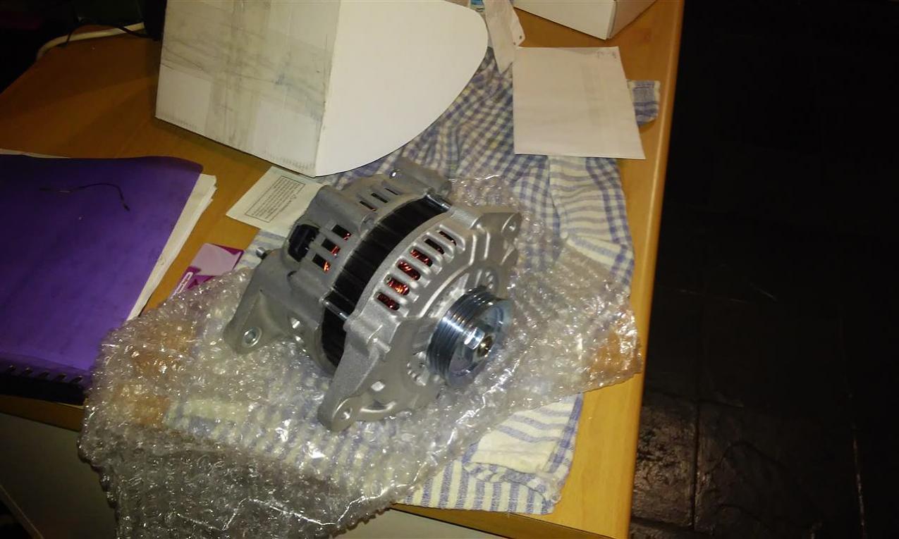

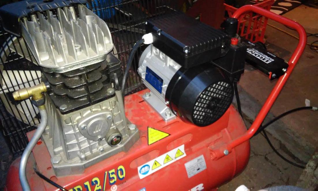

This week I got my ass into gear and got some parts off for reconditioning; Alternator/A/C bracketry is being blasted and coated as we speak, got a set of P/S hoses re-made/as new at the hydraulics joint, bought a new induction motor so I can fix my compressor finally and also bought a new alternator (90A from Nissan VG30E Maxima) pictured below. I'm liking the look of this new alt, looks like it should be a straightforward install if all the bolt holes line up nicely. Just 2 wires to worry about; charge light and sense wire (12v switched with IGN I think)
Also, would anyone happen to have any MY power steering hoses they don't want lying around? Sadly the hydraulics place has to cannibalize the old ones to make the new ones. Which leaves me with one otherwise complete P/S set without any hoses :(

Post by TOONGA » Fri Jun 17, 2016 7:17 pm
Alternator looks good I take it you are going to put a V pulley on it ... unless I missed the section where you have a ribbed section on your crank pulley.

TOONGA wrote:Alternator looks good I take it you are going to put a V pulley on it ...
Yes ;)

Also got my compressor working again, installing that motor was a pretty fiddly job.
P/S hoses re-made, better than new!
