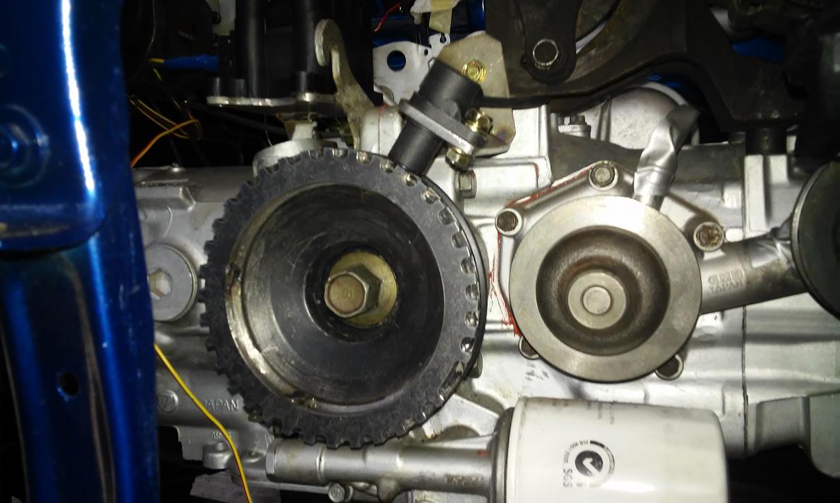

Last few days has all been bracket fabrication
Bought a new VR sensor for the EDIS system, one that better matches what I want with the wire sticking out at right angle to the sensor part. I've now mounted it where Subydoug put his, on the alternator side of the engine with bracket passing through the belts. Handily there is a 6mm threaded hole in the A/C bracketry which appears to be un-used. I do like being able to use all original bolt holes
Every bracket I've made so far uses original holes. I used the 6mm, plus an extra bit that reaches to another 8mm bolt on the A/C bracket to lock it in position. If you ever need to remove the sensor, you don't have to think about positioning it right when you put it back on. At the sensor end too, there's no way you can put it in wrong. Which is important as the sensor would need to be removed to fit belts etc.
I'm not completely happy with the 36-1 trigger wheel I bought, its 4mm smaller in diameter than the crank pulley. That means 2mm per side, the sensor has to be within 1mm of the trigger wheel so with the sensor rubbing on the pulley it still wouldn't be close enough. I've drawn a new wheel up at the same diameter as the pulley, getting it laser cut soon. And that will be the last mechanical piece of the EDIS puzzle, all wiring and programming after that
What do you do when you need a 20.5mm hole but don't have a 20.5mm drill??? Lets just say I'm glad I got a nice set of hand files for X-mas...came out perfect too
The O-ring clad sensor pops into place so nicely.
One part of the bracket is only tacked on for now, in case I need to change anything since I don't have my final trigger wheel yet.

I did my trade as a tool maker, so I quite enjoy making things out of metal and spend some time on the little finishing touches. Pretty handy with a hand file toocoxy wrote:Nice Job SB, Good to see someone else knows the importance of chamfering sharp edges, Lost count of how many times I have seen others mods and sharp edges just waiting to attack you when you're not looking.
Been a few weeks, latest update is I've added a few more wires to my loom and got a new oil pressure sender (for the 6 gauge cluster) and discovered I can quite easily convert all the old dash and warning lights to LED but more on that later and in the right thread. On the engine bay side of things the carbies and manifold are away as we speak being worked on, will come back looking like new with all the steel parts re-zinc plated and carbies rebuilt.
I've been gathering various other bits and pieces, including the EDIS trigger wheel I will actually use; the one I bought is too small for my liking so I drew one up at the same diameter as the crank pulley and got it laser cut, much better
So today I've built up the courage to weld the trigger wheel onto the crank pulley. Now they are the same diameter it was much easier to get it lined up. Made sure it was aligned right with the sensor (at #1 TDC, tooth number 9 before the missing tooth has to be at the sensor) checked, double checked, quadruple checked alignment
