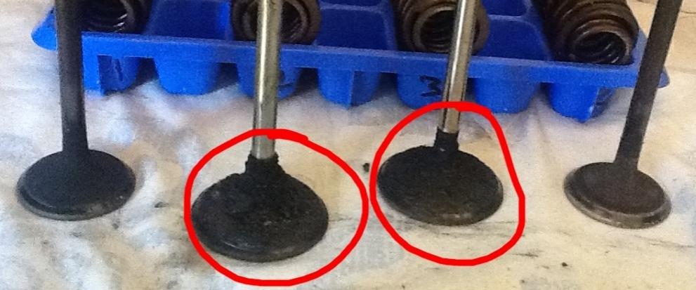

Got some more work done on the engine today. Removed the drivers side head and dismantled the springs and valves. I noticed that on both the intake valves there was considerable build up whereas the exhaust valves where relatively clean:
[ATTACH]3825[/ATTACH]
Do you think this is just old age? Or maybe the valve stem seals? Does any one have any good advice in terms of getting the old valve stem seals out (I plan to replace them all)? Should I just prize them out or is there some technique involved?

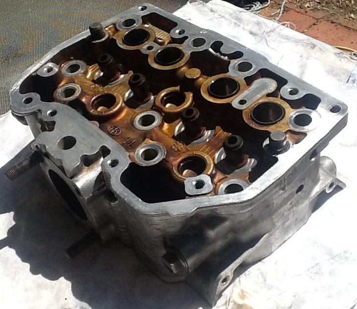

Cleaned up head:
[ATTACH]3826[/ATTACH]

As for the intake valves, I've never seen the back of them dirty like that. This could suggest a blow by issue that allowed a lot of blow by and oil residue/mist into the intake tract that slowly stuck and built up on the back of the valve.
The stem seals should pull off with a bit of effort, just make sure you don't damage the mounting clip/rim.

G'day, the carbon buildup on the back of your inlet valves is a sign that oil is getting through the stem seals and valve guides. It's probably just hardened valve stem seals, but the guides will need checking and replacement if they are worn. This causes the puff of blue smoke you see when you let your foot off the throttle.

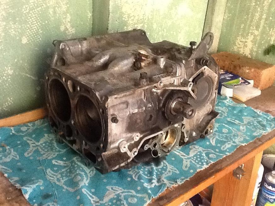

I got quite a bit done today. Pulled down the passengers side of the engine from the rocker cover back to the valve train and head. All cleaned up and waiting to get put back in. I also removed the oil sump and oil pump.
[ATTACH]3829[/ATTACH]
One problem I did have today was getting the oil filter of the pump. I have one of those filter tools but even with that I couldn't crack it. I've left it with some wd40 to soak in...any hints?
