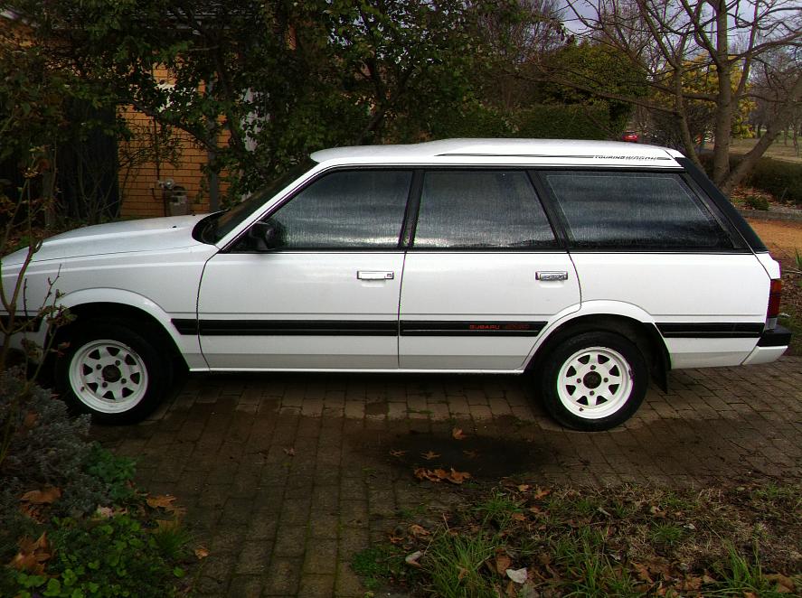

Thought i'd say hello and post a pic of my wagon I just picked up for $400.
It's a 1990, 5 speed, dual range, Mpfi with 290,000kms but has had an exchanged engine at some point in it's life.
It hasn't run for a few years so i'm going to replace the old fuel, oil, coolant and filters, chuck in a new battery and see what happens.
Wish me luck!
[ATTACH]4230[/ATTACH]

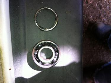

A couple of surprises i found today...
[ATTACH]4231[/ATTACH]
Seized idler pulley bearing

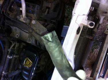

[ATTACH]4232[/ATTACH]
Split hose

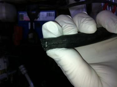

[ATTACH]4233[/ATTACH]
Split fuel line

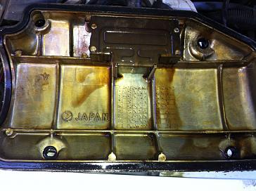

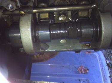

Post by PhilsWagon » Sat Aug 24, 2013 2:19 pm
Well, she's certainly nice and clean inside...
[ATTACH]4234[/ATTACH]
[ATTACH]4235[/ATTACH]

Also it looks like the oil leak is actually power steering fluid. I think a good pressure clean is in order...
Post by steptoe » Sun Aug 25, 2013 8:32 am
Lucas do a good for Subaru L Series PS stop leak, about 14 bucks from SCA , white plastic bottle with US flag colours on it, funnel squirter top. Highly recommend it after checking hoses, clamps and the flange nut at the rack

The cam belts were pretty loose so I tightened them up. I've replaced the split hoses and just need ti pick up a new bearing for the idler pulley.
I'm going to pull the oil pump one day this week and make sure it's working properly but i'm pretty busy with work so i'll see how I go.
Post by steptoe » Mon Aug 26, 2013 8:09 am
you will need some fine skills to replace that idler bearing and keep it all running true...I tried once, stuffed up once, gave up......
