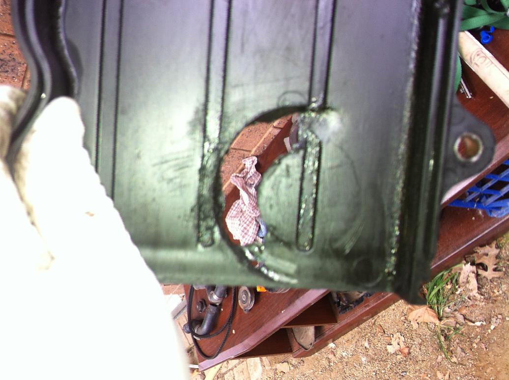

So i've been quite for a while (stupid work always gets in the way) so i thought i'd post an update...
I pulled the oil pump off and found the mickey mouse gasket had split and was starting to be sucked through so i replaced it, changed the timing belts, idler pulley and tension pulleys, put her all back together and started her up. She fired up straight away but still has the dreaded "tick of death" i've read so much about.

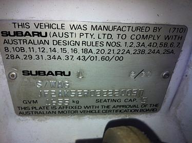

The compliance plate is stamped 2/90 so i'm assuming it is an 89 build but not complianced until 90.

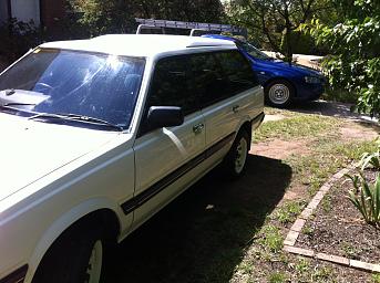

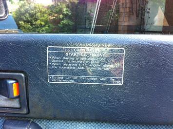

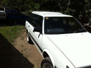

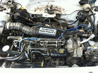

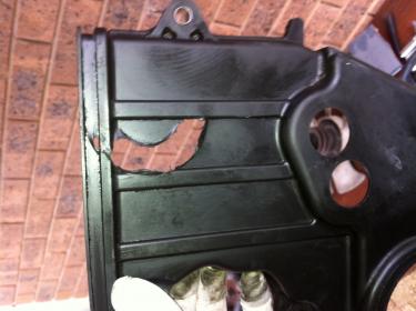

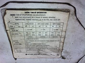

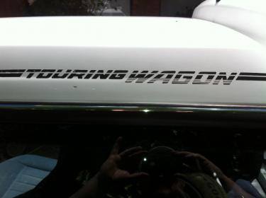

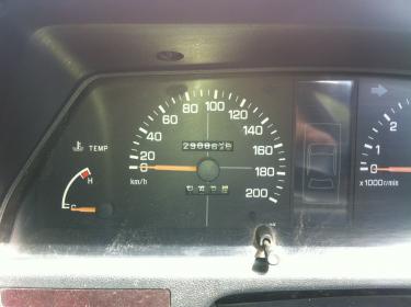

Anyway here are some more pics for you...
I've tried a lifter cleaner but it's still the same and I checked the other seal when I had the pump off and it looked ok, but it has been sitting for about 4 years so who knows

When you say it looked ok, are you saying it was still soft and had a square edge on the running face, as I've had ones look good but after changing them the noise goes away. If you've got good oil and pressure, take it for a good run on the highway and I'm confident the noise will clear up.PhilsWagon wrote:I've tried a lifter cleaner but it's still the same and I checked the other seal when I had the pump off and it looked ok, but it has been sitting for about 4 years so who knowsI'll try the spacer first because it will be the easiest to do and go from there.
Yeah.. Built date will be 89 and inside the rear of the LHF door. Best model released in Aus. The only other EFI L.Series model released in Aus was the early 85-86 RX Turbo sedans and the Vortex coupes.PhilsWagon wrote:The compliance plate is stamped 2/90 so i'm assuming it is an 89 build but not complianced until 90.
Thanks for the pics.. it really looks good all over. I did notice your dash doesn't have all the gauges mine has ?? Wonder if it's been changed?PhilsWagon wrote:Anyway here are some more pics for you...

I'm not at home right now to be 100% sure but I think I have Oil Pressure and Volts. One above the Fuel and the other above the Temp.
I'll try and find a pic on the web
