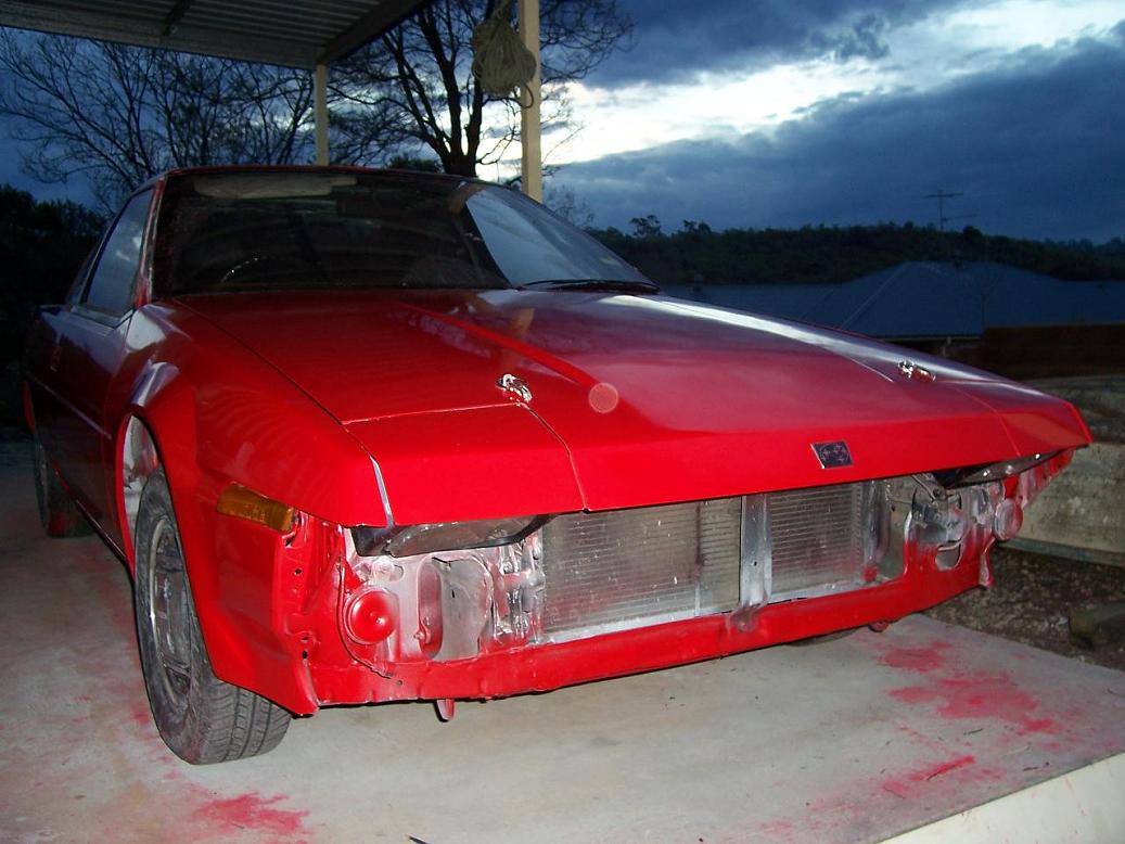

Hi i am building a vortex for racing i have a build thread on subie club so far iv fixed up the paneling welded up sunroof, full respray red gloss, and plans to put a ej20t driveline and rwd setup.

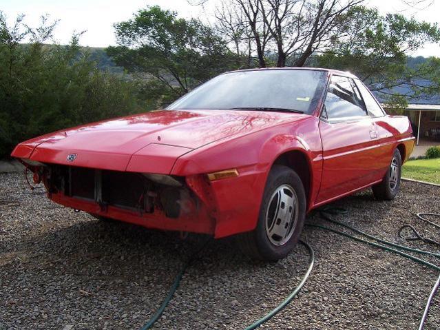

nah mate all good she sure is a door stop. awd is good but for the track i wana have a bit more fun and more of a handfull not looking to brake records. ill post up some pic

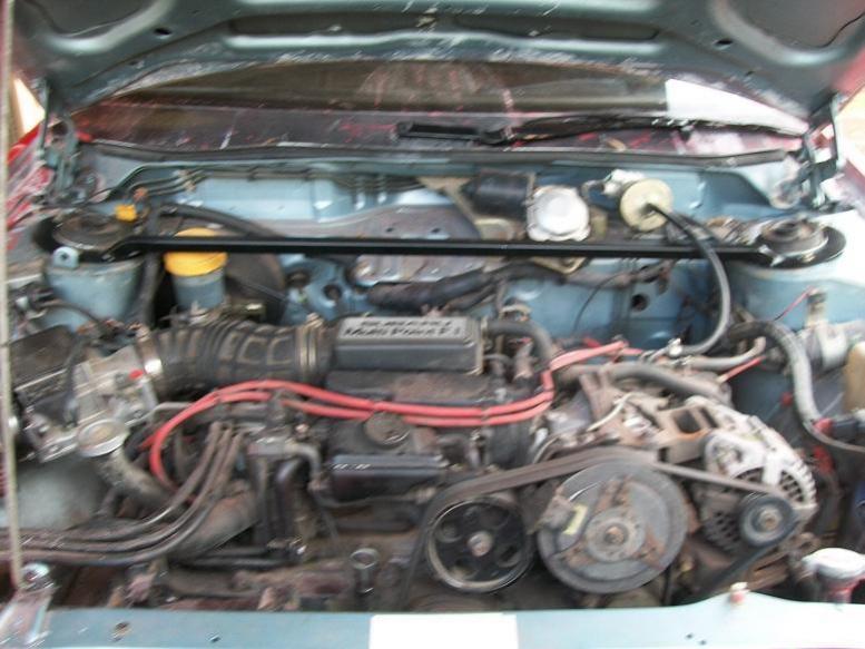

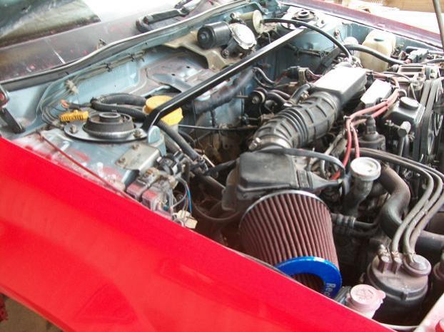

some more photos of the rig, home made strut brace working on the roll cage at the moment.

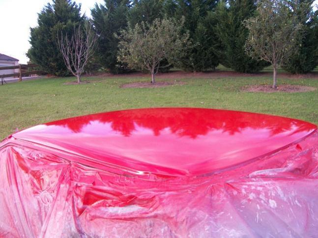

And great choice of colour. Is it two pack back yardy style?

i got heaps of views on suby club, belive it or not its enamel padock spray job, with2 pac high fill. so wat vortex u got mate?

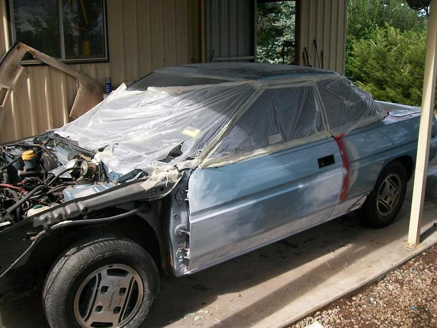

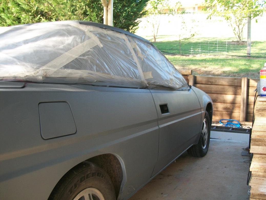

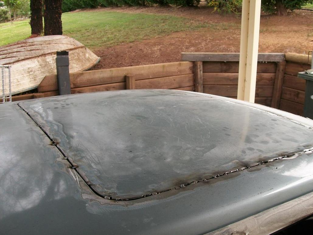

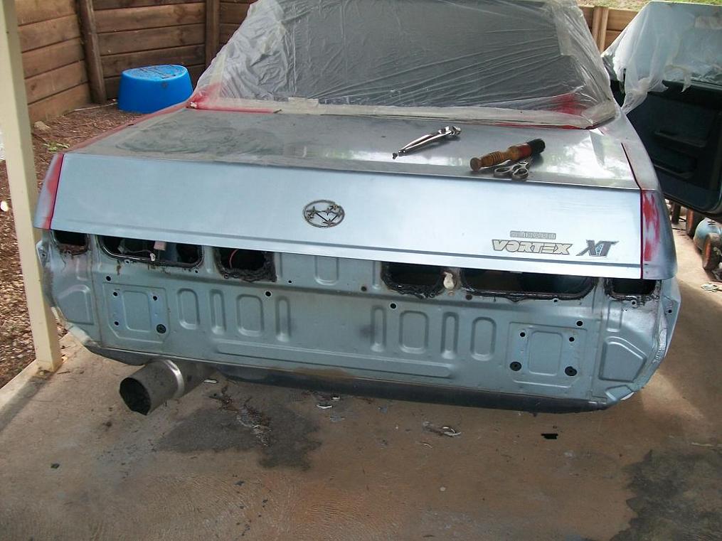

yeh it had a lil bit of gutter rust so cut that out made a new gutter then welded the sunroof up was a bit tricky with subies bein galvanised even when u grind it off it still is there and thin material had 2 tack n tack n tack till it was ridgid then liquid metal filld the small gaps then metal flake filled to seal over, then boged to smooth it turnd out alrite could have been alot beta but how far do ya go was runing outa time to paint before winter and its only a track car

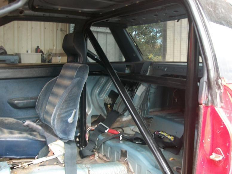

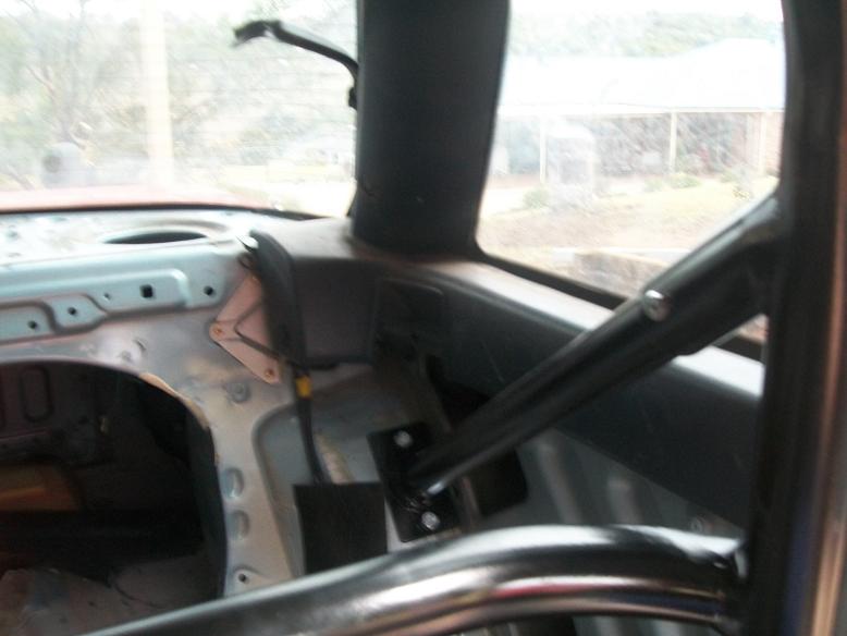

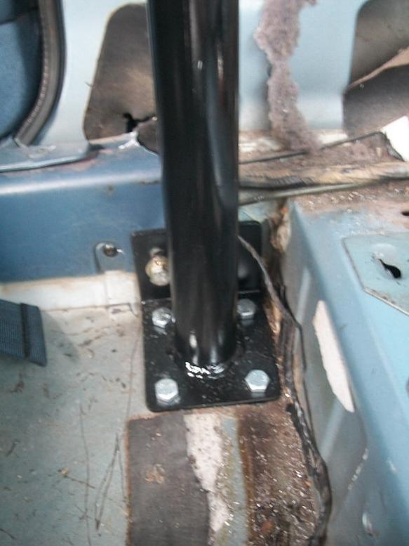

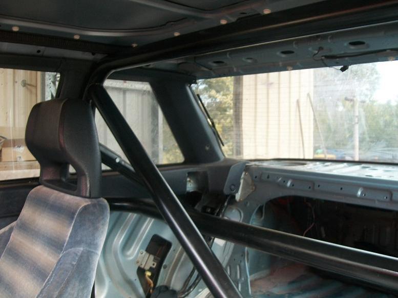

pics of the rollcage now fitted ordered custom coilovers should be ready in a few weeks.

I like it.. I'd be interested in one of these roll cages :)
vortex87
Posts: 24
Joined: Sat Dec 18, 2010 10:24 pm
Location: nsw
Post by vortex87 » Wed Aug 03, 2011 7:21 pm
ill be taking orders as soon as theres a demand lolol took long enough to make that one me old boy made it at work could only work on it on his lunch break. may look at putting intrusion bars and ones over the top to the front on it in the future
RSR 555 wrote:Image
Post by RSR 555 » Sat Aug 06, 2011 8:10 pm
Put me down for one :)

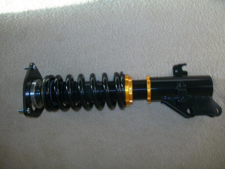

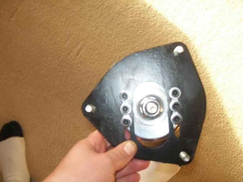

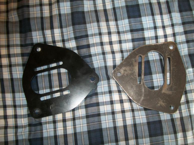

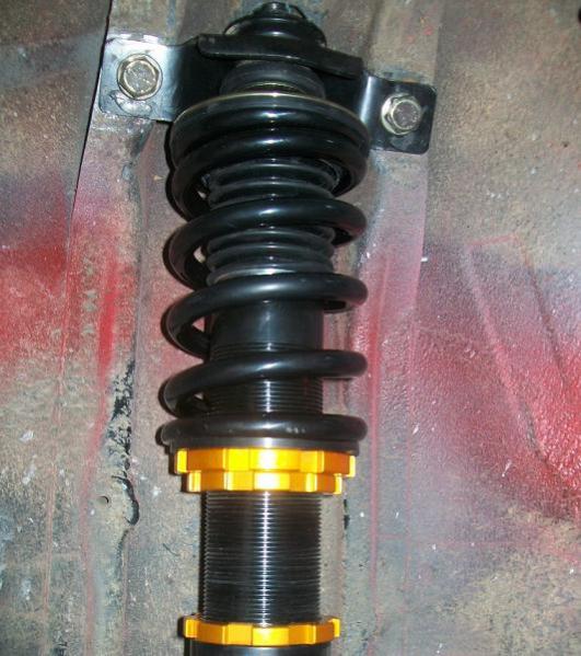

recieved my custom coilovers last week, so rears are now fitted, cant do fronts till i convert to wrx steering nuckle when the half cut goes in, just runing a stiff spring with standard strut.
with the vortex front towers being diferent bolting orientation to wrx/liberty and wanting camber adjustment on the tower i ordered them to suit the vort but they still sent me wrx ones, so i ended up geting me old boy to make some new ones on the cnc plasma cuter at work.
heres some pics.

cool, What did the coil overs set you back? Any info on them? are they off the self units? any part numbers? I'm gonna look into some for mine:)
