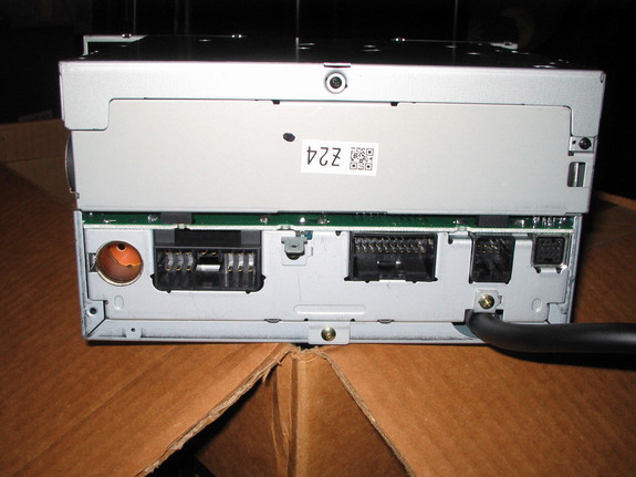

Hey Gannon, They do have a 13 pin plug but it's square, would these work in the same way as the round?
Here's a pic of the rear of the PF-25511
- PF-25511.jpg (57.23 KiB) Viewed 32695 times
Yeh I think thats the correct unit. Spoke to the guy at the car stereo shop today. He traced down the original kit- AE1251 no longer available but you may be able to pick one up on ebay. He did also say the Suzuki use the same unit. Looks like the right connector only problem I can see is he has the Iphone 5 I'll look into it deeper.Gannon wrote: This might do the trick Car Interface iPod iPhone input Adapter for SUZUKI with Clarion OEM radio
Mick.
Yeah the iPhone 5 uses the small connection now, so I think BT is the best way.
The square "CeNET" plug is used for the CD stacker control and by looking at the pin-out, it does have analogue audio, but the problem is that it wont work without some kind of digital signal, and the ea1251 somehow emulated it.
The other way is to get a stacker and install it, put a random disc in it and then splice into the cable and tap the audio lines. That way the stacker will produce the digital signal, but your ipod will supply the music
