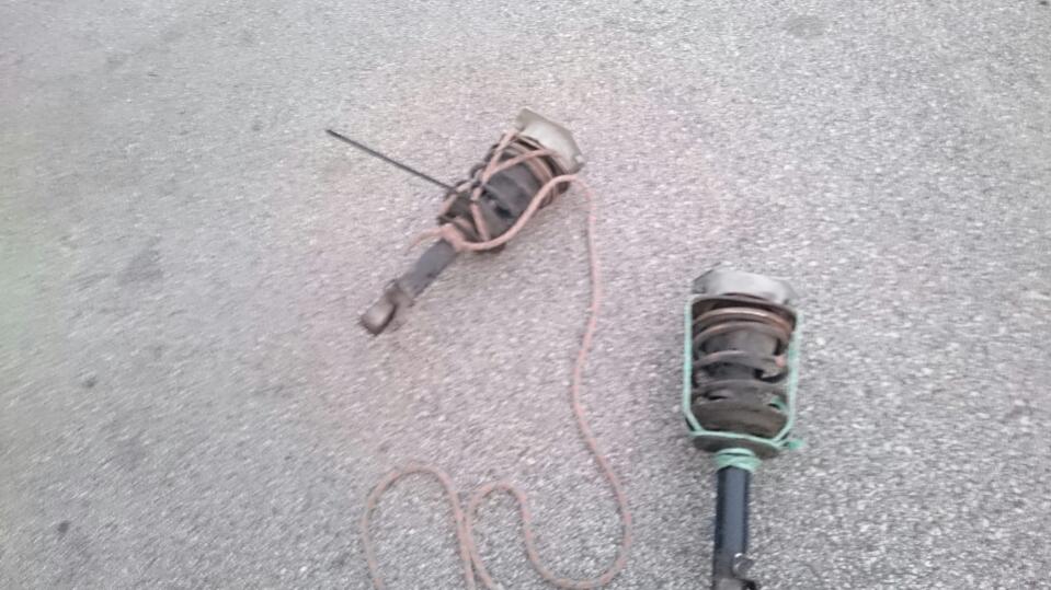

Silly question, how do you wind the rope down to compress the spring?
Subydoug
Posts: 988
Location: Carlisle WA
Post by Subydoug » Tue Nov 03, 2015 8:05 pm
Best not spilling the beans on a public forum or Il get someone hurt. If said 3rd party reader cant figure it out themselves then probably best they dont try. I actually compressed them on the car that time though, it was the only way I could remove the struts and liftblocks without dropping the LCA and associated stuff (no lift blocks under the crossmembers). I think I will grab one like yours though SB they look pretty dang good.
