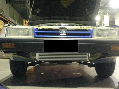

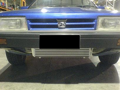

I've cut out into a spare bumber I picked off a wrecked wagon for the intercooler, so it's a lil bit drift style, it sits outside the main body of the vehicle so doesn't bugger to much up. I've mounted up into the bumber using an erray of aluminium bracket, ahhh the wonders of nutserts etc. The only problem I've come accross is plumping it up, aircon was in the way hardcore and I've had moved the battery into the rear to comensate, which is cool as I was planning on doing this anyways. On the other side I also had to move the catch can looking thing, I always foget what there really called, out of the way so I could run the intake plumbing to suit a pod and run the intercooler piping neatly. The hardest thing really was choosing spots to cut out for the pipeing coming into the engine bay. Had to choose carefull so it would suit an ej, dont particullary want to cut and shut too much.
As for the tt install, like I mentioned in my last post i have no idea where I got the info from. But I do love the idea of when people ask "what are you running?" and turning around to say "ej20tt". lol
I've got some pics(not great) from when I was dummying the cooler up, I'll post them and when I get a chance take some of the finished item and post them.

Post by '87 RX/II coupe » Tue Nov 06, 2007 11:35 pm
Here are the pics of the dummy set up, I'll get onto the finshed one's soon.
It looks alot better with the spoiler etc back on, but these will do as an idea.
