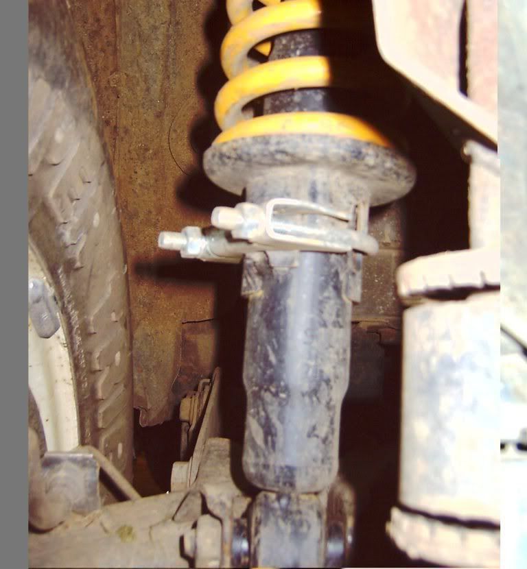

Heres a pic,they are like motorbike adjustable shocks,these are on the 2nd setting muffler clamped to stop the collars pulling over the lugs.

ahhh i get ya i see how they work.
so culdnt a 'later' L series owner buy shocks with that ccollar on them...or is that wt u did Stamp?

These are new old stock .You can't get em anymore and yes it was what i did.
