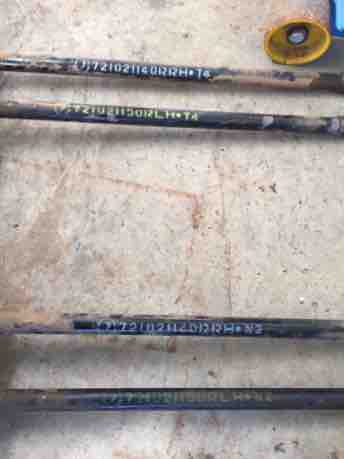

Anyone know the differences in part numbers? Ie which is out of a sedan / wagon and which is out of a brumby. Both are 23mm shaft diameter.
N2 or T4 significant? Both came of of brumbys. [ATTACH]4581[/ATTACH]
RH & LH matched the right and left hand side.
I plan on running l series or gen3 liberty shocks and springs and not using the torsion bar as primary load carrying springs only additional "helper" springs should they be needed
Thanks

721021140 rh brumby
721021150 lh brumby
721021160 hatchy and sedans rh
721021170 hatchy and sedans lh
721021060 rh wagon
721021070 lh wagon
