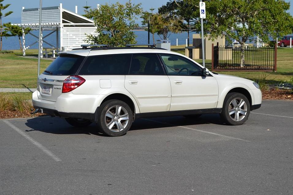

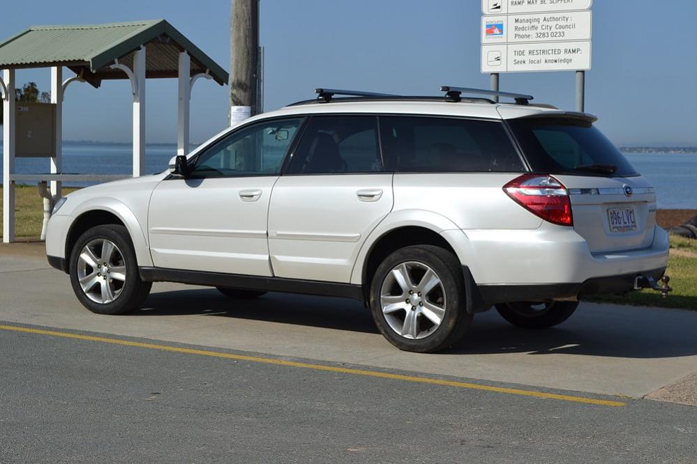

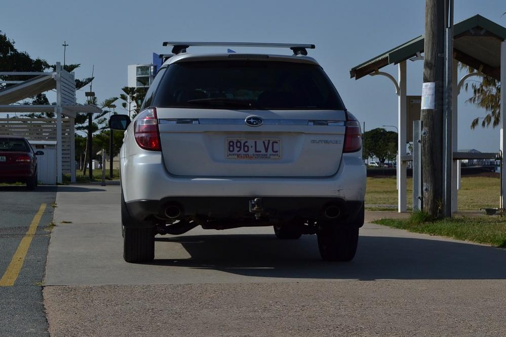

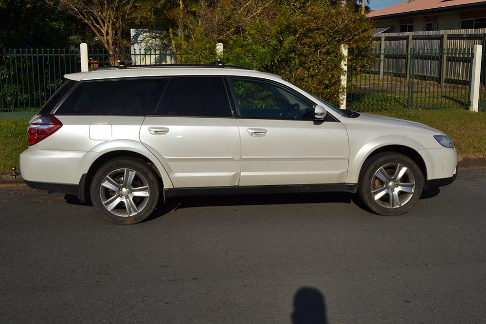

My ’09 Gen 4 Outback went in to Boxer Service to have the 25mm Subtle Solutions lift kit fitted, plus new King Springs and KYB struts on the rear only.
As mentioned before, King have a spring specially for the rear of Outbacks with self levelling suspension (part # KSRR-29SPC). It has a tapered top that fits the stock mounts. But although they have sold a few of them, King don’t have any history on the amount of lift that the spring gives. They thought that it was likely to give only a small amount (maybe 10mm) of lift, and they list them as a “replacement” rather than a “lift” spring. But they didn’t know since nobody has got back to them with any results. So I took a gamble and got them anyway. I also got the matching KYB shock absorbers, part # 341354. I decided not to play around with King Springs on the front until we saw how much lift we got in the rear.
The front spacers went in easily, but the rear springs were very solid, and the guys at Boxer couldn’t get the spacers into the rear with the spring - it was just too tight. They worked on it for quite a while, took out the sway bar etc, but decided to leave the spacers out or the lift would be too much.
Job done, the car came home looking nice - definitely a proud increase in height, but not too radical.
I took repeated measurements before and after the modification (driving around then coasting to a stop carefully and remeasuring each time). After averaging the results, the before and after differences show that the front has been raised 22.5mm, and the back a whopping 44.2mm!
So the King springs do give a big lift to the SLS Gen 4 Outback. And … I have a spare pair of Subtle Solutions rear spacers here!
Here are the before and after photos.

Looks good! Did you need to adjust the camber?
Thats a nice lift, nothing extreme, & gives it a nice forward rakeAvB wrote:the front has been raised 22.5mm, and the back a whopping 44.2mm!
Dont forget to get a wheel alignment
Yes it has had a full alignment after the fitting. They relaxed off all the suspension components, then retightened. They didn't have enough adjustment to get back to zero camber at the front, so it's got 1/2 degree positive, which they think will be OK as the tyres tend to wear on the inside with the stock configuration.
