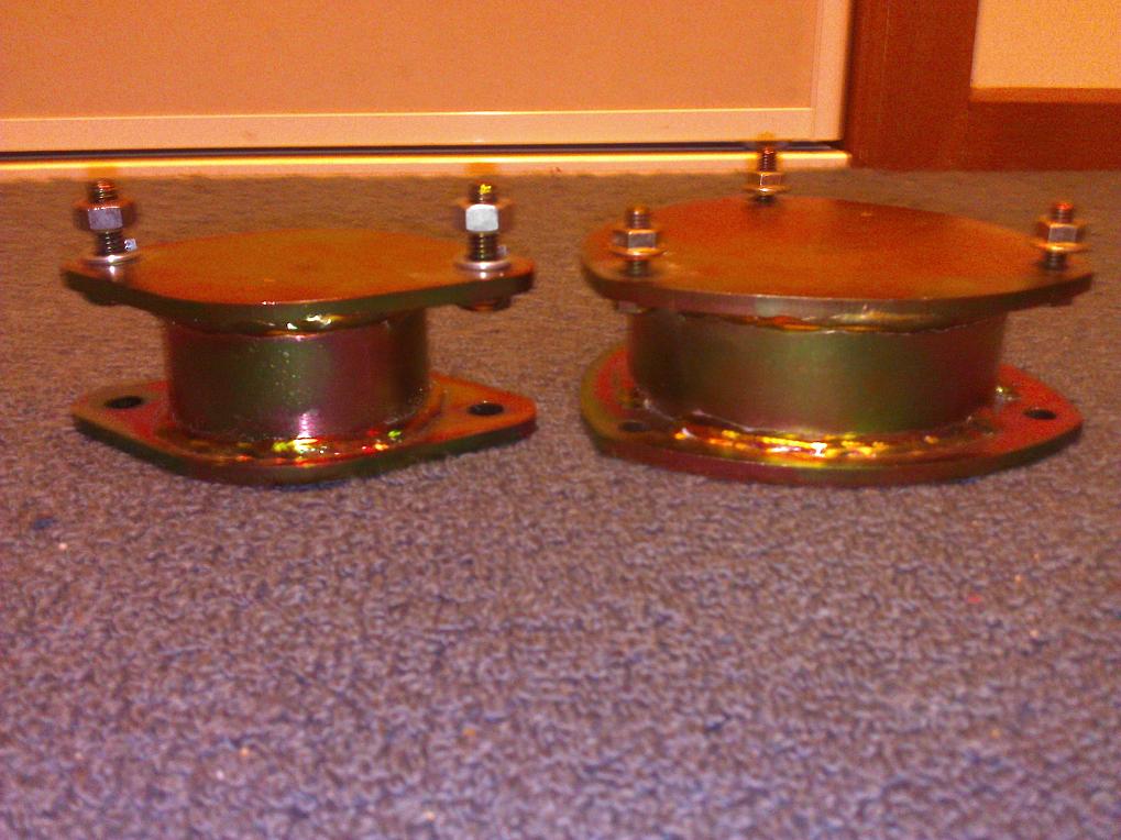

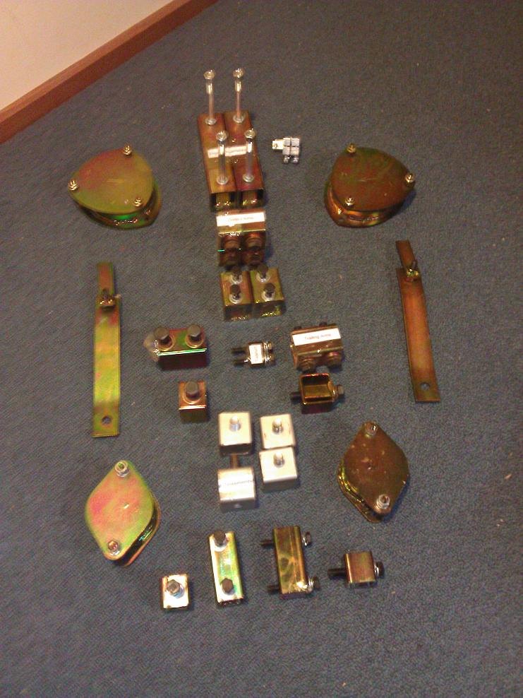

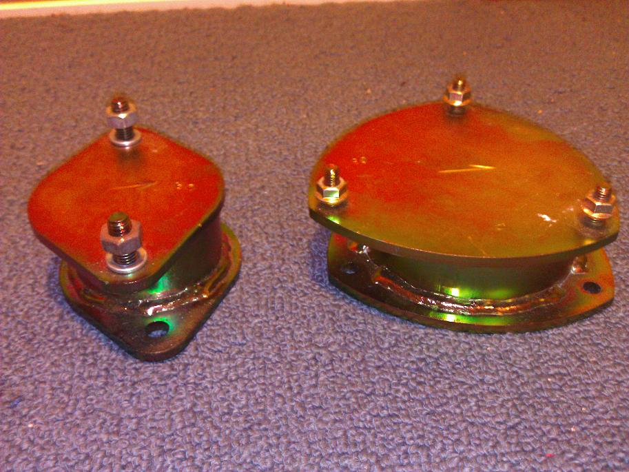

Could you please post some photos? One of the whole kit plus a closeup or 2 of the strut top spacers.

Here are a few pics of the kit.
Everything looks very well made.

The kit looks good.
Davidov is right, it will give you extra clearance under the body & part of the exhaust but not the driveline. Raised springs (HD springs) will give you about 30-40mm extra lift under everything incl driveline. It will be slightly harsher but not much & will give you better handling onroad but will slightly reduce wheel travel offroad.

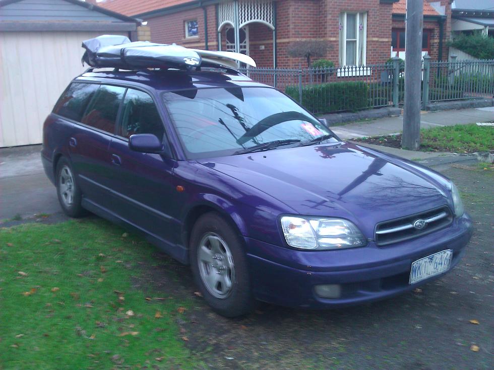

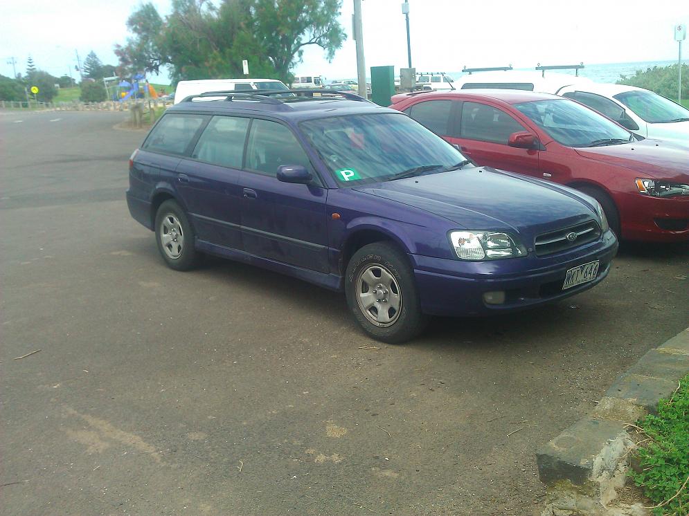

Here is a pic of the car as well as an older one with the forester wheels for comparison. I will eventually get round to putting a thread up in the my car section with some more pics. :)

The first pic is the one with the lift. haha
Post by Alex » Tue Nov 29, 2011 10:04 am
i like it.
it would look blinging with some nice rims :)
try for some outback struts and springs to get her that smidge higher off the ground.
