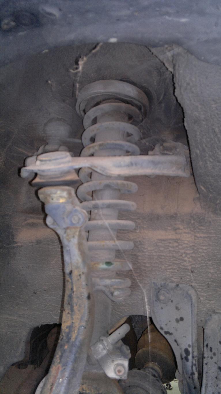

are these the right honda springs for the back of my L?

The model needs to be something like 87 to maybe 93-94... The strut should look like this when its taken out. If you're at a wreckers with some L's there take your spring compressors with you and build up an L series strut in the yard - this is what I did when I got mine.
Stock L on the left, stock honda on the right.
L strut with honda sping mounted, L series spring, stock honda strut.
Hope this helps.

not possible bennie, all the l rears are gone. That pic is of an accord, but right next to it was a 70's civic with the same springs. All the other hondas there had torsion bars on the front

You need the springs from this series of Honda - prelude, civic, accord to name a few will have the same springs - dunno about the ratings between the models though. This is a prelude:
guyph_01 wrote:If you are after new ones, the King spring part number is KHFS-58:)
AndrewT wrote:old springs might be worn out and not that much better anyway.
Brand newies are not that expensive.
Why bother with new springs - they'll be over priced for sure! I'm certain that a used set of front springs from these vehicles are all that is needed. Even if there's a little bit of sag from age it will still be a marked improvement over the factory L or aftermarket replacements in height and load carrying capacity, these springs were originally intended to carry the weight of the engine and gearbox, I'm sure the L's rear end isn't anywhere near this heavy! Plus I paid $40 for springs and struts TOTAL. Cheap and an awesome mod!
To answer your initial question theLman - yes this spring pictured (stole yours :twisted:) is the one you're after!

El_Freddo wrote:You need the springs from this series of Honda - prelude, civic, accord to name a few will have the same springs - dunno about the ratings between the models though. This is a prelude:
