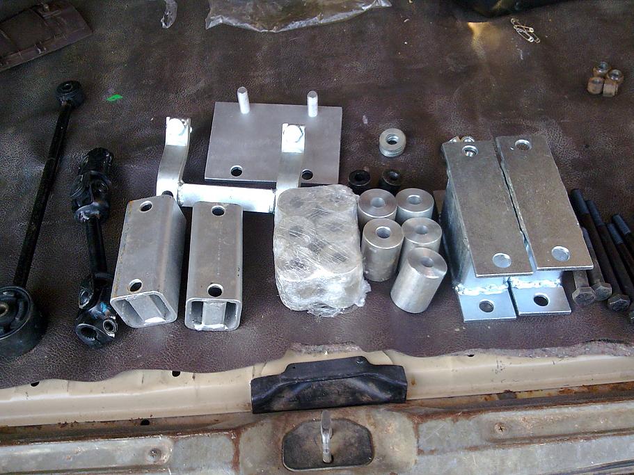

please see attached picture and tell me if its the right kit..
thanks guys

where are your strut tops???

brumbybear wrote:where are your strut tops???
ive got them. just not in the photo.

Looks like the 3" BYB kit i sold on ebay. If it is then it should fit. The lift kit was made for an L series with power steering rack. If you have a manual steering rack then the steering extension won't be the right size, but everything else should be ok.

Venom wrote:Looks like the 3" BYB kit i sold on ebay. If it is then it should fit. The lift kit was made for an L series with power steering rack. If you have a manual steering rack then the steering extension won't be the right size, but everything else should be ok.
yeah thats where i got it so guess its yours! small world ;)
well i was looking around and and can see where most things are going to fit in, apart from the solid metal plate bit. and the two small black bushes..
any help would be appreciated.

the boy from tas wrote: well i was looking around and and can see where most things are going to fit in, apart from the solid metal plate bit. and the two small black bushes..
The Metal Plate goes between the diff and the diff carrier to space the diff down.
The two 1" black blocks go under the tailshaft center bearing mounts.
