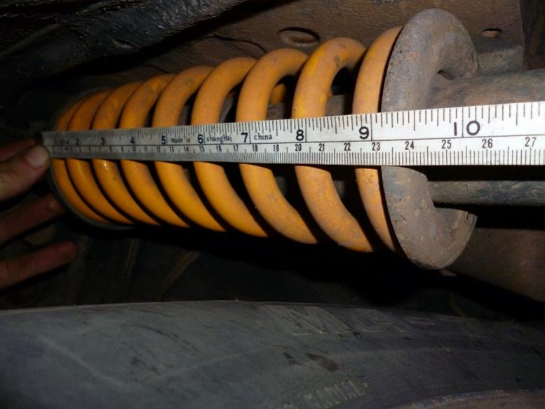

Can you do me a favour and measure the compressed length of your new Kings like I have in the above photo? A photo like above would be a bonus also.
on a slight slope.
225mm short side, 235mm high side.

[ATTACH]3437[/ATTACH]
Edit: I should also mention the front is on slightly higher ground, so i think that will be slightly more compressed than actual.

Awesome photo, thankyou.
Quite a bit shorter than I was expecting, I wonder what the weight difference is between the rear of a sedan and a wagon?
So were you holding the start of the tape on the top of the top spring seat, or just below it?
Ah see I measured differently. But it appears that there is about 10mm in each end, so that makes yours about 250mm, which makes it pretty similar to mine.

I hope Nev doesnt mind, but this is a photo he sent me of an 11mm thick sedan King coil in its compressed state in his Vortex. Looks to be around the 200mm mark, but with a much higher spring rate than the standard RX spring, 245lb vs 180lb.
