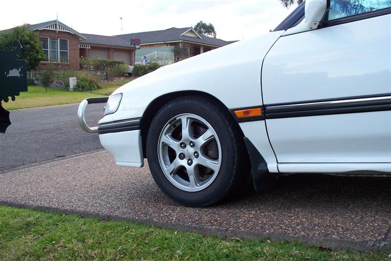

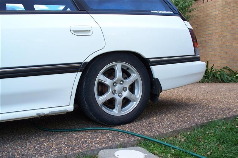

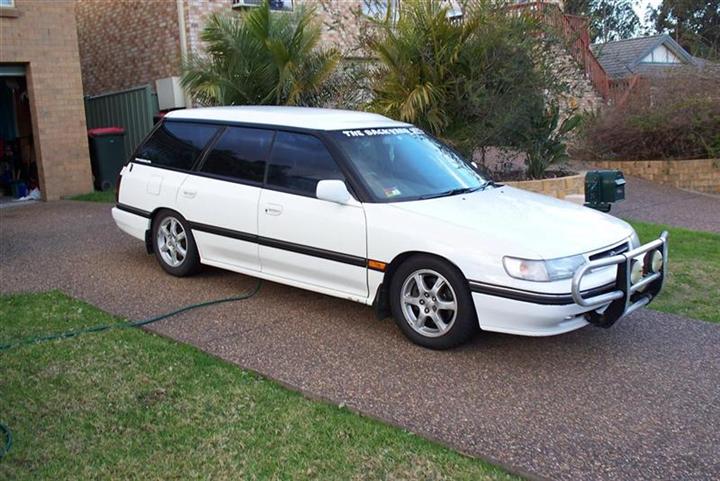

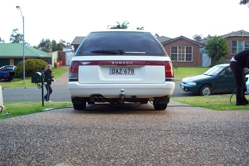

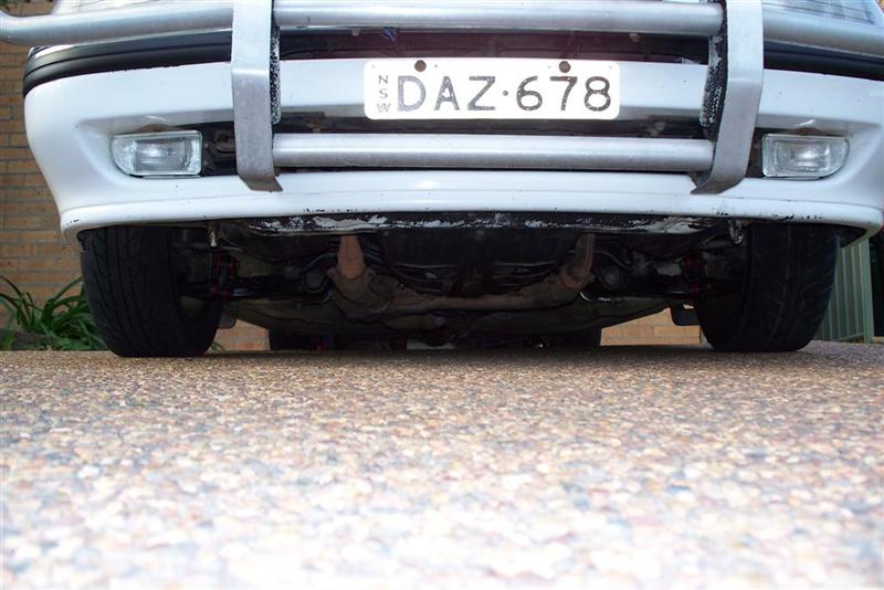

Here's some pics of mine when there was almost no air left in the struts:
Not much daylight here, and no-go for trolley jacks:
[ATTACH]1193[/ATTACH]
No fingers will fit between tyre and guard:
[ATTACH]1194[/ATTACH]
Hmm, fronts are surprisingly high, must be some air left:
[ATTACH]1195[/ATTACH]
Fully Sik(sic) lowered Lib
[ATTACH]1196[/ATTACH]
Scrapes going into and out of my driveway :( :
[ATTACH]1198[/ATTACH]
