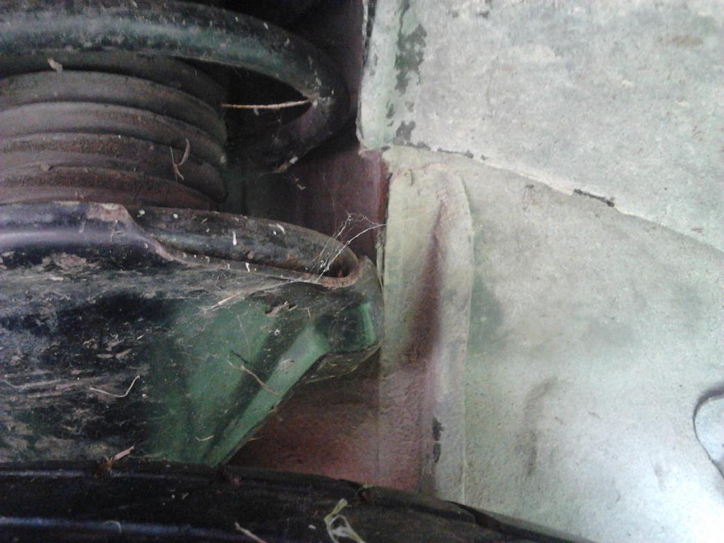

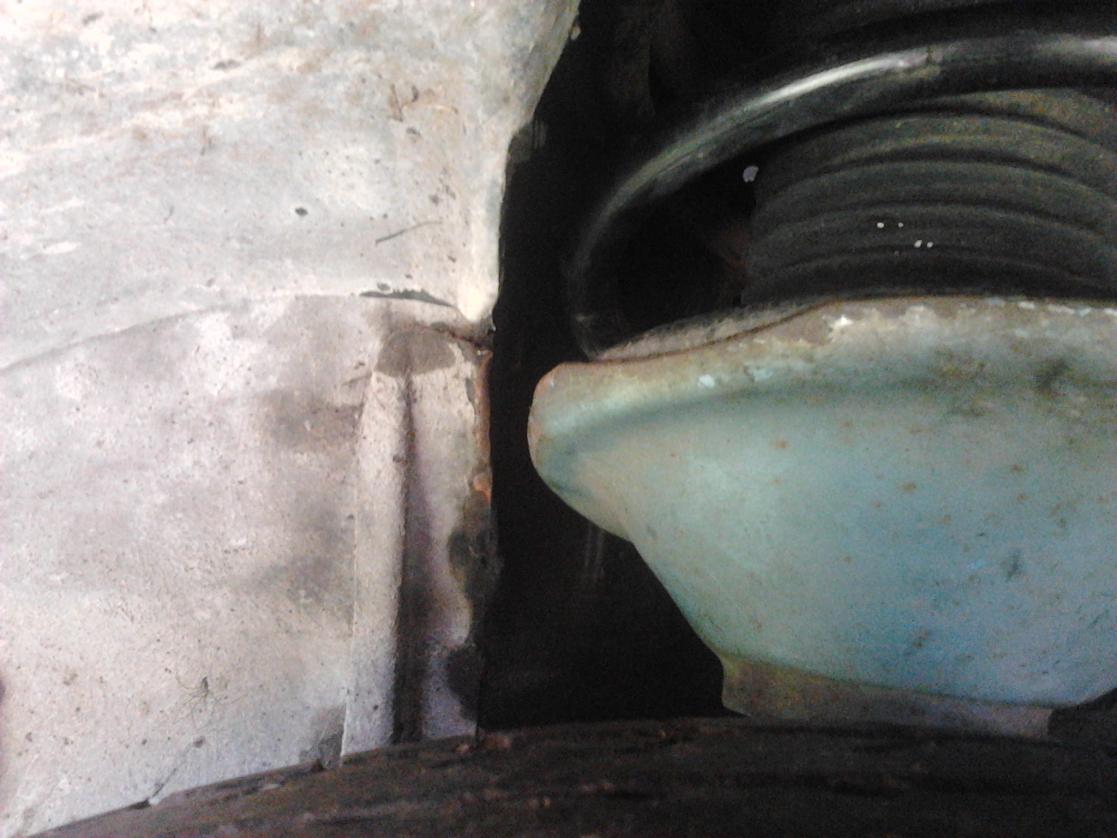

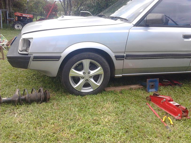

Post by Gannon » Sat Mar 08, 2014 7:37 pm
Here is the liberty strut on the drivers side, see how the lower perch interferes with the wheel arch/strut tower edge
Here is the blue KYB from a WRX that has the same spring diameter, but it offset different and thus does not interfere
How the front sits with the WRX strut in the passenger side
