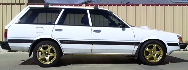

I have an L series wagon, just put the crossbred kit in it along with wrx front struts and springs. The rear has standard shocks and springs, the front is lower than the back by a fair margin. Can I just put the 2" spacers from a lift kit under the towers to even out the stance or do i have to put the whole front end lift kit in there as well? I'll have a pic up this arvo to show you what is happening. Cheers:D

Just the strut top spacers will be fine.
You may need special ones to set the camber where you want it?
But the wrx hub does have adjustable camber so you should be ok as long as you are within the limits.

Picture up in 1st post!!:D
Post by Alex » Mon Aug 23, 2010 1:18 pm
1. that car is uber friggin awesomely sexy.
2. yes you can chuck the spacers in, but it will increase your cv angle causing premature destruction.

So would be better of with the whole front lift kit in and maybe leave out the rear?
I have some lowered rear springs, might just throw them in again for now, looks super sexy down low all the way round!:mrgreen:
Post by AndrewT » Mon Aug 23, 2010 1:44 pm
If it's a road car I'd be tackling the problem by lowering the rear.

if you want to lift the front a 2" lift looks like it would be too much. The lift from some forester or outback struts would be about right.

Yeah Deano.. Low is the go :cool: Put those rears in and post up another pics. I have some spare rears if you want to have some as standards and some as lows? then it's just an easy swap out.. can do the same for the fronts with some Forry struts too (just f**ks up your alignment but mark the adjusting bolts with paint and you'll be close enough) for when you take off the black top :)

Alright, alright! I'll lower it !!!!!

Will be lowered tommorrow, had to do some husbandly things today!

Have fitted the lower springs to the back end, didn't lower it as much as i was hoping:( anyway pretty happy with it for now!
