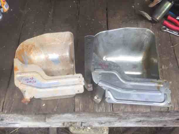

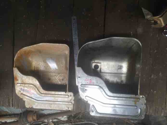

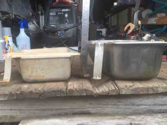

So in trying to convert my brumby to ej power, current thinking is to install better baffles / fuel pump sump into the my tank. I'm doing this because I have all the parts laying around rather than making / buying an external fuel surge tank.
The baffle / sump around the fuel pump pickup are slightly different / bigger
[ATTACH]4605[/ATTACH]
[ATTACH]4606[/ATTACH]
[ATTACH]4607[/ATTACH]

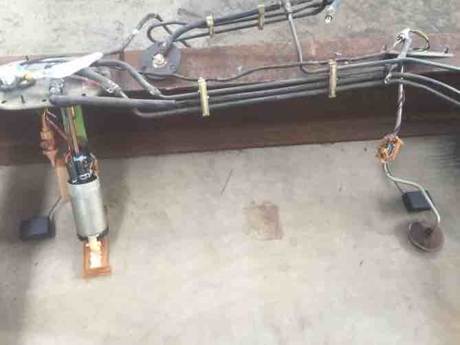

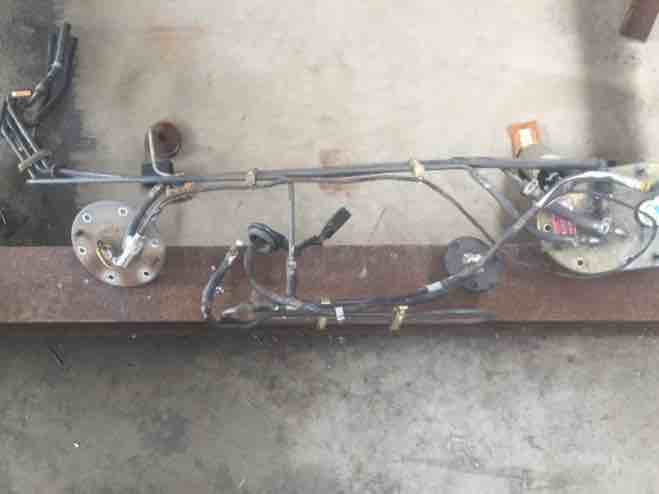

Breather system & siphon is slightly different also
Gc8 98 Wrx
[ATTACH]4608[/ATTACH]
[ATTACH]4609[/ATTACH]

Post by stenno » Fri Jun 12, 2015 10:46 am
G1 s1 liberty gx
