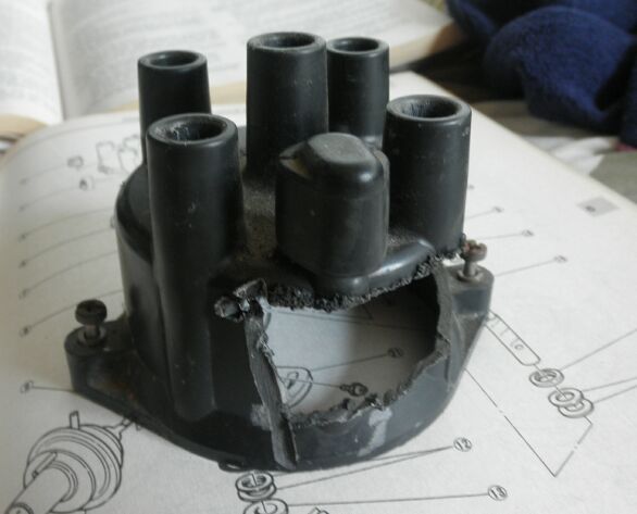

I bought a distributor cap 3 years ago, and only just realised today that it sits a bit taller than the original and therefor the rotor rotates beneath the spark plug connection points instead of between them (which explains why I could never tune/time the car ..... I assumed that it is an old car and that it will always going to run rough).

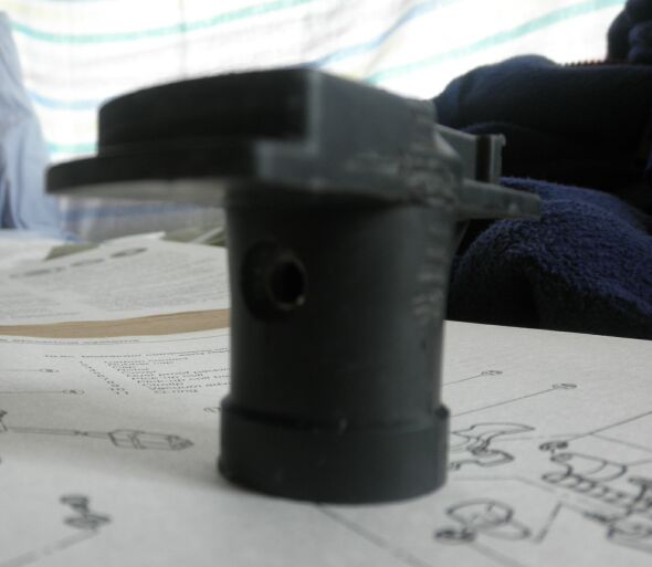

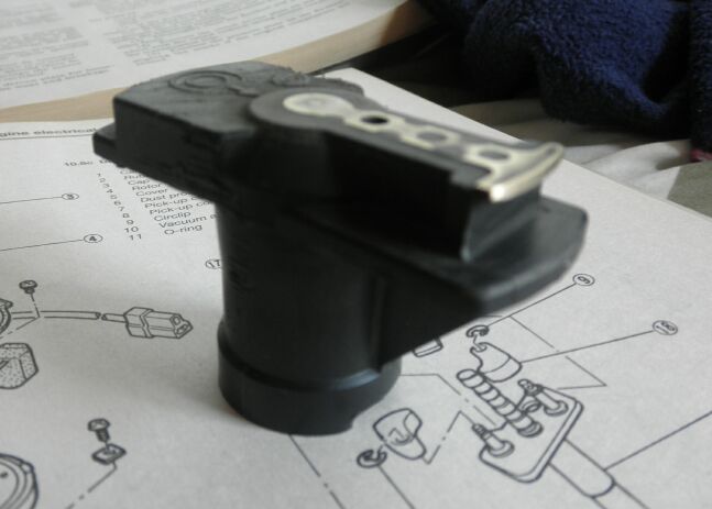

The first 2 attached photo show the original Hitachi distributor rotor - note this rotor screws into the rotor shaft, hence the hole in the side of the rotor button.

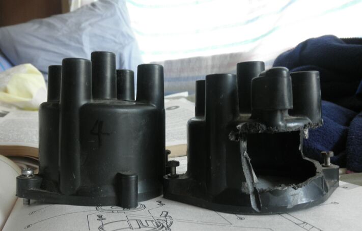

The third photo shows the original distributor cap - it was worn, and not knowing that it would be difficult to buy a new one, I cut the side out of it when I manually setting the timing (without the use of a timing light) after changing the timing belts.
The fourth photo shows the old distributor and the one that I bought 3yrs ago - note how much taller the newer distributor cap is compared to the original.

Cap on the left looks like GH623, one on the right minus the hole (story there?) looks like GH617. Been looking at the dizzy out of my NOV86 make date L Touring Wagon carby - looks different under the cap and rotor - plastic covers over things not same as 85/86 EA82T nor 87/88 EA82T both efi

Littlewhiteute (Gary) - The distributor cap on ebay looks like the taller version of the two versions that are held down with two screws (the version that I have which is too tall for my car). The Ebay distributor has a small breather at its base (as shown in the centre of the photo), where as the original that I'm after does not have this breather at the base. The Repco part number for the taller distributor cap is GH609-C (not sure what the brand this is...Fuelmiser prehaps). Out of interest - it also has a "Made in Italy stamp" on the inner side of the cap.
