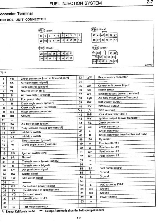

gday, has any one got a link to a 4 plug ecu pin out for a ea82t. just finished conversion on brumby and have no spark. Ive searched on here but all i can find is the 3 plug pin out. any help would be much appreciated. thanks

Post by T'subaru » Tue Apr 13, 2010 9:31 pm
[ATTACH]1987[/ATTACH]
from '89 fsm
good luck
89 ecu pin outs.jpg (99.05 KiB) Viewed 2595 times
