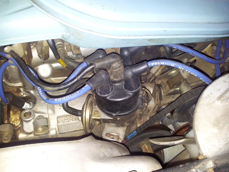

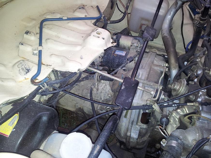

Got a couple of questions as i still havent started my car since remove/replace the distributer.
where is that small square at the rear of the engine? In the pic attached i can clearly see the marks on the flywheel, but the above mentioned i cant even see. Some people are saying its covered by some rubber?

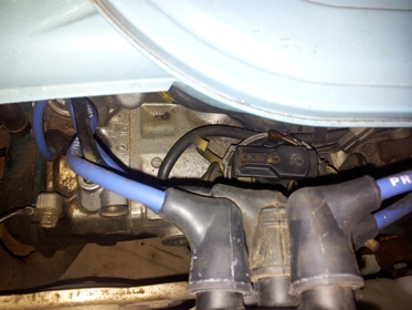

Also, have i put the leads back on the dizzy in the right order? Some dizzys come with numbers on them, what would the numbers be on mine?
And the Rotor in the dizzy should be facing spark plug 1, which side of the rotor is it. Is it like in my attached pic?

Tweety
Posts: 1253
Post by Tweety » Sat Feb 04, 2012 8:59 am
I'm no mechanic...just a guru for tinkering.
There are some things Bungers that you will need to learn the hard way. Like taking a few minutes to label items like plug leads. Saves you a lot of heartache. I never take more than one lead off at a time.
I've never seen numbers on a dizzy.
Get a manual. Read up in boks about the basics of the internal combustion engine. You need a mentor that can spend say an hour physically with you to answer your questions. It would be hard otherwise.
Post by steptoe » Sat Feb 04, 2012 9:22 am
Bungers, the square you refer to is the hole you must be looking through to be able to see the timing marks on the flywheel - the hole left the factory with a black rubber bung plug, no pun !!
Search in here can be good, can be tricky, but YOU need to get #1 cylinder number is in the block casting, on TDC 0 for the compression stroke top. For this, easy with all spark plugs out, shove rubber hose into number one for tight fit - you choose hose. I then have cut off a finger of a rubber glove and sealed to top of hose prior to getting to #1 TDC and watch finger inflate as turn engine clockwise? I think - the compression stroke air fills finger.
THEN , I think you shift fly a smidge to 8 DBTDC mark, align dizzy drive cog dot mark with cut mark of alloy dizzy housing , than drop dizzy in with vac advance unit in good spot.
SEE how you go.
Also, use the Steptoe ID method with those coloured zip cable ties and always mark both ends of lead#1 with red, #2 with blue, #3 green #4 yellow , you'll see my pattern of more letters in the colour name as the cylinder number increases firing order 1324 I think
