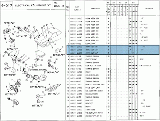

I have attached the Control Equipment page from the AUS. parts catalog.
It appears that the side the wiper parks on is irrelevant due to the fact that 86571GA100 suits models up until Dec. 1986, but RH parking wipers were fitted to models built from Jan. 1986
So It may be a case of 'if it plugs in it will work' and the part number just being a board revision or you may need to get the matching controller to replace yours for an additional reason.
Whats the build date of your car Toonga?
Does your car still have the variable Int. slider under the LH control wing?
I know Int. operation also depends on vehicle speed, is the speed sensor still connected after your EJ engine fitment?
Electrical Equip. XT AUS parts catalog page.gif (28.56 KiB) Viewed 10884 times

Post by TOONGA » Sat Oct 03, 2015 9:45 pm
the built date is October 1987 the compliance plate has an 88 stamped on it.
Yes I have the variable slider it even has the knob still. sadly the dimmer for the dash lights had no knob when I bought the car.
The speed sensor is in the speedo and it is connected to the EJ ECU so that the IACV doesn't throw a code.
