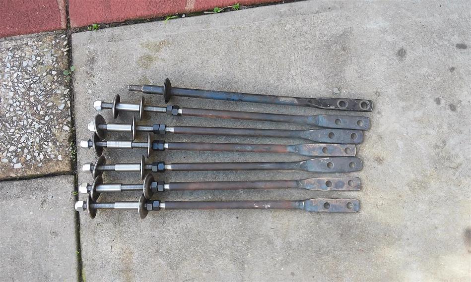

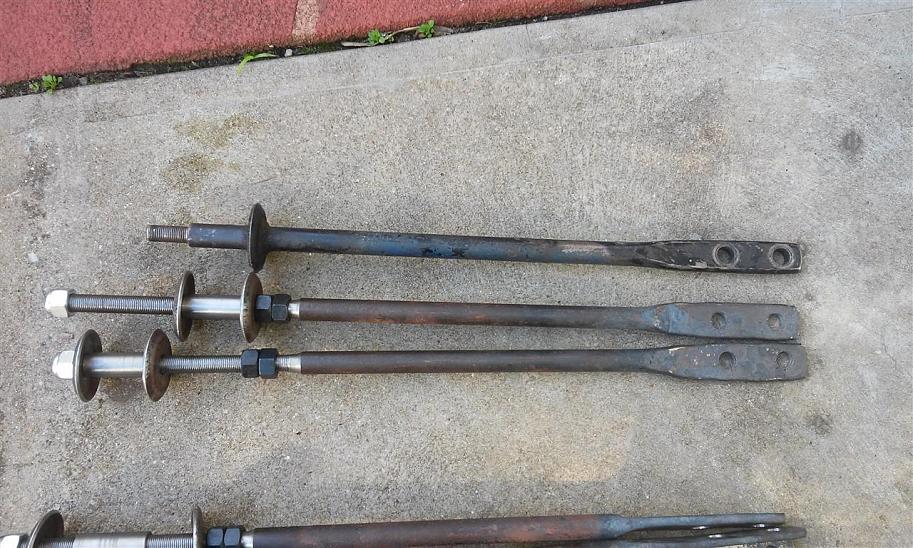

Time for some pics!
Original radius rod included at the top for reference.
You can see the difference in length and adjustability - the original rubber bushings go over the steel sleeve, one bushing each side of the mounting plate in the car. One big washer either side, then the nyloc nut goes on the end. The two locking nuts are for adjustment. As you can see they are made so that the factory length is still possible, as well as up to about 50mm longer. At their shortest length, the extra threaded rod sticking out the back side may cause issues if it hits somewhere else on the car. If this happens it is perfectly OK to trim the threaded section down. If you cut the end, make sure you put a decent chamfer on the edge to clean up the threads. Also as you can see they are not painted at this stage, a simple clean up with a wire brush and a coat of spray paint is all they need.
Also there's no need for concern over the heating of this material having changed their strength; they were cooled slowly by turning off the makeshift furnace they were in and leaving them in there overnight.
Time for some pics!
