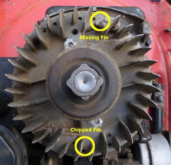

I pulled to top cover off my mower and on the flywheel I found a broken fin and another chipped one. I think this may be contributory to my vibration issue. Think I'll have to try and source a new flywheel. See attached pic.
- flywheel.jpg (51.75 KiB) Viewed 2790 times
