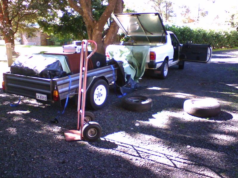

I had my EA82T brumby all loaded to go on a trip out west Queensland for a week and have been looking forward to this for a long time. I've done numerous trips all around south east Qld with no trouble so was quite confident for the car to do the big one. I'm on leave at the moment and was heading from Toowoomba with the plan to travel west to Charleville then out to Windorah and play guitar at the pub there (all arranged). Then up through the middle to Longreach and stay with the brother in law and then pickup the eldest boy and travel back down through the guts to Toowoomba.
Packing to go.

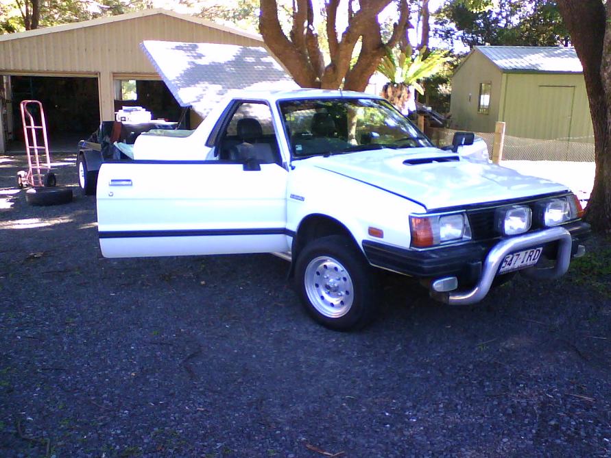

Anyway..thought I would share...will get it back and roll it into the shed and look for the problem although electronics is not my strong point...Oh and I'm off to join RACQ...
The idea was good...
[ATTACH]3460[/ATTACH]
