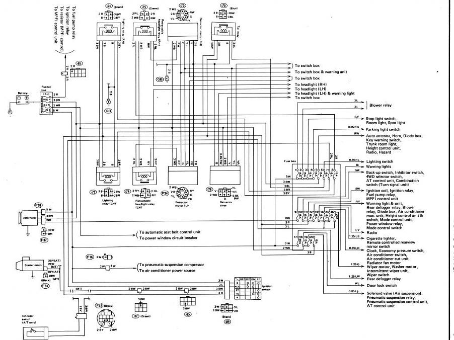

This is from a 88 Vortex, but it should be basically the same
The white wire is fed from the black 1.25 fusible link and then feeds the alternator, the ignition switch and about 1/3 of the fuses in the fuse box.

Thanks Toonga...I'll look at that wire...There are actually a lot of wire ends in that bundle..I think they have been cut off from a previous application (computer or sensors) it now has an EMS stinger ecu.
Gannon...I think you should just be able to access those photos via the link. I am using google drive because I have had so much hassle trying to downsize photos for this forum....and then loosing quality and definition.
Steptoe...Yes I will look at the coil you mentioned,,and see what I can see....
I'm going away for 2 days in the morn in my standard brumby to visit my sister and will get back on this when I get back. Gannon, thanks for the wiring diagram. I have the workshop manual for the EA82T but this looks a little different. I'll check it out. Thanks.
