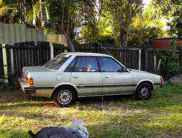

Pictures of my Cars
Beetle will have a EA81 in the next month or so.
The leone we bought at a donar to put the engine and raditor and seats in the BAJA, But when we got it home and checked it it was to good to wreck so I put 2 tyres and got a RWC and regoed it.

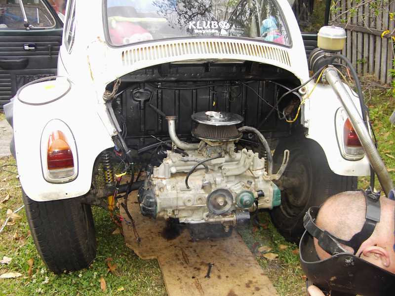

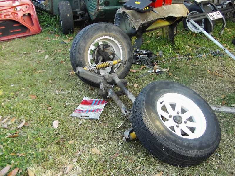

hi
well today we put the subie motor in and had it running for a very short time as we have not fitted the radiator yet YAHOO!!!!!!!.
So next weekend we will be working on the engine cage modifying it so we can fit the radiator and the exhust. we are hoping to have the motor all done in the next three weeks.

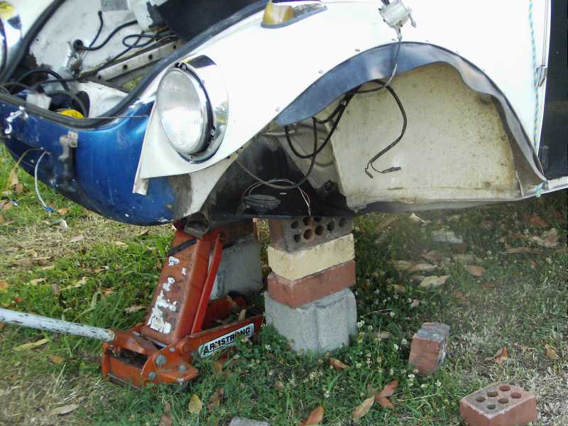

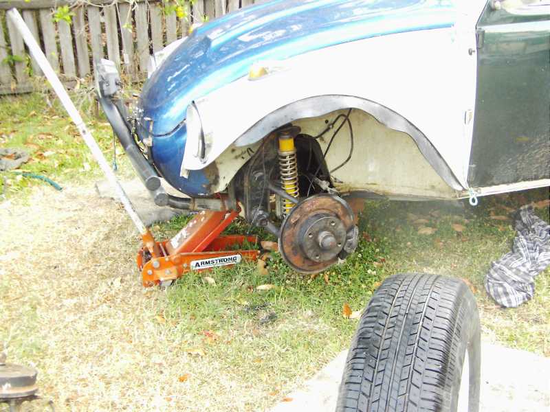

During the week I removed the front beam (Drum Brakes) and replaced it with a disc brake one.
The first picture is the front of the car without the beam
2nd one is the beam on the grass after taking it out
3rd one is the new disc brake beam in the car.
4th one is the subie motor sitting in place
Marc

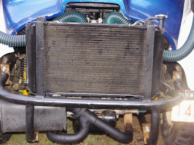

Report on Subie engine transplant
Hi
Well we are 75 % of the way to having it finished, It is up and running with the radiator set up in the temp place until I get the car back from the muffler shop tomorrow, which will lower the muffler below the centre cage mount so next weekend we can finish the cage and mount the raditaor in it's final place and finish wiring up the thermo fans and make a sump bash place to keep the sump safe.
Well after driving the beetle around the local streets oh boy what big difference The old VW now flys .
A bit of details of the engine ,EA81
It has a Tighe 102T cam, it has only done 2000k's since a full rebuild with new heads a weber progressive cabie not sure on the size have not loooked and a good flowing exhust.
It revs out at 7500 redline but stops pulling hard at 6500 .
Will post pictures when it is set up ready to go the the engineers for the blue plate.
By the way the new disc brakes work very well.

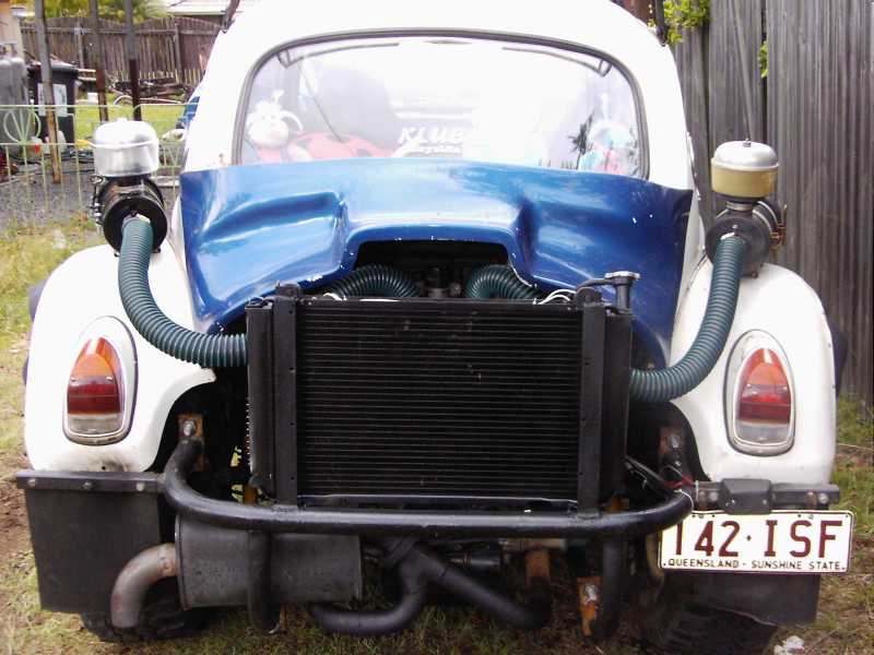

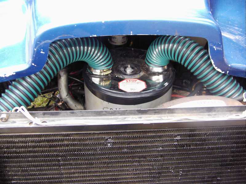

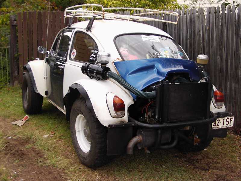

Subie Motor in and running
Hi Peoples

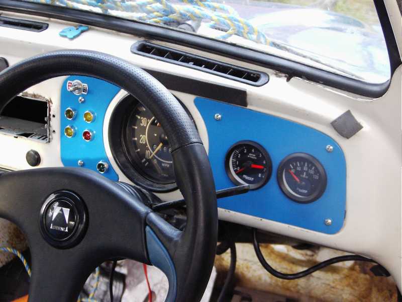

Last weekend weekend we finished the BAJA and we took mit to the Gold Coast VW Show for a run.
everything went well temps were about 95c at 110ks the only trouble I had was that it wanted to go faster than the speed limit
here are a few photo's
Marc
