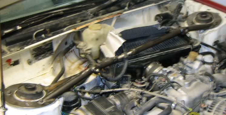

New Chromemolly Strut brace - now painted black
[img][img]http://i5.photobucket.com/albums/y165/T ... brace1.jpg[/img][/img]

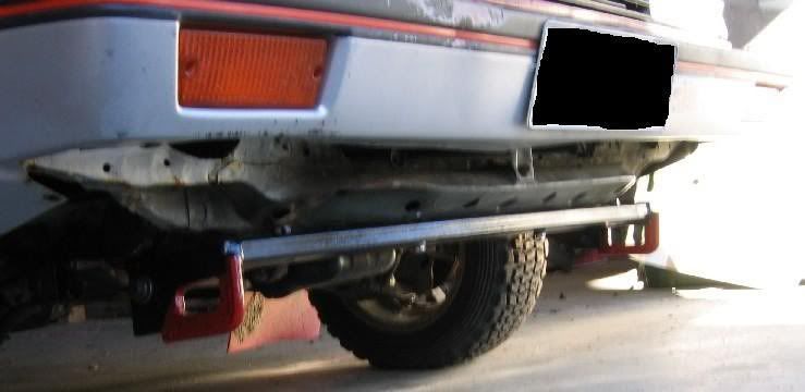

New Sump Guard mounting bar, bolts to old tow points and to standard sump guard mounting holes in front.
[img][img]http://i5.photobucket.com/albums/y165/T ... ember1.jpg[/img]

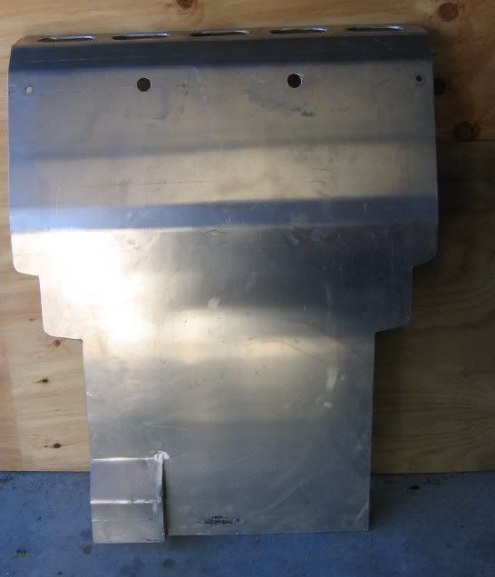

New alloy sump guard :D

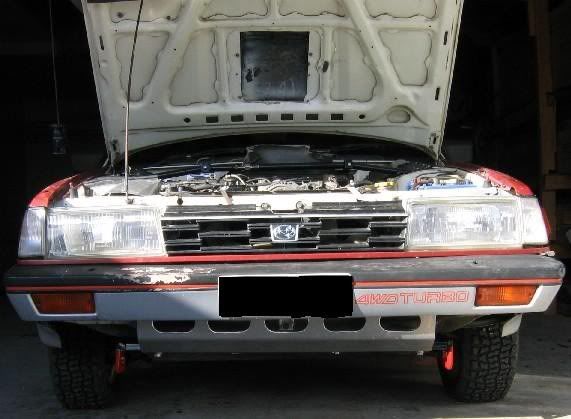

[img][img]http://i5.photobucket.com/albums/y165/T ... sumpg1.jpg[/img][/img]
Sump guard fitted
[img][img]http://i5.photobucket.com/albums/y165/T ... sumpg2.jpg[/img][/img][/img]
Strut brace is designed for a different TMIC from a TTLegacy so will not block the air flow when it is fitted.

I like the front sump guard, tell us more about it. Is it a custom job, looks nice. My 3" lifted L could really benifit from one of those!

The Sump guard is all a custom job. I built the crossmember which is 1"x2" 3.0mm RHS with 10mm steel plates on each end. The plates bolt to the old tow eyes and have a new toe eye cut in the front with a piece of 10mm bar welded along the edge to add strength.
The crossmember is also bolted to the two standard mounting holes near the middle of the bar (you can see the bolt heads). Also if you look at the sump guard the two larger holes in the middle are to accomodate the washers and bolt heads from this mounting.
The sumpguard is a high density alloy (not sure on the grade/but expensive!) custom cut and bent with a leading edge "bump" for the exhaust built in. The front bolts onto the new crossmember and the rear slips into a "shelf" of steel welded to the gbox crossmember.
