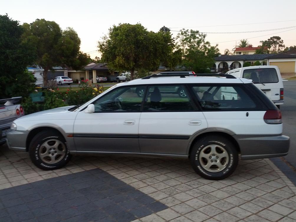

So i bought another subbie... ( i have 4 in the backyard :S )
This time i got an outback, specifically Will's Turbo outback.
Cleaned her up, added my Tyres/New Liberty seats.
Currently running no thermostat just so i can drive it and not overheat :P.
I have another engine i put in just gota find time ( or replace head gaskets ).
Planning on getting KYB Gen 2 forester struts and King Raised springs.
Also need a purple lable turbo AFM ( 3 plug ) if anyone has one ????

Post by jayrod » Fri Dec 13, 2013 5:41 pm
Radiator looks quite new, ( doesnt really tell you the insides)
Though when i flushed the system the heater core seemed to be pretty blocked up/ or air locked.

Post by jayrod » Thu Jan 09, 2014 4:45 pm
Ok Update
Put a gearbox i had out the back in, so we now have a complete set of working gears.
Bought some Forester Gen Struts/Springs second hand today.
Will put those in prob tonight or tomorrow.
Will be getting 1" or 2" strut spacers aswell at some stage.
Aswell as some Raised King springs.
I was going to get KYB new struts, but realized i needed the Tophats/front perch anyway from the Forester, so i decided to just get some second hand ones and save some money.
Also stalling engine has stopped after i cleaned the AFM again with electrical cleaner.
Hasnt stalled in weeks.
Would like Front/Rear bar, but sooooo expensiveeeee!!!!

Post by jayrod » Sat Jan 11, 2014 9:26 pm
Update
Put some 2006 forester Struts/springs in.
Possibly raised it about half an inch, but my god is the ride better, the stiffer springs are wayyyy better, and i think my old outback struts were on there way out ( bouncy)
I will Def be getting a 2inch lift + King raised springs at some stage.
Going out to two rocks tomorrow, will see how it handles the hot fine sand.
