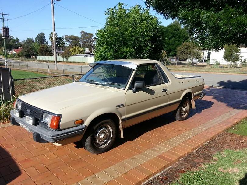

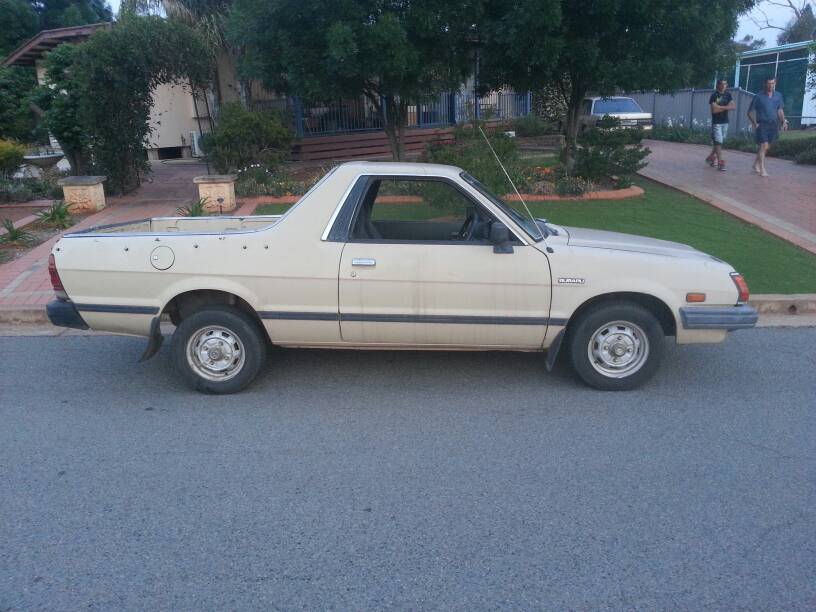

Hi I'm Stretch and this is my 85 brumby.
It was fairly tidy when u bought it, just needed a really good wash. [ATTACH]3933[/ATTACH]

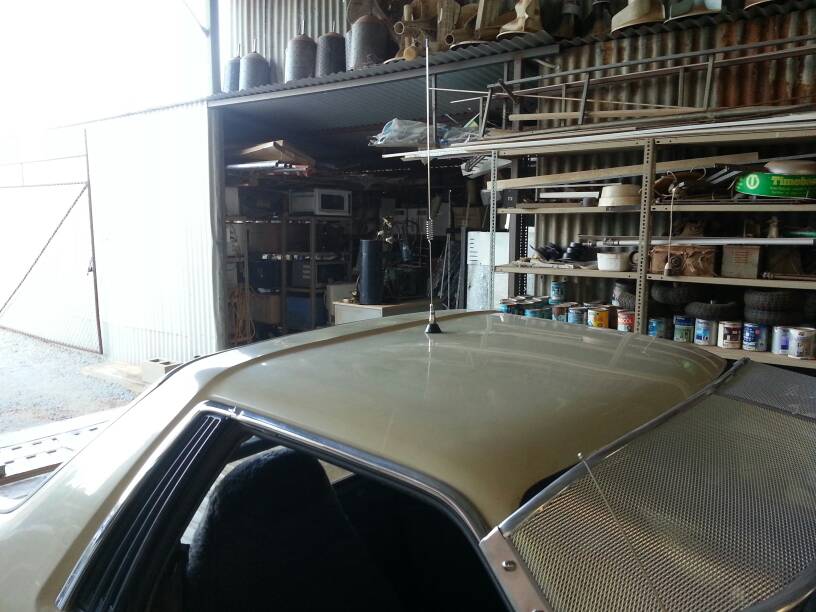

In the few months I've owned it I added a sun visor and uhf roof mount antenna. ( due to it already having a hole in the roof)

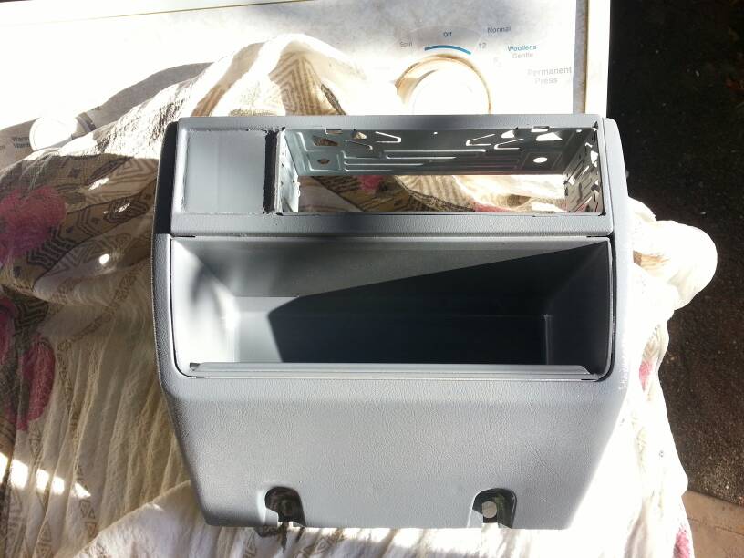

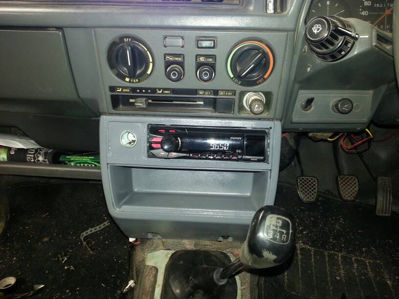

I made a custom fascia for a head unit and amped some 6 inch speakers behind the seats.

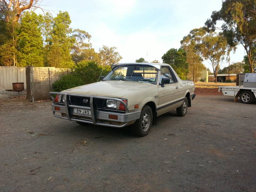

And the latest was a bullbar i picked up a few weeks back. Just need to sort out some mounts so i can fit my driving lights again.

i really like the stereo fascia you made looks very tidy and 'original'

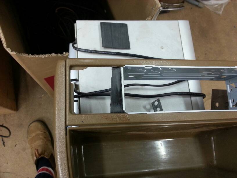

Yeah I was extremely happy with the stereo. Normally I wont mess with the stock look, but AM radio was killing me.
Ive got a few other pics of how it came together.

Another lovely Beige Brumby.
Welcome to the forum!
Looks nice and clean being sans stickers.
I like the roof mounted aerial and sun visor!

Is it normal for the brumby to have a nose down stance or are my front springs shagged?
Sent from my GT-I9305 using Tapatalk 2
Maybe they're both shagged?
You could wind out the adjustable rear suspension to level it out more? I have mine slightly wound up as I usually have something heavy in the back.

What's normal? They could be shagged but my guess would be the rear suspension is wound up and the front isn't. You can wind up both front and rear on these models. Up for 4WDing and down for everyday driving to work. Most people just leave them wound up but this does put more stress on the CV Joints.Stretchomatic wrote:Is it normal for the brumby to have a nose down stance or are my front springs shagged?
