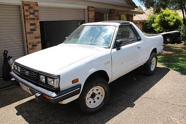

I found it on Gumtree after searching around Melbourne for a brumby, then searched Victoria and thought "I'll just see what's around Australia" and found a '86 Brumby in Ipswich, Targa roof, 2 inch body lift and 27" tires.

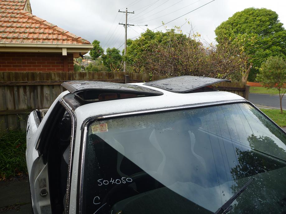

Attached a couple of teaser pics :) (Bennie posted a few more in the "what did you do to improve your suby" thread)

thunder039
Posts: 998
Location: victoria AUS
Post by thunder039 » Sun Jun 10, 2012 9:04 pm
love thr roof! wish mine had thoes

AshR
Posts: 170
Location: Mont Albert North
Post by AshR » Sun Jun 10, 2012 9:23 pm
You could always buy a Targa Brumby and shift your parts to that one :p
