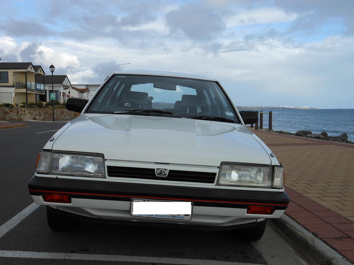

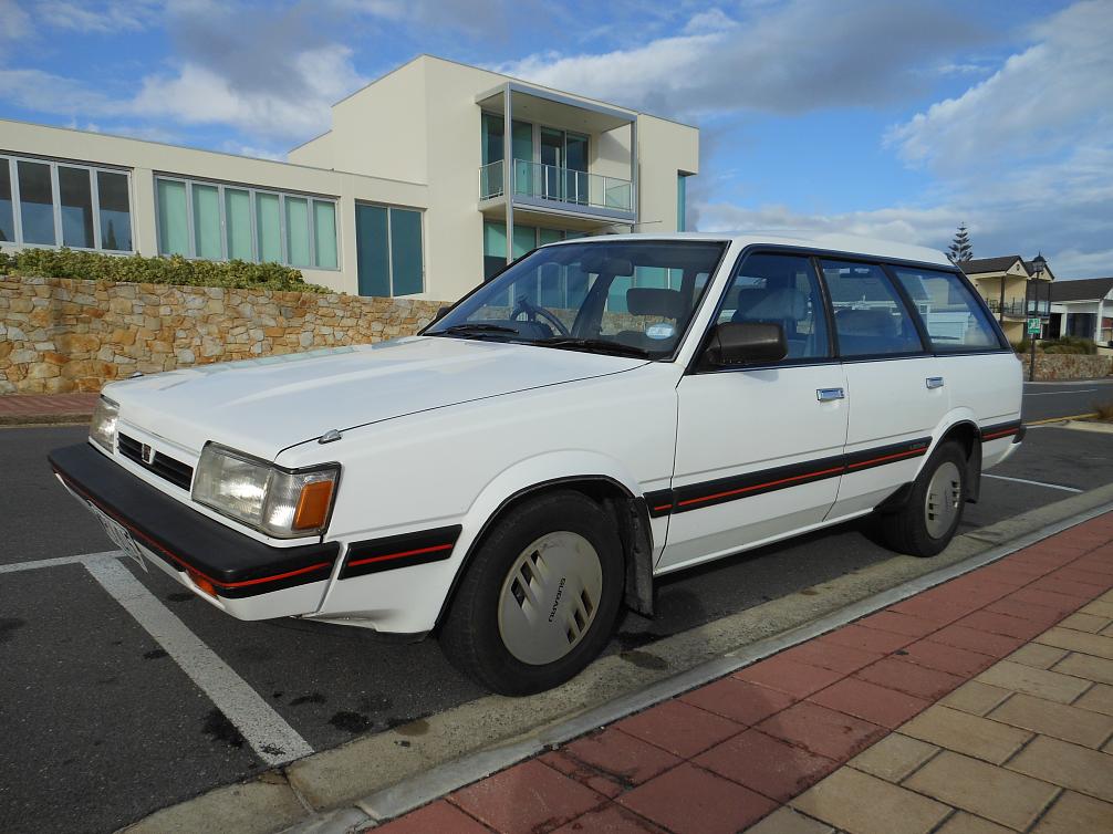

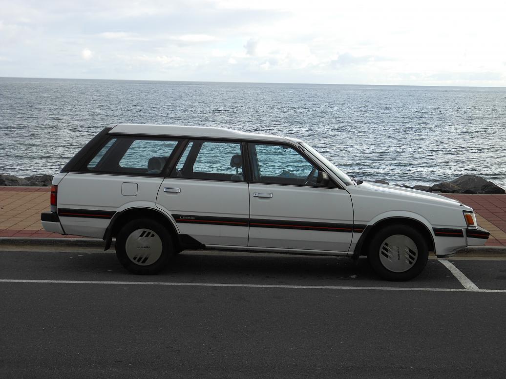

Hi all, bought this wagon just a week ago and finally have had a chance to post some pictures. Its my daily driver and is smooth and clean.
Righto have a look, Ill be on a little later after work to tell the history as I know it and also to gleam some info from the knowledgeable ones ;)

damn that's a tidy wagon. where did you find that?

Nice wagon, so I'm guessing its an import. Does the VIN number start with JF1AK5 or just AK5
JF1 would mean it was sold new in Australian from Subaru, AC/AN/AK means it was imported privately from Japan

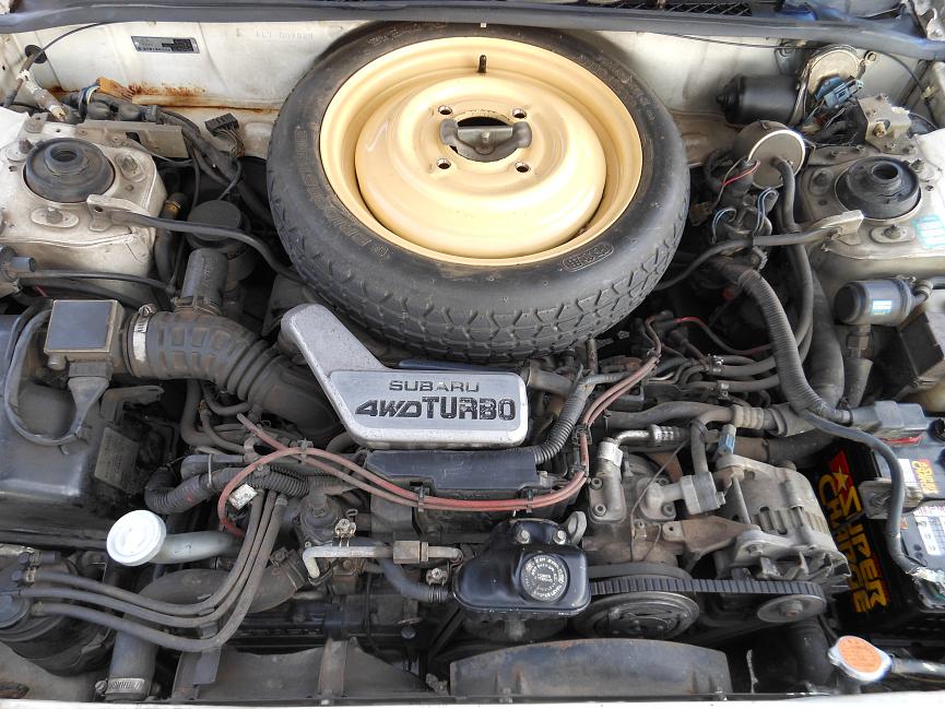

Are you sure its an 86, that engine has a hotwire air flow meter and the interior and front grill is of the later series 2 type, which suggester that it was made after July 1987.
Still a nice example of a genuine GT wagon
Post by steptoe » Sat May 26, 2012 6:40 pm

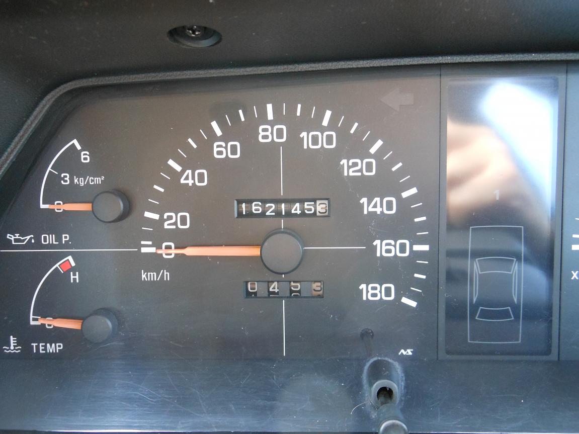

private or grey import by the tits on the front guards and everything else, being turbo wagon, Touring Wagon at that. Like the oil pressure guage, soft yellow butter cutter spare, spats or deflectors we should call them......
Real nice sleeper hubcaps - same as my GLTA has on - from 86 built TW
3 speed part time 4WD ? or E4AT 4 speeder AWD ?

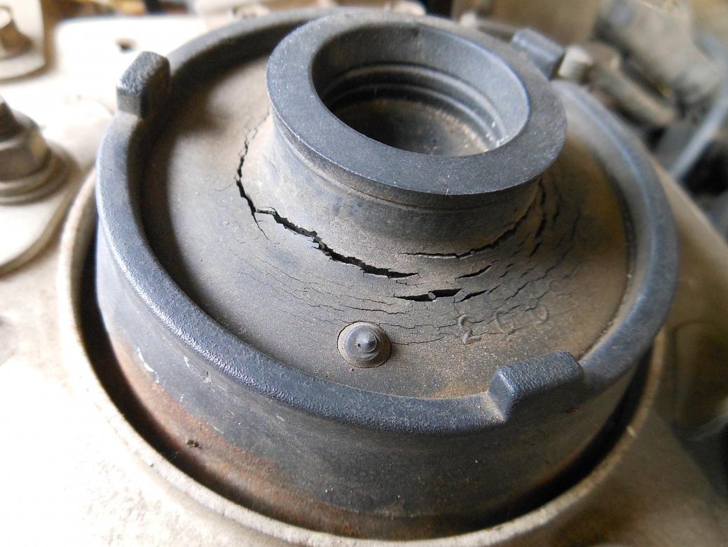

Things that I need to look at doing, exhaust is the original and rusting out, leak from trans/diff up front somewhere, needs new tires ( I actually bought 13 inch sunraysia rims from username) today so I will probably fit them with new rubber in a couple of months when I hit the wear indicators on current tread. And lastly the front strut mounts are cracking so will look at getting replacements at some stage.

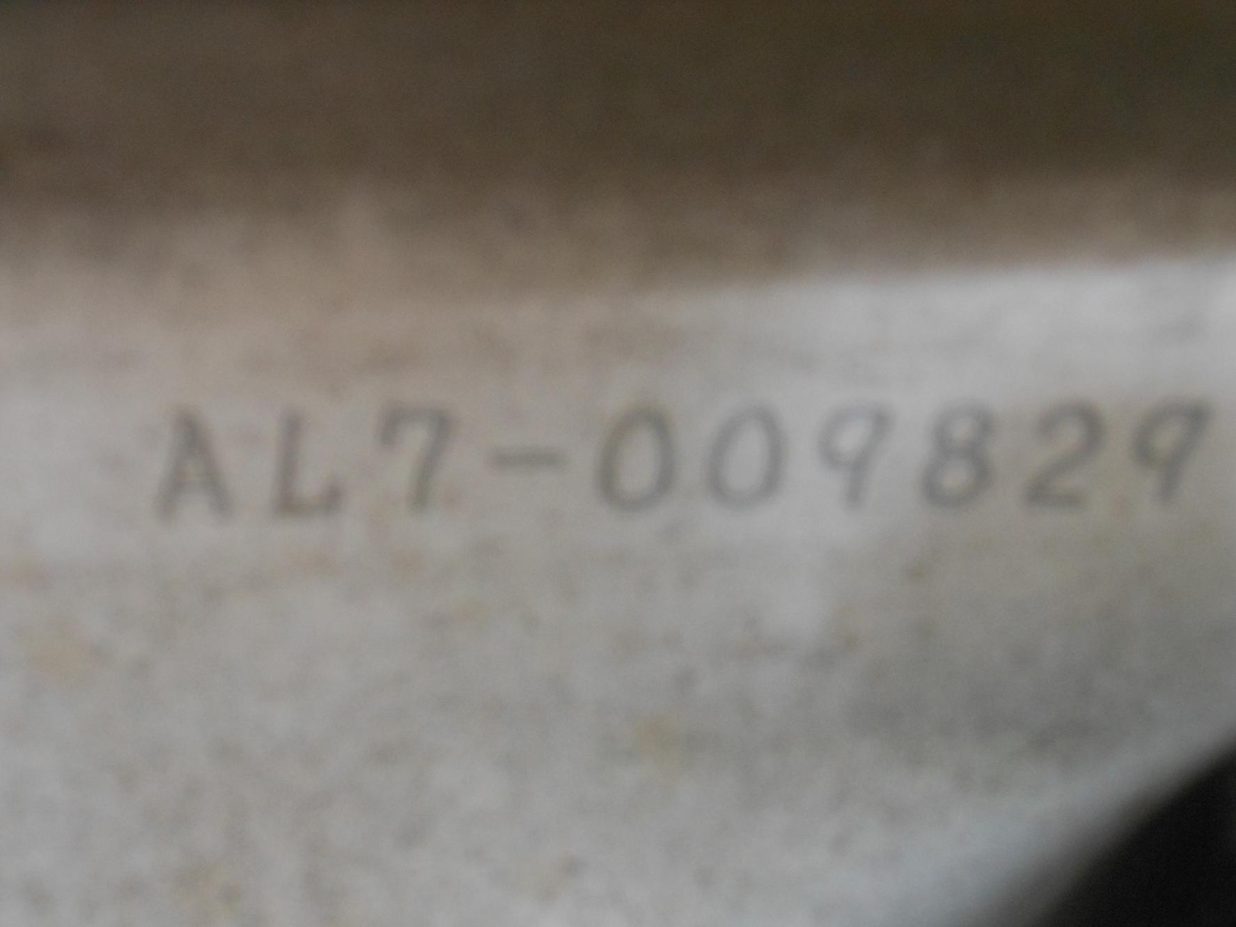

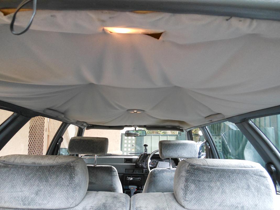

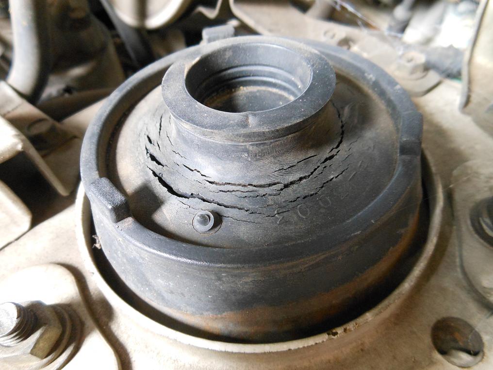

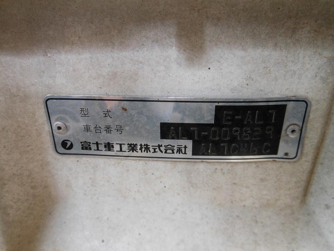

Hers a couple more photos. Numbers from the engine bay for someone to explain :roll:, and the hood-lining that I need to replace along with the front strut tops. Would be great is someone could point me in the right direction for those strut top replacements.

Well, no deluxe air bag suspension in this baby ! Gravity ain't a favourite thing of mine to work against with the hood lining - sort of needs careful removal for starters - maybe advice of a trimmer before you even touch it.
We still need a Japanese member for translation purposes eh ?

Hi Steptoe, thanks for the interest. Have you tried taking out the hood-lining ? From what I've read I need a trip to Clarks rubber to get the new backing and then to spotlight to choose the fabric.
I was planning on having a crack at the removal when I get two consecutive days off next month. Slow steady, my only concern is braking any of the trim.... Might just be easier to get a trimmer to do it ifs on the hard side of things, what do you think ?
What do you suggest with those strut mounts ? Should I replace just that part or perhaps do the whole strut/spring in one go ?

When I see a hood lining like that I see foam sheeting that has seen better days and should still be attached to the fabric. A Camry of same era , visions still haunt me, and I was just a bystander watching the guy touch it and become worse.... I also hate the necessary working position for this task. All depends on your abilities and tolerance.
You likely need to assess the whole suspension - if you have passed a safety inspection all well and good, those cracks may not be a concern. A new suspension will always feel great and strut tops are not included when you buy new struts and springs - that is all extra !

On the VIN number, 'A' means its an L series and 'L' means raised roof wagon. I was of the belief that 'K' was the raised roof wagon. I'll find more info after work
