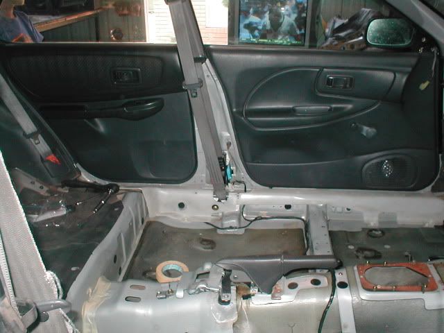

The silver car has been stripped down to a bare shell, not many nuts, bolts, or wiring left on her!

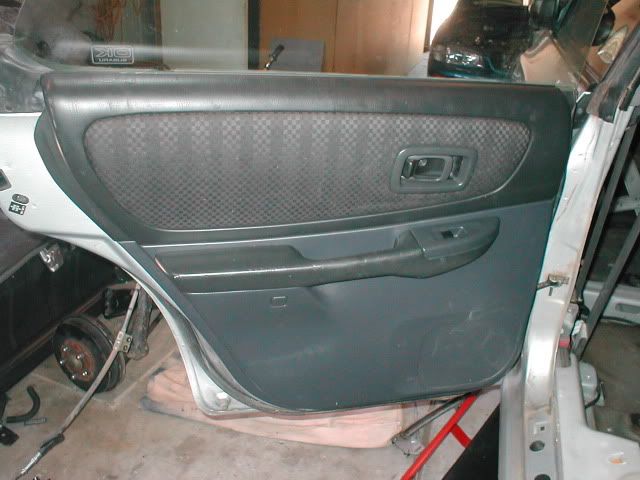

I spent today swapping the power windows, central locking and door locks over to the new car, as the silver one only had manual winders and no central locking, and I will need the newer style door cards when I put the more modern dash in.
Not really very technically hard job, but god I wish I had little Japanese hands.....they would have made quite a fiddly job much easier working inside the door cavity!
It was also interesting getting the power bits out of the two doors that had crash damage, I had to take to them with the grinder and extract everything from the outside.
Interestingly, despite quite a good direct hit on the doors, the components are well placed inside the door, with the internal intrusion bars saving everything.
Shot below of one door completed - rear is with the new power windows, front door is stock manual winders.

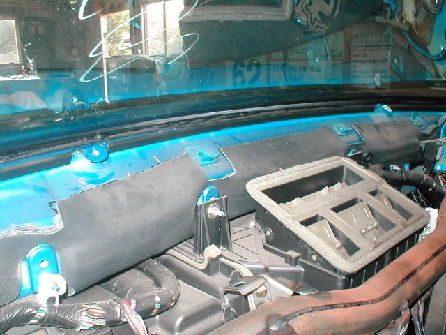

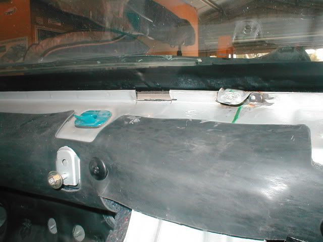

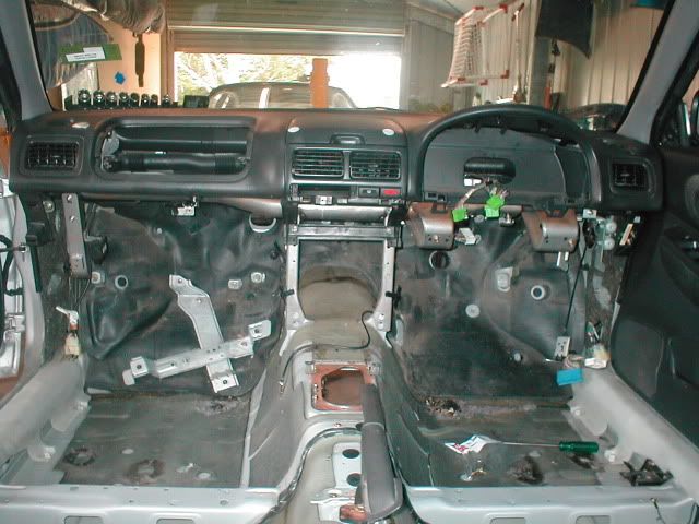

I thought this was going along a bit too easily! I pulled the dash out of the newer car today, and all was going well until I got to this point....

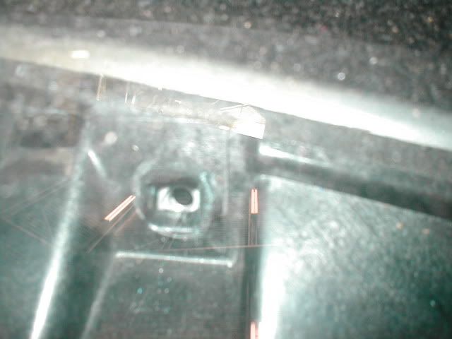

where it appears that the later version of the dash mounts in a very different way to the earlier car. The upper dash mount bolts are in totally different places, as are the 'prongs' that sit on the back of the dash an insert into the little sildes/holes in the firewall.
Whilst I can cut and reweld the captive nuts for the bolts in the correct spot in the older car, I cant do much with the post things/ Do you reckon they carry much of the dash weight?

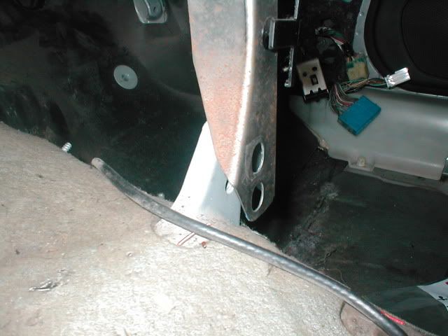

In the shot below you can see the difference in the mounting bolt locations on the newer shell -> the older one has the captive nut where the inner sheet of steel has a cutout in the pic below.
d_generate

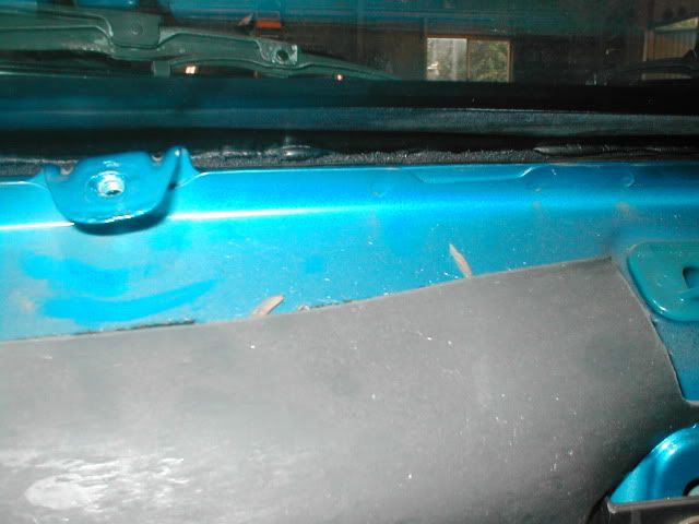

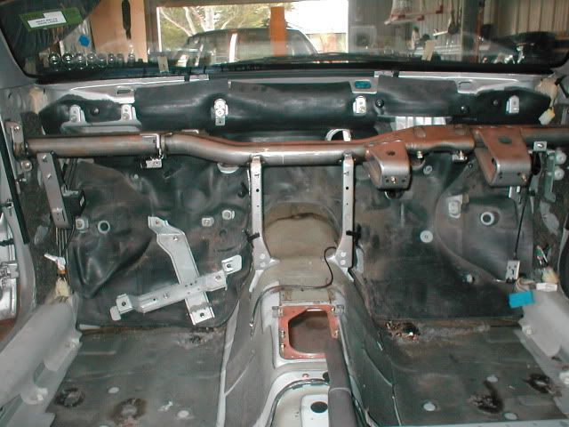

After throwing a few tools and storming out of the garage last night, I went in and had a closer look at it today. The differences between the new style dash and the older shell are as follows;
1) The newer 'dash bar' bolts in fine, but the lower mounts sit around 20mm off the bolt holes on the trans tunnel.
2) The upper bolts for the dash cover are in the wrong place, each needs to be moved.
3) The prong thingys on the back of the dash are in the wrong place, only one of the four holes on the old shell are in the right spot.
#1 -> is easy, I have just elongated the dash bar lower mounting holes slightly, and will use a spacer to fill the gap when I bolt in in.
#2 -> I broke out the grinder and cut the upper dash mounts off, then welded them back on 100mm further out on each side.
#3 -> The newer style dash has two locating 'prongs' on the back of it. The passenger side one needs to be removed from the dash, and the alignment tabs on the three incorrect ones on the shell need to be popped off.
Some pics below. Its all mounted securely now. Happy again!
New dash bar in place;
Dash bar lower mounting feet mis-alignment:
Relocated upper dash skin mount;
Shot of new upper mount now lining up:
New dash is in!!

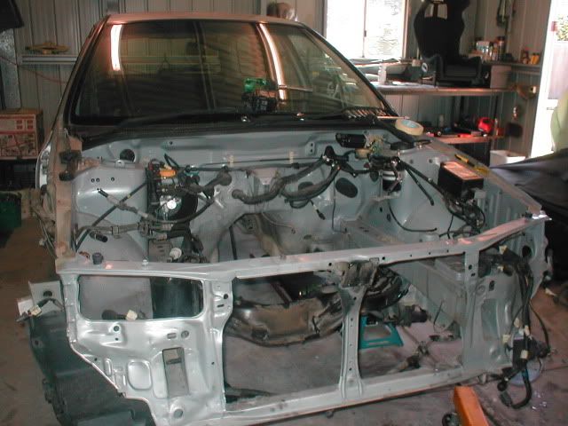

A few more days in the shed an I now have the donor car stripped of everything except the wiring loom, so I have started putting bits back into the wagon. Very exciting! (well, for me at least!). The wagon now has the 4WD tank & rear end in, and I just need to swap over the loom before popping the rest in.

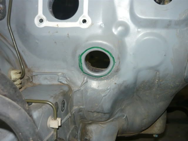

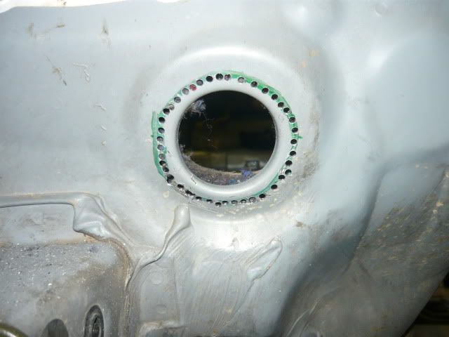

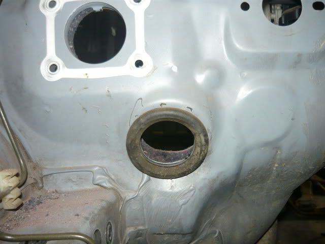

As d-generate mentioned earlier, the hole in the firewall for the steering column on the later car is a different size (45mm hole on the early car, 65mm hole on the later model).
Hole now enlarged, so hopefully that will be the last bit of modifying I will need to do - smooth sailing from here on in.
The green line in the shot below indicates the difference in size;
A bit of drill & cut
All done

Good going, get that wiring loom out then into this one next, lets you plug things in as you fit them, I always found the inner fuse box area the biggest pain.
