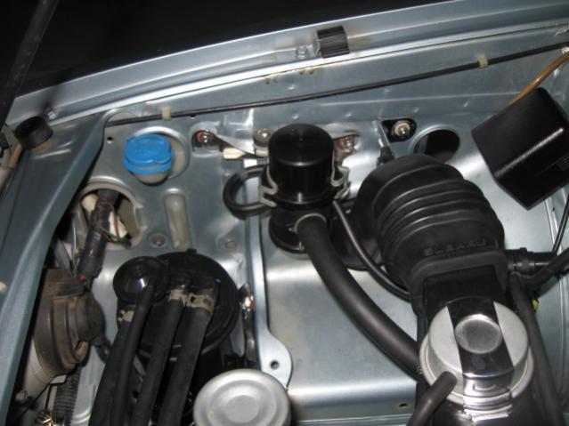

I may be able to help with prob in 1st pic. I will take a photo of how this should be and post it 2morrow evening (local time). As for coolant leak as shown in other pic, start looking around water pump and metal inlet pipe that joins water pump from lower radiator outlet. AS for dodgy fusible link not to sure. :)

I'll tear into the car a bit more tonight assuming I can get out of work before it's dark! I'd appreciate a pic... I'm sure it's simple but can seem to identify it's location from any of the pictures I find online. Just frustrating.

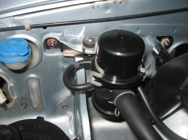

Hi there, Here is that pic. Its called an Anti After Burning valve, And as such is not actually critical to engine operation. Its more of a emission control device. Hope you managed to locate coolant leak..:D

Thanks FujiFan! Big help!
Ah figured it was emissions-related! Might lose some of that stuff later but for now I want to get it running stock as well as I can. As for the leak it looks likes it is likely the water pump but I'll try to figure it out today for sure. Going to give the car new belts and seals and stuff also before I start it up too much!

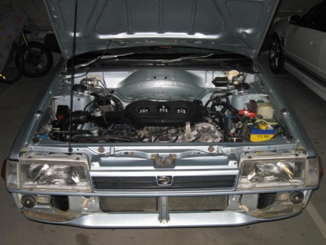

BTW: That's a beautiful clean engine bay! :) Great work!

Yeah some of that crap can go (emission gear). Good call though changing the belts and seals. As for clean engine bay, It still looks to "busy" for my liking. Just picked up some chrome plated pieces today for car, wait till you see it when its all fitted! :-D

Wow, very nice! Can't wait to see the chrome! It's almost so much nicer working on (and diagnosing!) a tidy engine. I cleaned my quick to help with the work on. I'll be cleaning it area by area as I replace stuff and service it. Got the timing belt kit and seals ordered, should be here in a week :S Now I'm going to order OEM for the intake gaskets, and thermostat.
