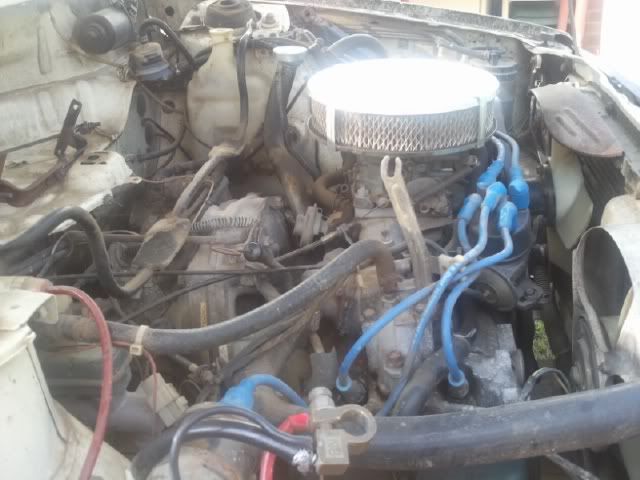

Hi i have a 84 Brumby a lot of rust she's a bit rough
but i love it. stock 1.8L motor 4 speed box new CVs
but has weber and a full 2" exhaust system.
goes pretty hard it's going to take me a bit to get her going the
way i want it to be but i think its worth it.
starting today. will take as many pic as i can
through out the build so yer hope you have fun watching the update photos
and comments.

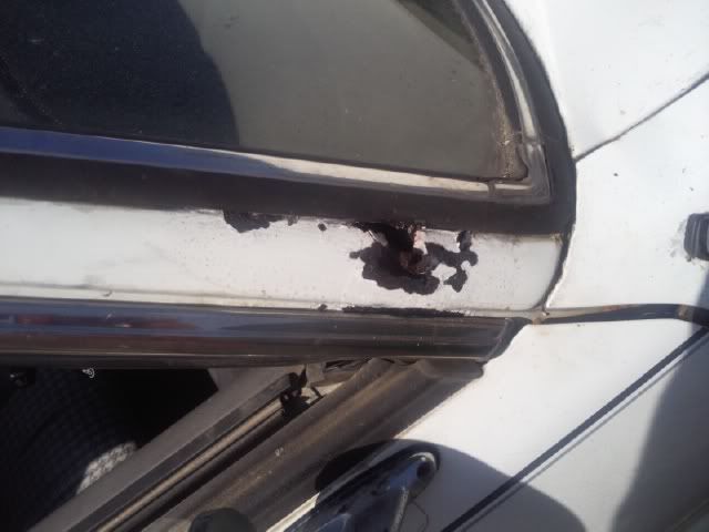

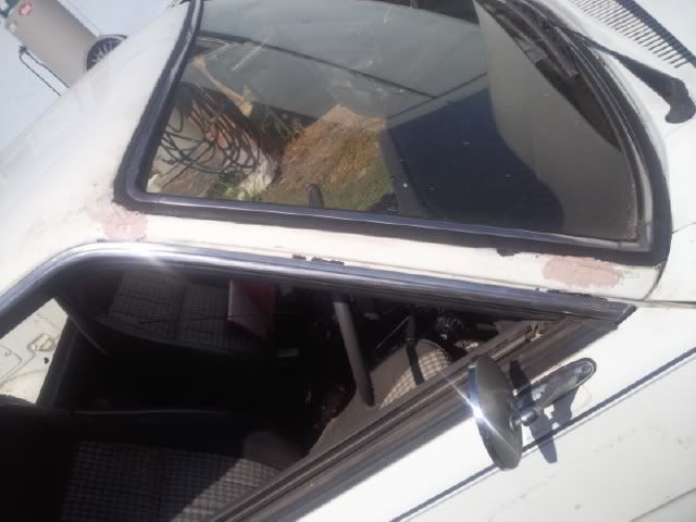

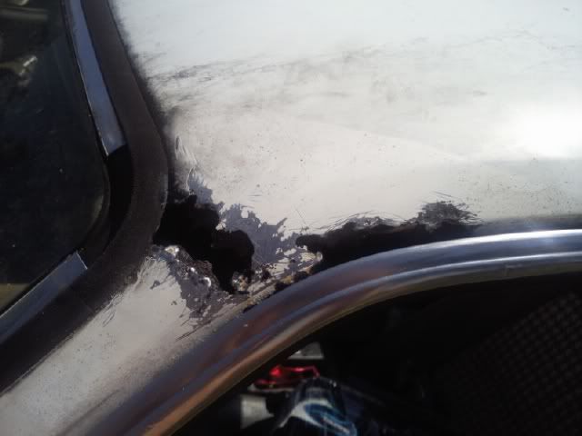

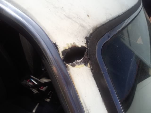

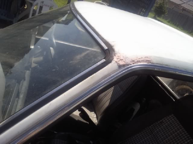

well i started yesterday and mmm yep got some rust.
lol my dad he loves the brumby
as you can see im useing bog for now foe rego. hope by the time the rego runs out i can weld them. lol well thats the plane

Bogging that rust? You'd be much safer in a Chinese Geely...
Please don't drive it on the road like that. Just because you can sneak it through rego, doesn't mean it's going to make it through even a minor accident (or even a large pothole for that matter).
Pop the windscreen out, chip out the bog, and strip the bottom corners properly, then get a mate that can weld to come over and weld some steel back into those massive voids. Even dodgy welding and rough patches (bogged over) are better than just hiding the fact that it's not a whole car anymore...

Yeah mate, you'll probably live (road accidents have been known to kill people), but it's going to hurt more when the car comes apart in a crash. And it might be an idea to remove the passenger seat and have a Mod Plate fitted to reclass it as a single seater. I say something as rediculous as that, because if you have a passenger, and they are not aware that the car is not as strong as it "appears" to be (especially if it's a child passenger), and some idiot runs a stop sign and ploughs into you... Well, you are liable for the extent of their injuries (or possibly death) both legally and morally.urabus-subaru wrote:all good it was free. and to old mate its all good with the bog ill live but thanks mate the rest of the windo is good
I'm not trying to put you down or suggest anything negative about your intelligence or ethics at this point, just imparting some hard earned knowledge and voicing well founded concernes...
Steve.

you do understand that bog will be noticed??
if you have to put it over the pit they will notice and then they can write the car off then and their. its better to wait, fix it and then have a car when your mate gets back, if not you might not be left with a car
