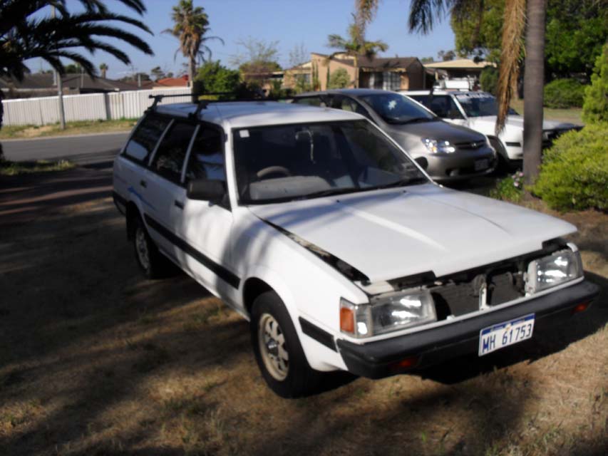

Bought a 1990 L Wagon with an apparent blown head gasket with spare engine for $1000.. named her Ruby. (yes, im one of those guys who names their cars)
The plan is too fix the original engine. I would love a EJ but i just cant afford it yet but will come later and i also wanted to have a tinker with the EA82. 3" inch lift, 14's, bullbar, spotties and personalisations..
This was around october last year. Since then I have pulled the engine out and stripped down to the cylinder heads for testing and have a full gasket kit to put it together with. Pulled gearbox/put another gearbox in, put in new lower ball joints, swaybar with nolathanes, new front bearings, front cvs from my other L and front brake pads. Stripped out seats, floor cover, roof lining and side trims for cleaning and possibly painting still decided on interior modifications

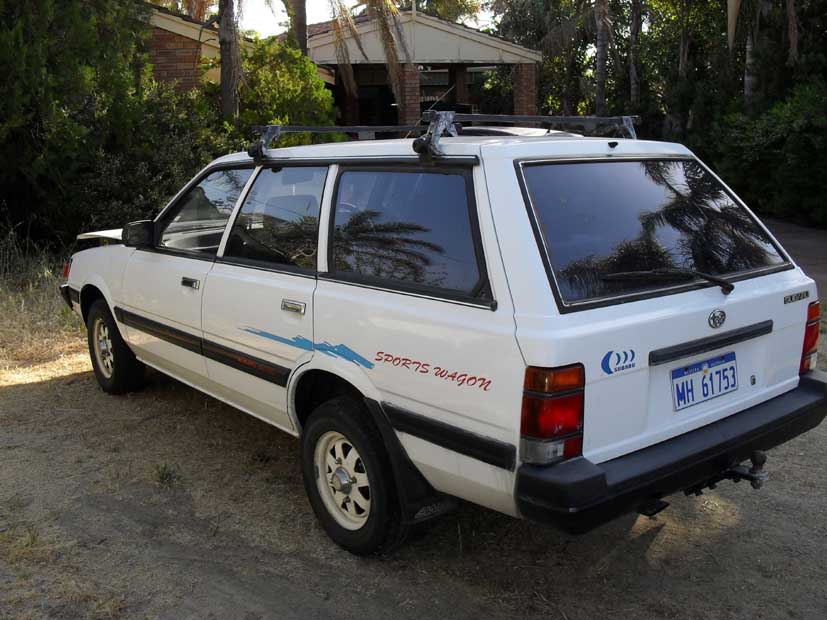

Put in lift kit and lengthen the steering link and swap the heavy duty suspension, bullbar, spotties, roof racks and 14" from my other beloved L (Lizzie is her name if you wondering)
The interior is going to be a little different to make it less of the dull grey/blue colour with no interesting features that is. Havent fully decided exactly what im doing but it wont be standard and i guarantee some people wont like it.. but i'll guess we'll see.

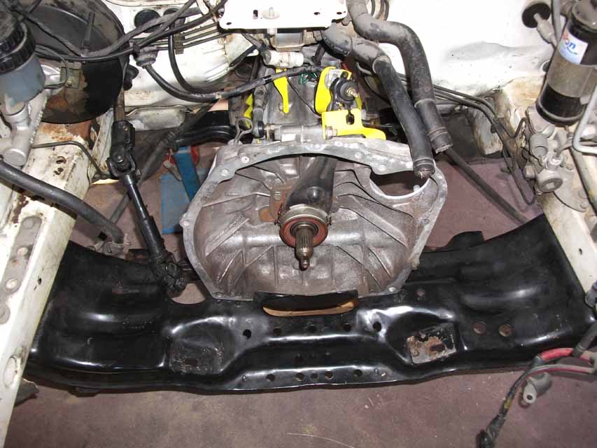

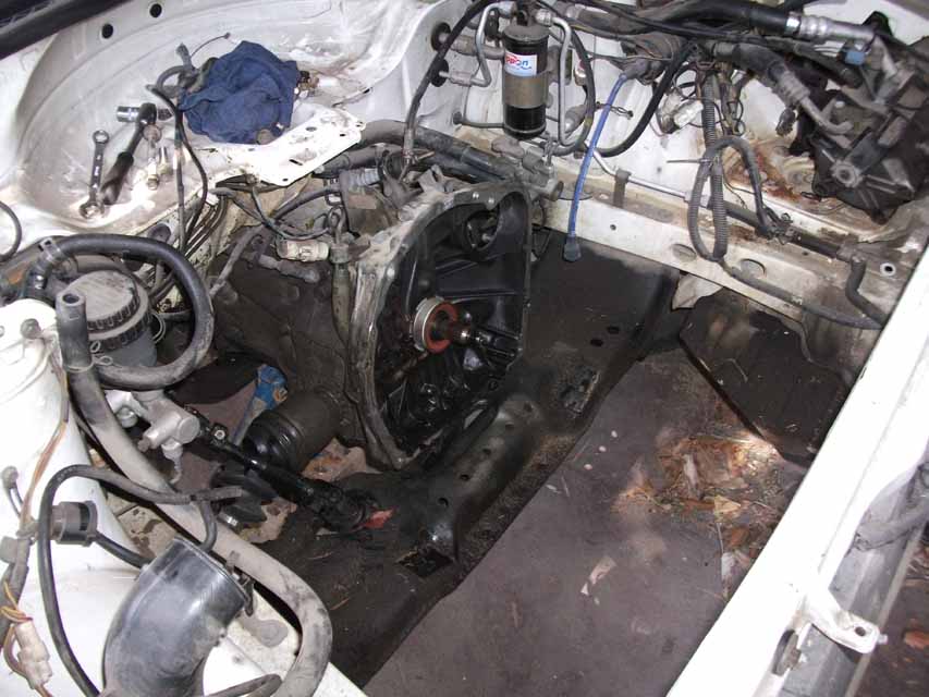

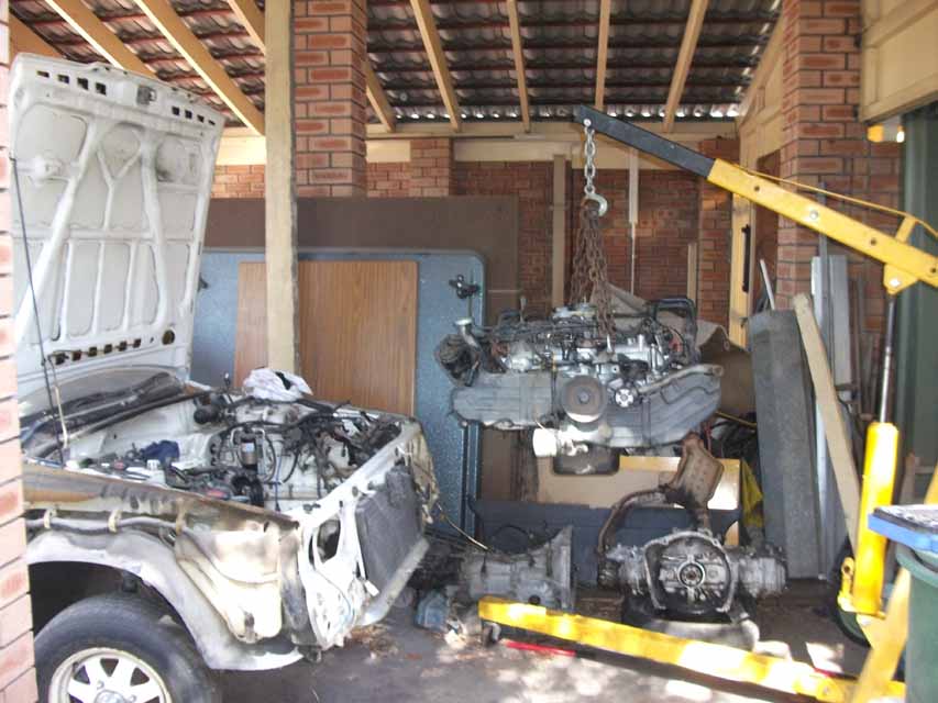

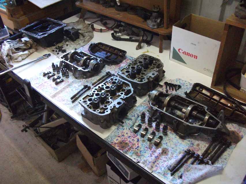

Heres a few more pictures of the progress i've made in the last few months.

- Engine apart small.jpg (92.62 KiB) Viewed 4801 times
- Engine Pull small.jpg (88.52 KiB) Viewed 4801 times
- Gearbox,engine bay small.jpg (91.65 KiB) Viewed 4799 times
- new old gearbox small.jpg (92.04 KiB) Viewed 4797 times
