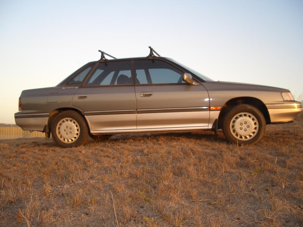

As you can see in the photo the car is currently stock standard. The must have's is a roll cage flashing light, UHF and standardized front and rear towing points.
Some additional touches include a lift kit, belly plate and bullbar.
