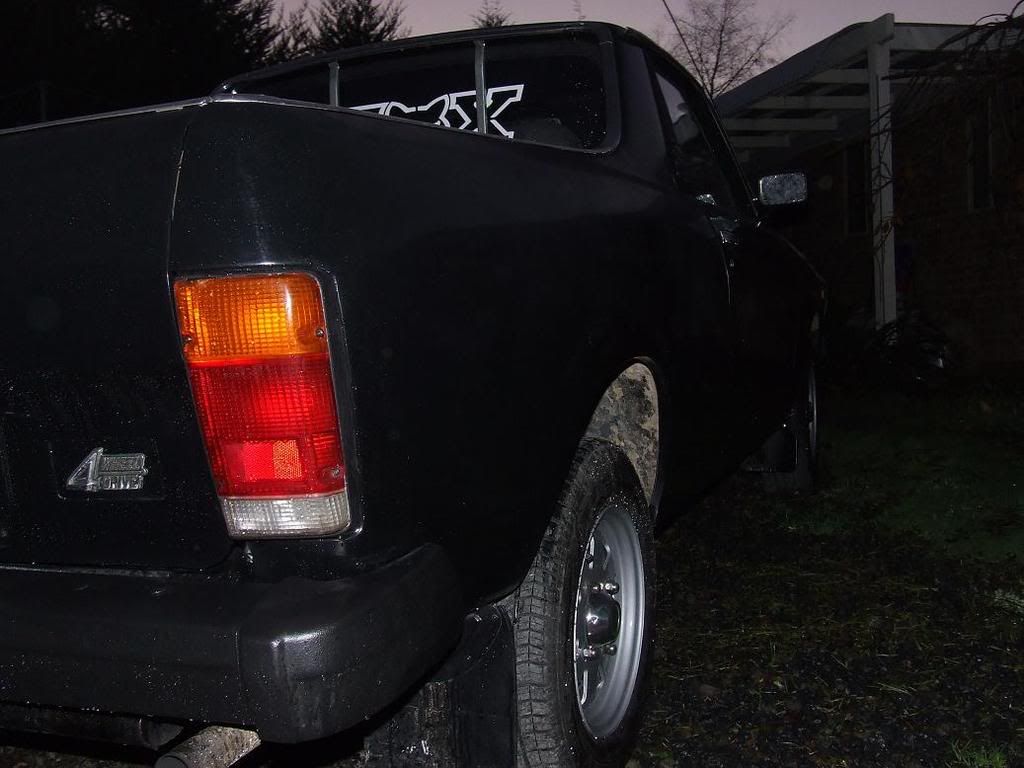

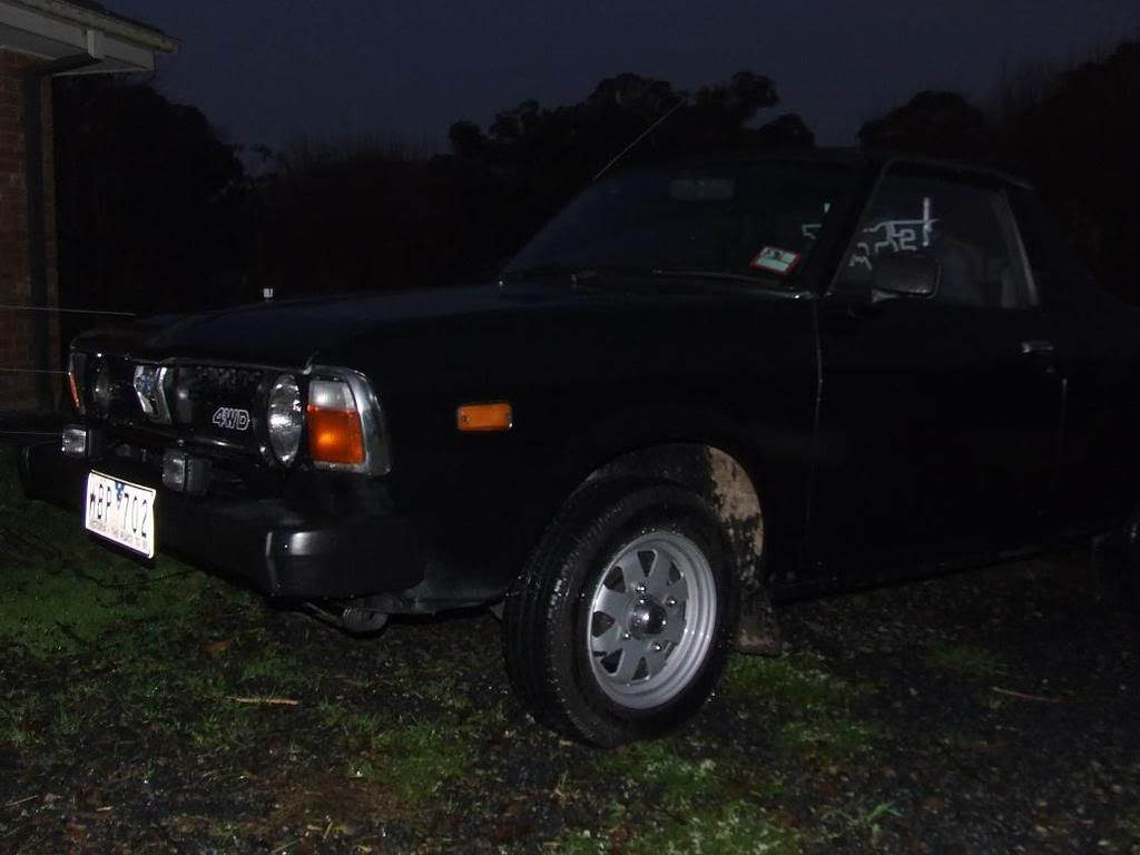

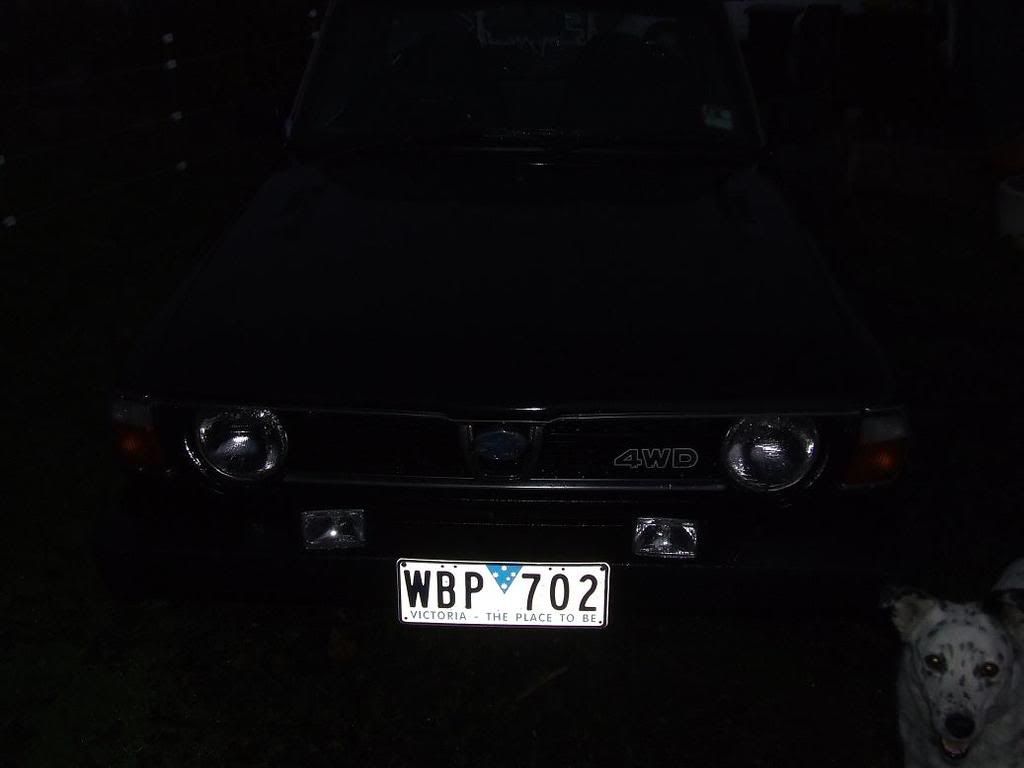

OK!!
Here's the deal... I got the brumby back.. with the EA71.. plus a few parts from my orig motor that were needed for change over.. Turns out it didn't fit quite as well as I was lead to believe.. had to transplat the pollution gear, pulleys, oil filler tube e.c.t.. and drill some new holes to bolt it all in.. but finally.. It's back on the road..*fingers crossed* costing me somewhere around $350.. as opposed to the $900 I was quoted to to the heads on the orig... plus the cost of the EA71 so all up $700 or there abouts.. Doesn't sound too crash hot when I put it like that but.. Oh well.. I cant do much about that... I was going to take the orig motor straight to the reco guy but now with all these great ideas I am getting from you wonderful forum people I have a lot more to think about.. still trying to weigh up whats going to get me going and not break the bank...
I will attach a few more pics of the beast for those of you who have requested them
If I can work it out
And let you know how I go with my considerations
Cheers everyone.. Thanks so much, again.
~Carlie

not my fault
Just a quick note...
Thats not my number plate anymore.. it's HEZMYN now.. as in 'He's MY Ute!' and the mud in all the wheel arches.. wasn't me.. I took those photos the day I brought the car home and the kid who owned it before me apparently just HAD to take it out for one last dirty spin......
~Carlie
