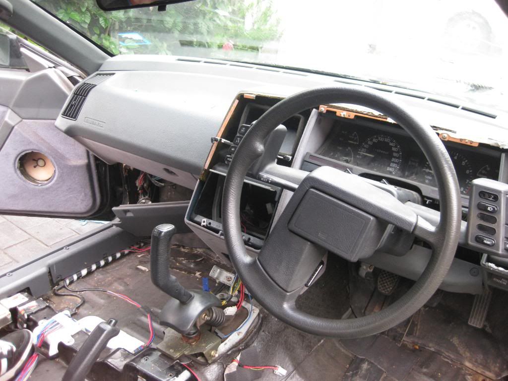

Firstly i had thoughts of changing the interior colour, e.g: Carpet, dash, and center console. I wanted to paint the interior white but remembered white can be painfully hard to get correct and when your mates touch the insides it gets really dirty, (seen too many white dashes with finger prints all over it, looked like a crime scene every time i went in the car) so I decided to go with a classic black interior look.

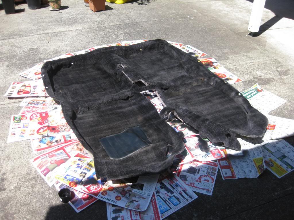

My first job was to remove the interior (and this was done early last year) and start working on the carpet, I first gave the carpet a clean like its never had before and started to paint it black, it did take 2 weeks to do because you have to wait for the first coat to dry and then do the last coat.

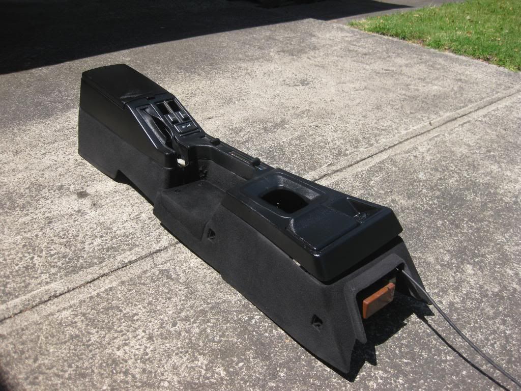

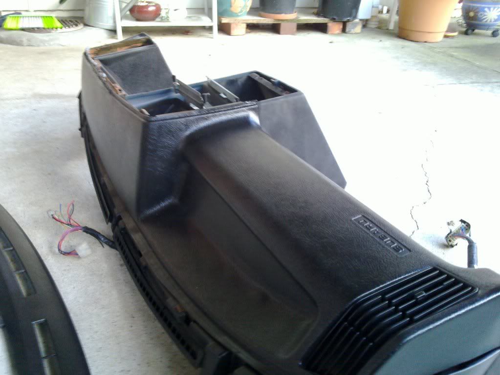

The next part was to do the center console, same style as painting the carpet, just gave it a good clean, light sand back for the paint to stick and a few coats of paint and a hot day was really helpful lol.
The most important advice I could give anyone if they want to change the colour is to make sure you over all the buttons and letters so you know whats what.
These are the before and after shots. (I still need to do the final coat so it may not look as good as it should)

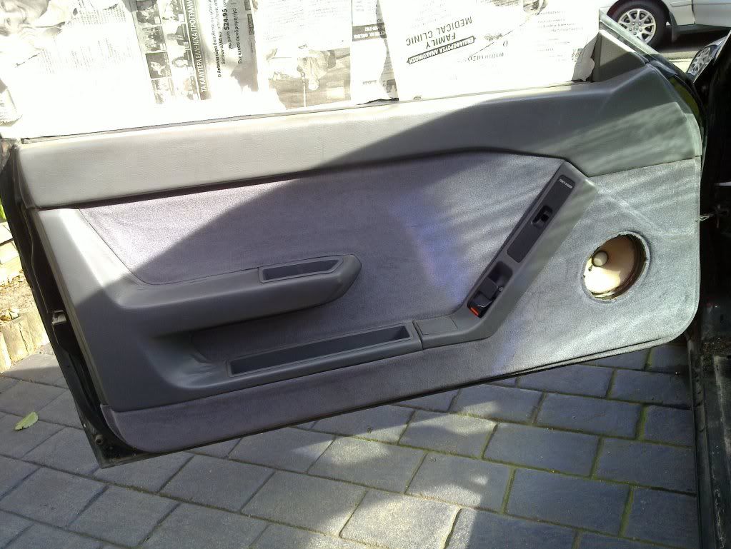

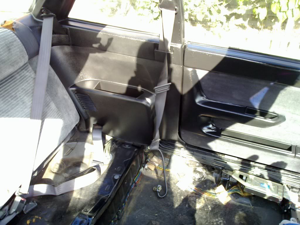

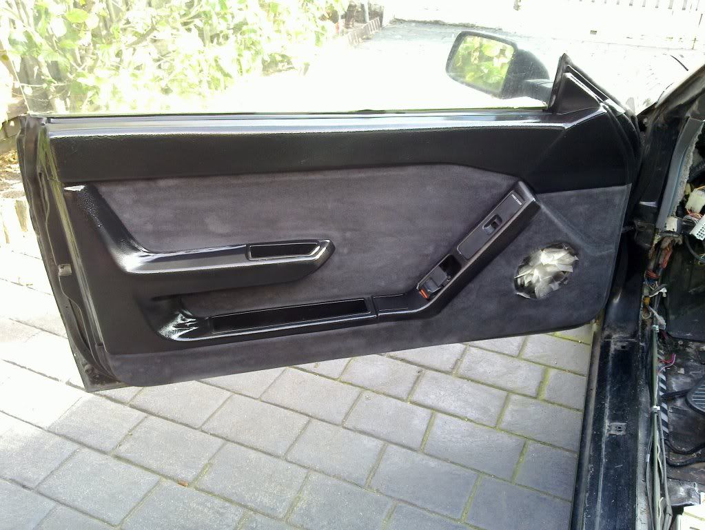

Next had to be the doors and internal trims. and this was the most time consuming because you need to tape up everything and make sure you don't spray the windows.
With the last one, the door came out better when the paint dried.

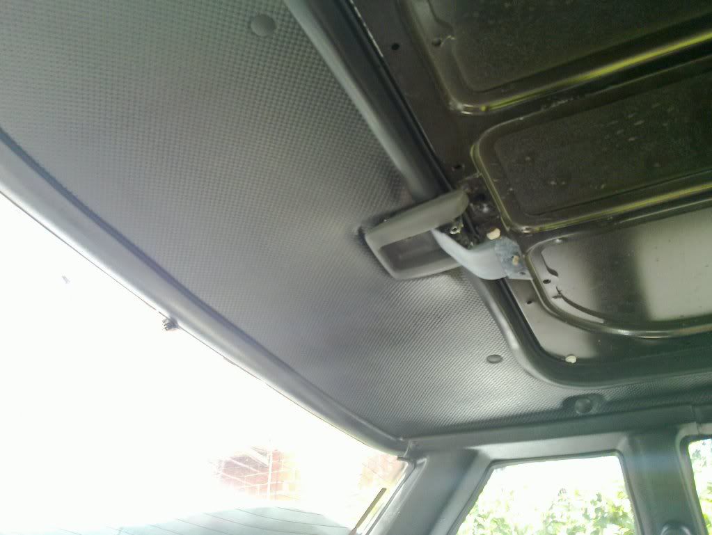

I managed to take a quick photo of the roof lining today and I have to admit its only the first spray so it never comes out the best, but I'll finish that off when the roof is getting fixed :)

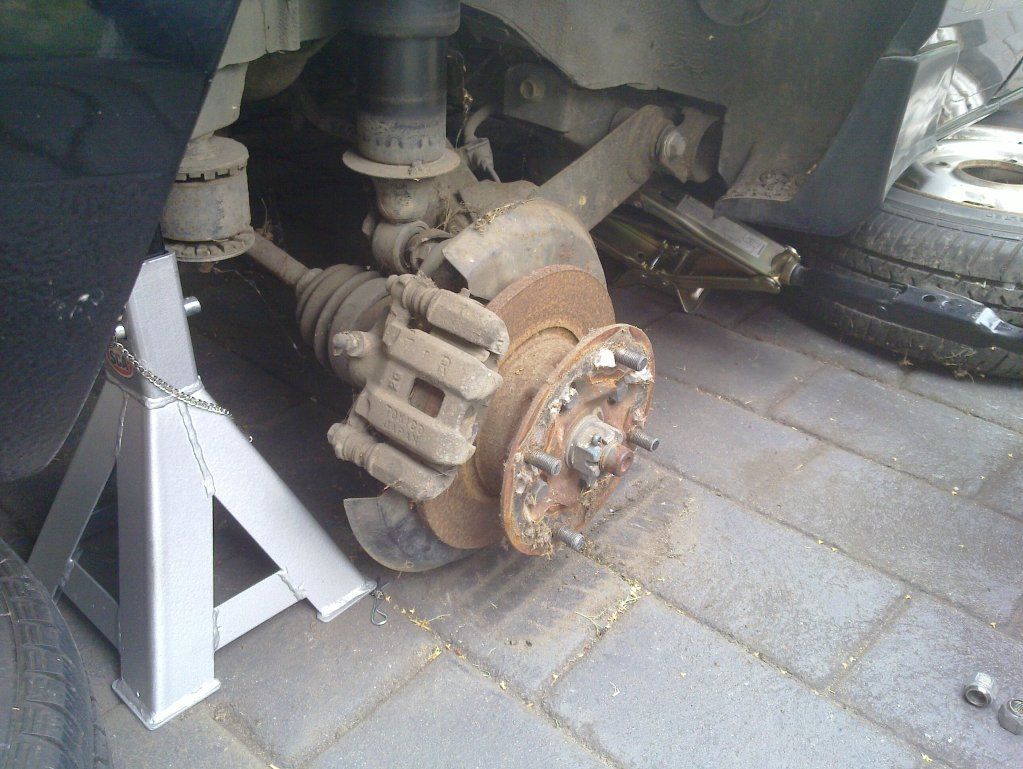

I have another question I am not to sure off with the rear suspension, I found this problem awhile ago when I took the tyres off and put the car on stands (I know in the photo 1 of the stands are in the wrong place but I do have more than 4 stands available at that time).
In the photo below shows that the hub has fallen to the ground but on the other side it is fine, does anyone know what I have to do to fix it?

Post by steptoe » Mon Apr 21, 2014 5:58 pm
I had a part number somewhere for rear discs ....I'll look and see.....
You must have air bag suspension ?

As for the suspension it is an air bag system, would this issues be caused by a leak, because when the car was working only the passenger side fell and the drivers side was fine, also how would I find the lines so I can trace if the hose or rings are broken?

Post by steptoe » Mon Apr 21, 2014 7:13 pm
Those little black high pressure air lines are usually with the wiring looms - I know zip about the air bag system as all three of my cars that were born with it had been upgraded to normal stuff by time I got them.
