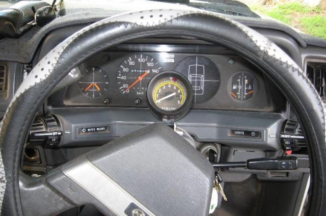

I would love to wire in a tachometer just to see what revs Im doing in 5th at hwy speed as it really doesnt sound like much :)
Post by RSR 555 » Mon Nov 01, 2010 10:14 am
Have you got an old school dwell meter? that will work as a temp tacho :)
Post by TOONGA » Mon Nov 01, 2010 10:59 am
RSR 555 wrote:Have you got an old school dwell meter? that will work as a temp tacho :)
somewhere in my cavern of crap I have, I did think about it but then I thought if I was going to that much trouble to run wires I may as well put in a tacho
it is a pity the wreckers don't have one :)
may have to look on ebay :)
Post by RSR 555 » Tue Nov 02, 2010 9:30 am
Oh.. ok.. I thought you wanted one just a tempy one to see (was thinking just taping it to your windscreen) but if you're wanting it more permanent then yeah, look at Ebay :)
Post by TOONGA » Tue Nov 02, 2010 9:59 am
awww I want one of those huge ones that makes it look like the driver has a deformity on their head :) then I would fit in really well with the other ricers down here :)

well its not quite the same as the ricer's but it does the job
Hylton:twisted:
suby rebel
Posts: 16
Joined: Sun Apr 13, 2008 12:37 pm
Location: Wickepin West Australia
Post by suby rebel » Tue Nov 02, 2010 12:06 pm
Like this Toonga? :)
Post by TOONGA » Tue Nov 02, 2010 12:21 pm
LOL they are both great
but I went with this one as it was a whole 19.89 delivered :)
http://cgi.ebay.com/ebaymotors/ws/eBayI ... fresh=true
d_generate
Posts: 1529
Post by d_generate » Tue Nov 02, 2010 2:14 pm
Why Sir!! Is that an alarm clock on your dash board?
Post by TOONGA » Tue Nov 02, 2010 5:59 pm
d_generate wrote:Why Sir!! Is that an alarm clock on your dash board?
yes... yes it is and when it rings it is time for a new engine
I have found out that most 5 inch tachometers are around 40 - 1000 dollars
where as a 52mm one is just under 20 dollars
