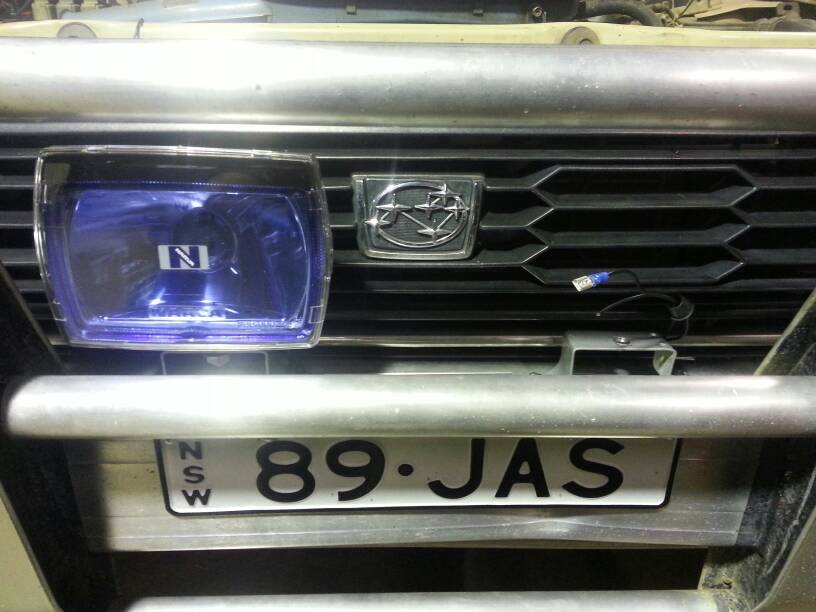

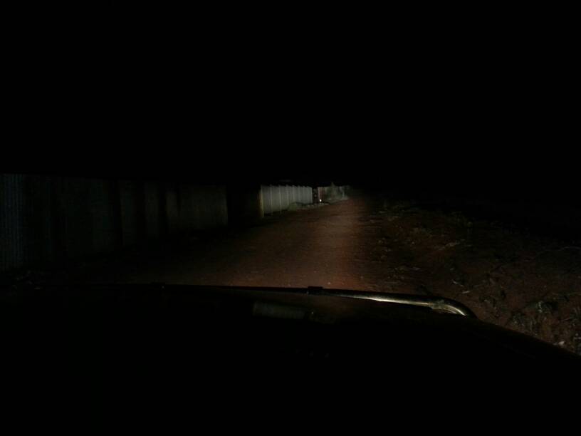

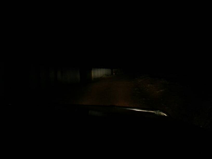

Saw Frog today and got my bushes for the gear stick. Also picked up some narva driving lights while its 20% off for nrma members at repco. The old ones didn't fit anymore when i fitted the bullbar. So it was time for a freshen up.
[ATTACH]3962[/ATTACH]
Forgot to get a pick of both. But this shows the little brackets i used. Pretty happy with them, light is very white!
[ATTACH]3963[/ATTACH][ATTACH]3964[/ATTACH]

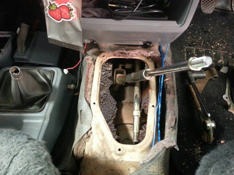

Gear stick bushes!

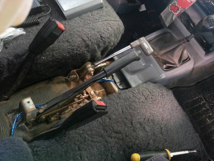

Tore the centre console apart!
[ATTACH]3966[/ATTACH]
[ATTACH]3967[/ATTACH]
Unbolted the 4wd selector.
[ATTACH]3968[/ATTACH]

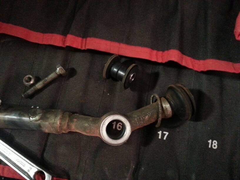

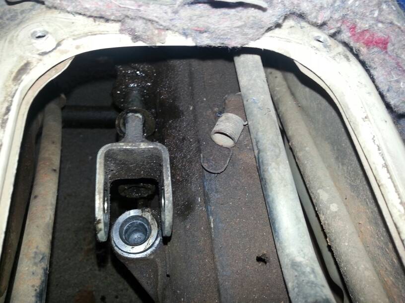

Which freed up the rubber boot and gave me access to the selector bolt and bush.
[ATTACH]3969[/ATTACH]
[ATTACH]3970[/ATTACH]
More in the next post!

Once it's all out it's a simple process of swapping everything over.
I put a bit of grease in the bush to, so the dust has something to stick to. Then i put grease in the locator as well.
Then everything bolts back together!
Too easy.

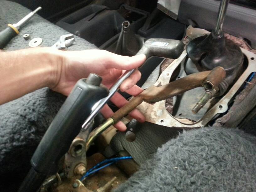

Post by Stretchomatic » Fri Feb 22, 2013 11:02 am
I also slotted the selector and tightened it up...
!!!Make sure the gear selector was in 2nd or 4th otherwise you wont be able to slide the selector off easily!!!
First take the little spring off of it.
[ATTACH]3971[/ATTACH]

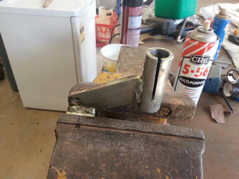

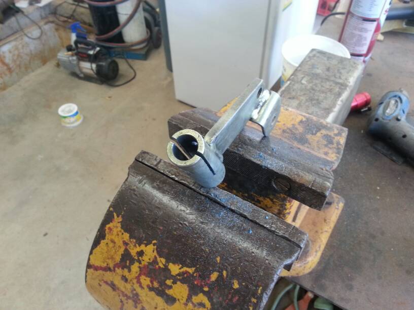

Then slip underneath, I found mine already had a bolt through it. But it wasnt slotted very well. (So unfortunately i dont know how the original pin is removed). Unbolt the exhaust support and unbolt the selector. Slide it off. Mine only had one side slotted which means no clamp and a selector with more play than a box of puppies.
[ATTACH]3972[/ATTACH]

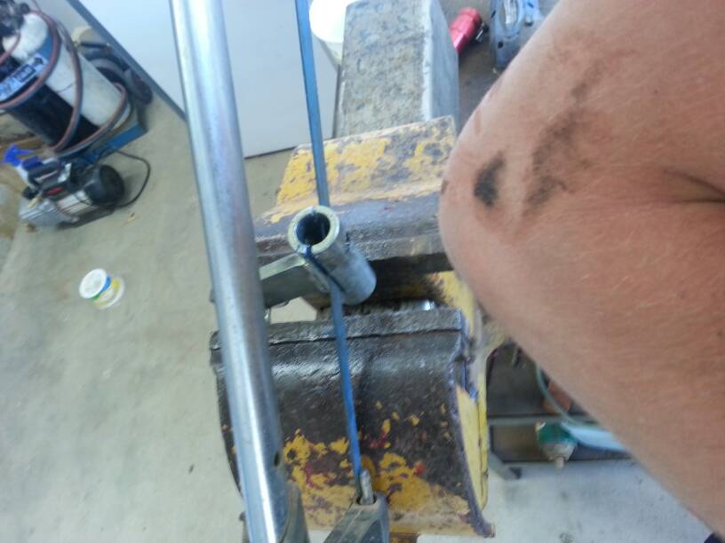

I attacked it with a hacksaw with two blades... both in the same direction. It took some elbow grease.
[ATTACH]3973[/ATTACH]
And I got this.
[ATTACH]3974[/ATTACH]
So I slipped it back in and tightened the nut and bolt good!
Alot less play!
[ATTACH]3975[/ATTACH]

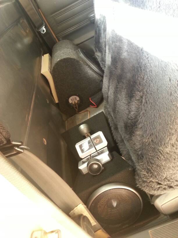

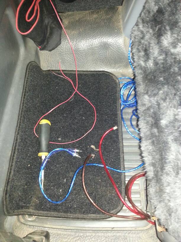

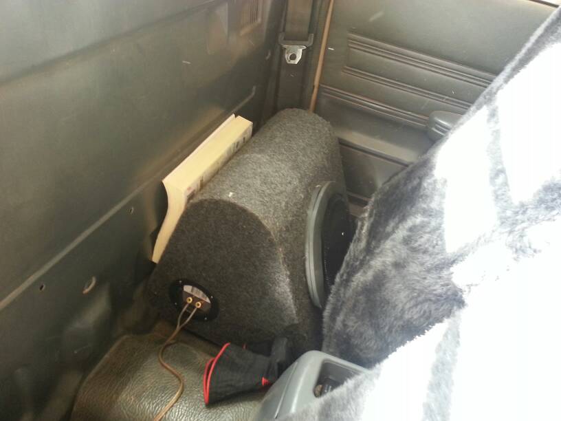

Changed the stereo setup again. Decided to try a 10 inch sub behind the passenger seat. I redid all the amp wiring aswell since i wasnt happy with the old stuff.
[ATTACH]4018[/ATTACH]
Ended up with this.
[ATTACH]4019[/ATTACH]
[ATTACH]4020[/ATTACH]
Sounds not to bad. Ill have to fiddle with the wiring and tuning to get more volume out of the sub. It doesnt kick in until the music is pretty loud.
Cheers, Stretch.

Did a bit more tuning. It's getting better. Thunk I might try a slimmer ported box, as the seat soaks up most of the bass.
Yep thats how the speakers are all the time, I really dont want to cut or drill holes anywhere, so its a compromise.
This is the first ute ive put a stereo in, so ive got a bit of figuring out to do.
