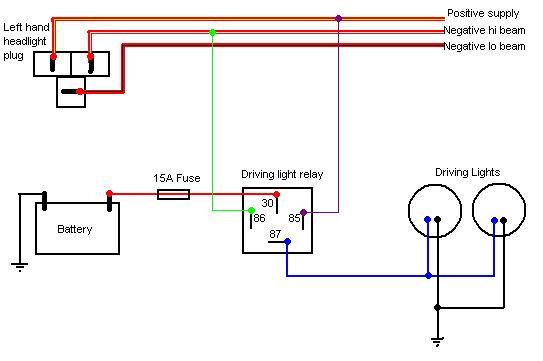

I did some more work today, attempted to hook up the wiring on the Ute, thought I had rigged it up fine and then when it came to the switch on, nothing. So I will try again later.
Does anyone have any .pdf's of the wiring of the lights or know of a thread telling you explicitly which wire is connected to the high-beams? I want them to work with the high-beam when engaged.

try this: i think Gannon or possibly Bennie posted this up a while back and I think it is the most clear diagram i have seen yet..60766244 wrote:I did some more work today, attempted to hook up the wiring on the Ute, thought I had rigged it up fine and then when it came to the switch on, nothing. So I will try again later.
[ATTACH]3710[/ATTACH]
The ute is looking good
Edit: after looking a bit closer at the diagram, i would use the positive from under the dash, not at the lights, and i would put i remote switch in it so you can switch the spotties on and off in the cab.
- subarudrivinglights.jpg (18.94 KiB) Viewed 34505 times

Hey budMTB92 wrote:try this: i think Gannon or possibly Bennie posted this up a while back and I think it is the most clear diagram i have seen yet..
It's a nice diagram. I think I will just need to have a good go at it another day when I'm in the mood... Just have to sell my Impreza so I can rhino-line that tray
Yeah that was my diagram, but there should be a revised version that shows a switch.
like this
You can use the wires under the dash, but I wrote at the left headlight because this is where most people mount the relay and the fuse, close to the battery and run a twin back to the switch in the cab
like this

Maybe this was a variation in between wagons and utes or between single-light and double-light utes? Not sure.
I initially wired up sort-of following the guide with the Red+Yellow (from under the wheel) wire with the switch so as to minimize wiring, but it ended up not working because whenever the switch for the spotlights was flicked on the high-beams would drop out and the spotties turn on.
So I ended up going to the lights themselves and working off the Red+Blue wire to create the success.
The diagram for my ute is as follows.
Cheers for the help and I hope it helps others! Hopefully it will be useful over the night-driving that will be happening lots the next few days.
Cheers Gannon, (Robbie too) for the diagrams and wire colours! It helped, somewhat. Only one slight discrepancy with the positive supply being Red+Blue at the lights themselves instead of Red+Yellow. The wire inside the cab under the wheel is Red+Yellow as stated.Gannon wrote:Yeah that was my diagram, but there should be a revised version that shows a switch.
