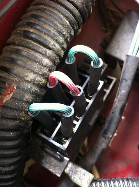

Just check the condition/integrity of the fusible links in the box leading from batt pos, hides just under wiring loom inside right front guard under bonnet . The might not blow ever, but can corrode and cause all sorts of grief.
I checked out the Fusible links today, they look like they are in good condition. This is them below unless I am way off!
[ATTACH]3656[/ATTACH]
Post by TOONGA » Tue Oct 30, 2012 3:30 pm
Thats them, did you pull one out and inspect the ends?
Mine looked great on my brumby the ends were great as well. what was really bad was that corrosion under the cloth cover had eaten away the metal, and the PO had used speaker wire to join the ends back together. Pull one out (gently) and then pull the cloth cover back to check the condition of the wire.
The ends look good - but your right, I haven't checked underneath the cloth. Theres a rubber sleeve around each end, did you just force it up feels pretty tight?

Post by TOONGA » Tue Oct 30, 2012 9:13 pm
If the cloth won't move don't pull on the rubber, as you will never get it back into place.
Mine didn't have the rubber which is probably why they corroded away, that and WA salt air.

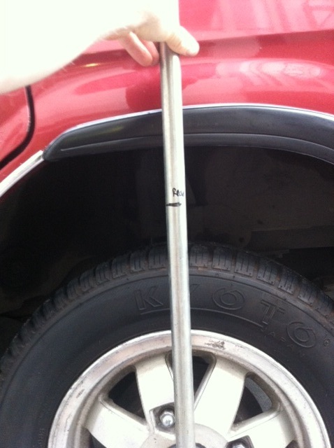

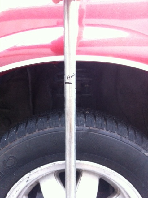

Finally got around to adjusting the factory suspension today. Wow. Mind Blown.
Not only did it raise the car by a hell of a lot, The handling and bump/pothole/curb taking characteristics are at least 100% better. Literally cannot believe the improvement.

Post by El_Freddo » Sat Dec 01, 2012 8:19 pm
You will find that your handling is better due to the spring rate ramp up from adjusting the suspension up.
New springs will possibly see it go higher. What's your down travel/droop like compared to before adjustment? To test this you just use your car jack and measure before jacking and after jacking just before the tyre lifts off the ground. Do this both with the high and low settings. Ideally you would have done it before you wound it up...

So, did you set the suspension heights front and back as per the manual or wind the suspension up a bit till the car was higher ?
I could never wind mine up to the heights stated in the Gregories or the Haynes manual without the camber totally stuffing up.
I have no idea what is wrong as all the suspension is the original stuff so should have been good and I measured from all the correct points.

Yeah I just wound it right up on the front - camber is bad and is wearing the outers of the tyres.
Rear also just wound up. have backed that off a little now however.
