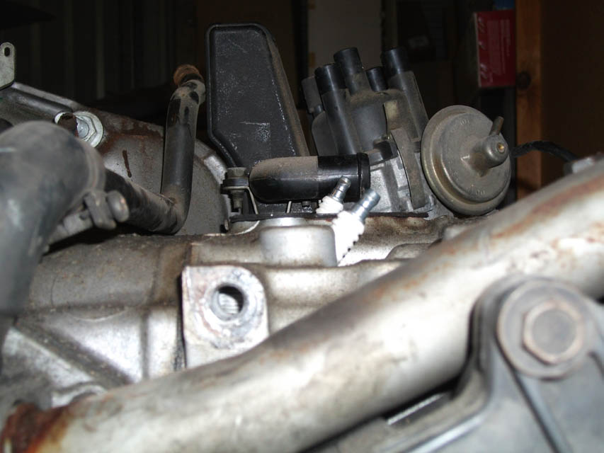

Back to the reason for my thread.. this week i sent the cylinder heads off and im getting them faced and pressure tested. I forgot to tell the guy that one spark plug hole was cross threaded and if he could do anything about it. Anyone got any ideas? The engine ran before so it should run again but i would like to fix the issue..
Cross threaded sparkplug small.jpg (86.11 KiB) Viewed 5094 times

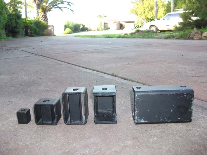

Hey a few quick questions on a 3 inch lift kit..
i bought this one from adamb and i would like some help identifying the parts and to see if i got all of them..
The parts i have are apart from the steering extension..
2 x long 3" blocks: engine cross member mounts
front and rear strut spacers.
*4 x 3" long blocks. i think i need 6?? for in front and behind the rear axle and the diff hanger?
*2 x 3" blocks ???
*2 x 3" C shape blocks ???
*6 x 2" blocks ??? im prity certian they are for the part that the radius rod joins onto but why are they 2"?
*2 x 1" solid little blocks.
* means one of them is in the photo i attached.
if you understood what i tried to explain. any help would be awesome.

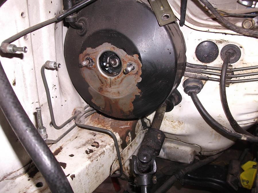

At some point in ruby's life the master cylinder had leaked and taken all the paint off the booster and chassis below it so I removed the master cylinder and booster and will be sanding down and repainting another time.
I started cleaning out an old little shed in the back corner of our property to make into a painting booth so i can paint and not worry about the over spray or it getting rained on etc.. I put a light in and small make shift shelf but I still need to move some more stuff out, sweep it out and cover the paint area.

try a tap and dye set for your head,,you may be able to re thread it if not to bad if not take it to your local mechanic and he should be able to helicoil it.the put in a new thread .(its actually cheap)i voted ej22 from experience.i have owned and driven both ej20na,ej22na in a liberty and the 20 goes well and revs hard but the 22 does go better (in my opionen).Did you have a steering extension for your kit if not heres a little trick..optain yourself 2 steering nuckles(cant remember if its p/steer nuckles or not but you will no by the lenght required) and simply cut the end of another steering column(the end spline) ,place this in the middle of the 2 nuckles,,,(you will need to grind the piece of steering shaft that the bolt goes thru to clamp them together)then put onto your steering column,,this can be used from 2" to 3" lifts and i have done this many times,,

I managed to get my cylinder head's spark plug hole tapped out at work so thats sorted and i have painted various engine parts and put it all together almost.. should be going back in soon.

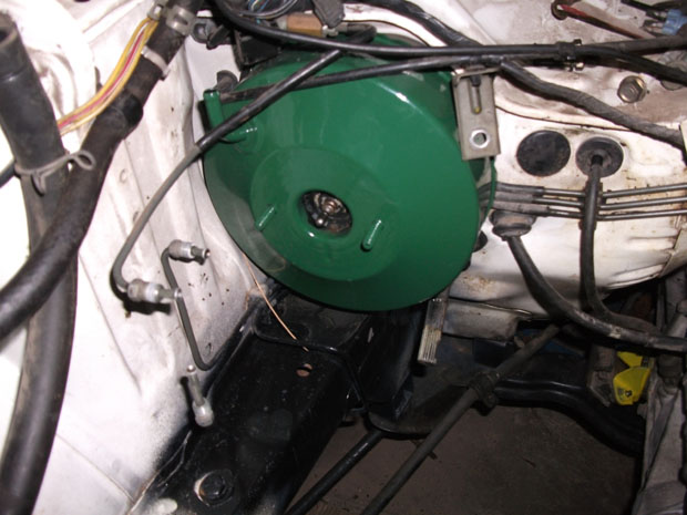

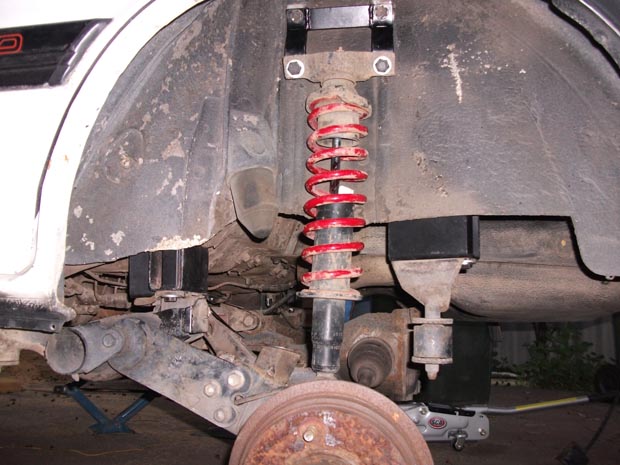

Just got some pics of the painted brake booster and the 3" lift and heavy duty suspension in the rear.
Rear suspension.jpg (84.99 KiB) Viewed 5316 times
Booster painted.jpg (88.34 KiB) Viewed 5308 times

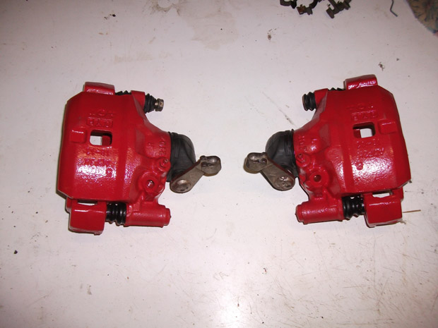

I got my brake calipers back the other day and slapped them on but i lost all but one of the brake hose retainer clips.. have no idea how. probably put them somewhere and forgot where.. So i have to get some soon..

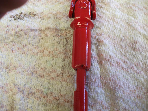

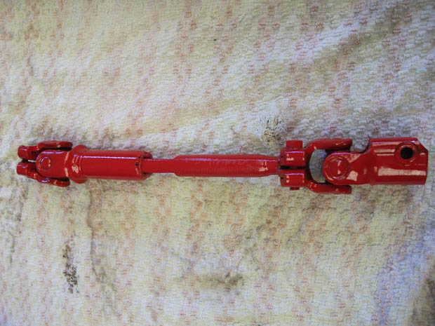

I've also been working on the steering extension for the 3" lift kit. I ended up cutting out the straight part of a broken swaybar i had and grounded it down to slide into the original uni joints. Then i tightened the bolts and it seems to hold but i will be getting it welded to be sure..

I finished off the brakes the other day and they look very nice, pity no one will see them behind the sunraysias though hehe..

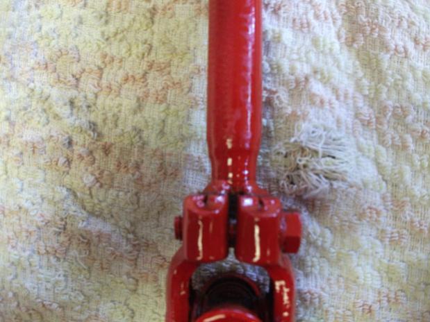

Also got the steering extension welded. i havent put it in yet but i think my amature engineers skills will prevail and all will be well.
extension welded.jpg (45.45 KiB) Viewed 5260 times
extension top.jpg (91.65 KiB) Viewed 5258 times
extension all.jpg (83.92 KiB) Viewed 5261 times

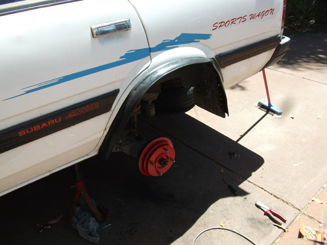

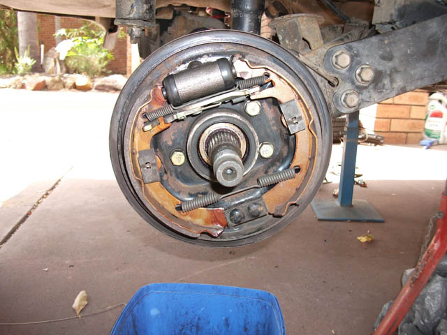

Replaced the rear wheel cylinders and gave them a good clean out and painted the drums with left over caliper paint.
painted drums.jpg (93.88 KiB) Viewed 5254 times
Rear brake edit.jpg (86.93 KiB) Viewed 5255 times

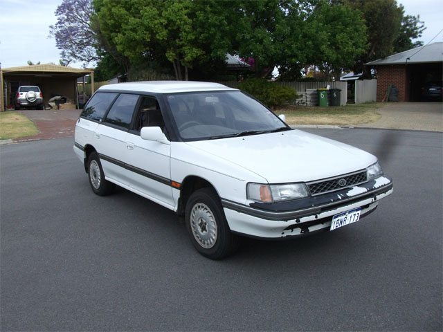

Libby edit copy.jpg (93.9 KiB) Viewed 5259 times
