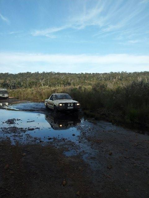

Post by Eatu4t » Tue Oct 29, 2013 1:20 pm
Just a quick tease until I can get all the photos compiled from our weekend adventure :3
