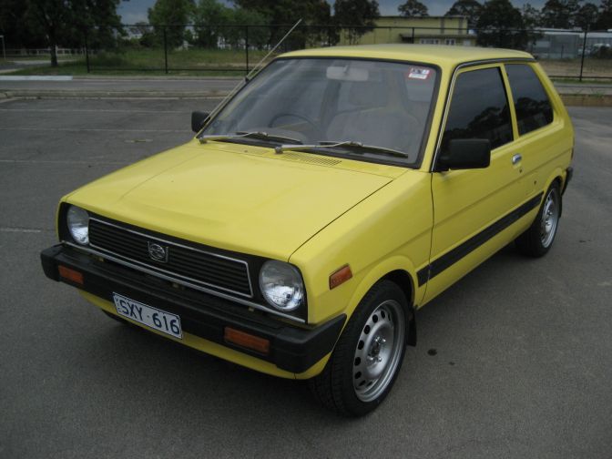

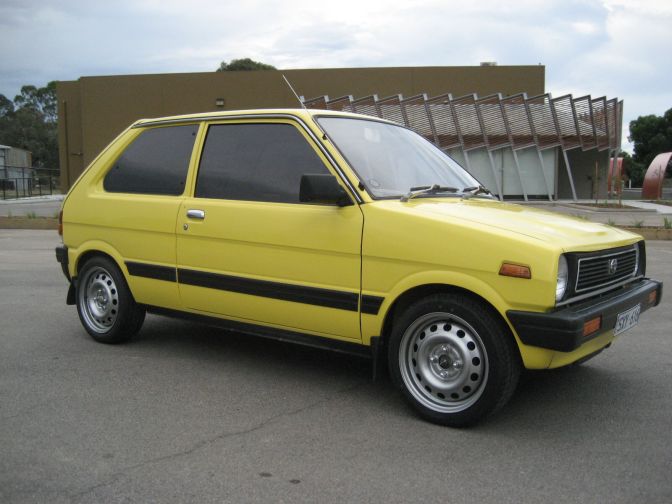

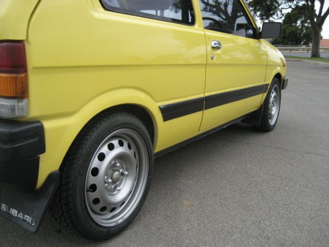

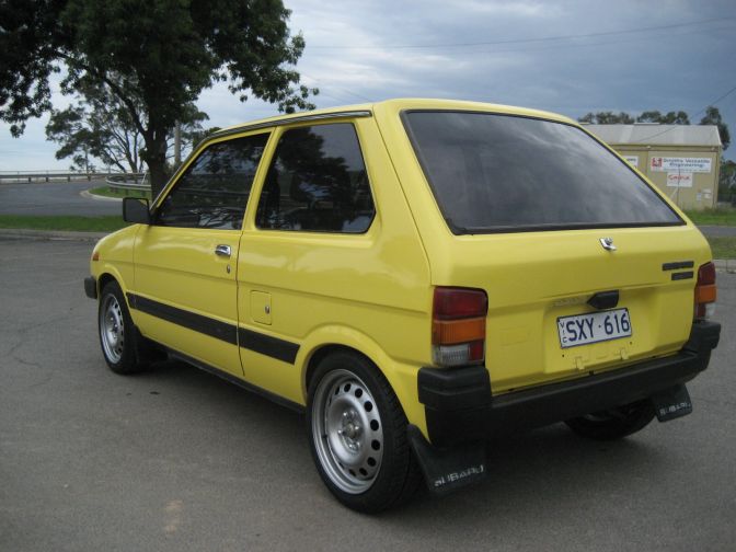

Guys just wanted to show you what you can do to a Sherpa even when everyone tells you nothing will work, well i found wheels, tyres and all needed to make the car look tough

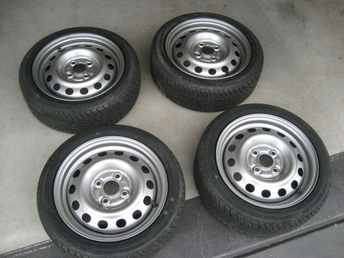

There wheels are 2007 Honda Jazz wheels, the only mods to fit them was tap the rear coil area flat in the rear gaurd and machine the brake drum hub flange down to 55mm, the front had no issues at all
The tyres were quite hard to find in OZ, but after some research in found Federal made them, there size is quite rare in OZ, there 155/55r14
Then some adjusting of the coils to get the ride height down and done, a sweet sitting Sherpa
Painted the bumpers satin black to break up the yellow a bit, and the tint, mmm

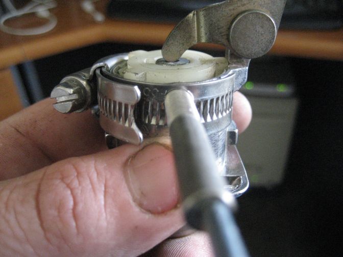

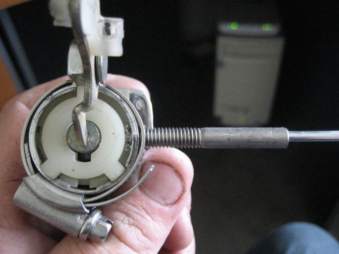

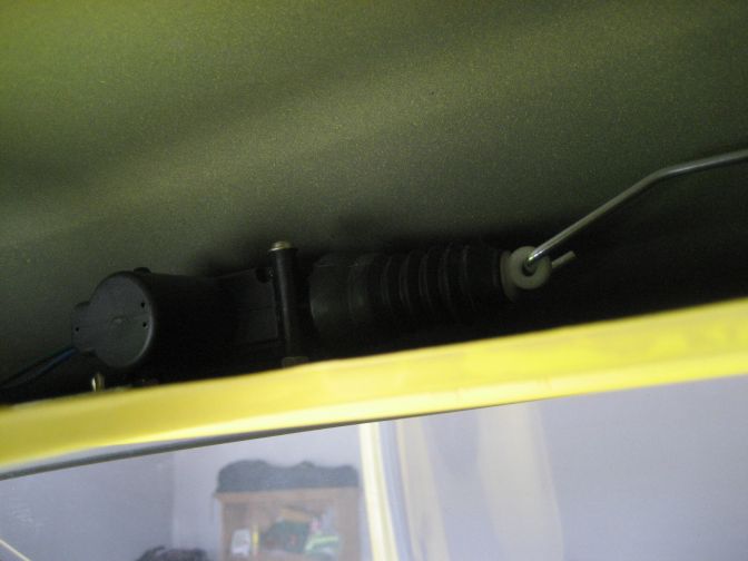

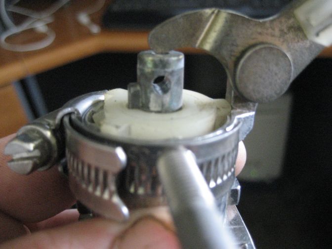

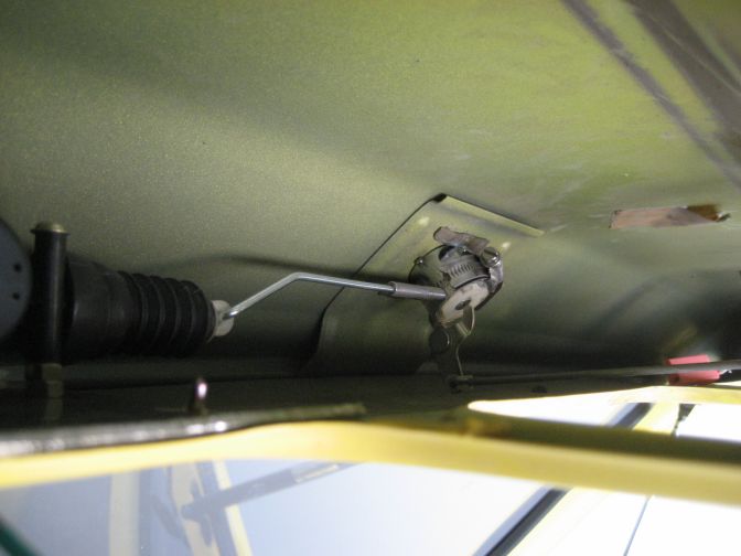

Here is the barrel mods to do it, changed from a sliding plate to the rod, all the was required was a 35mm stainless hose clamp, a 6mm bolt, and the rod that come from the central locking kit, bit of cutting, some drilling and tapping
Not much to look at but you cant see it anyway, its very strong, im very happy with it so far, check the pics
The rod slides inside the hole drilled in the 6mm bolt, its threaded into the hose clamp and the lock, then the hose clamp is done up to shift the thread a few thou and it locks the bolt in the right location, this can also adjust the preload and the shaft, little bit of locktite once ive re-installed it and it will be sweet as

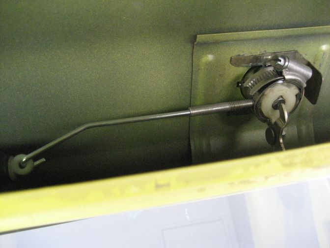

Post by JET-6 » Tue Nov 27, 2007 2:09 pm
Ok got the rear door installed, well it worked out very well indeed, have a look at the pics, some 3mm alloy plate and some screws and bobs your uncle, tests out perfect, now just to do the front door and im done!
EDIT: Just got one of the doors done, came up sweet and system is working well, just the drivers door to do and its done, then wire the interior light to the drivers door, needs a switch put in
