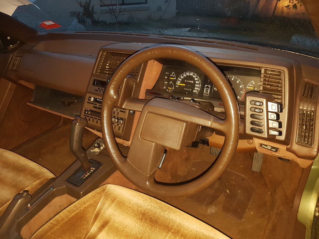

Hi all
just managed to take some photos of the new vortex and I will be working on my black one tomorrow and keep everyone updated.
let me know what you guys think :)

Looks very clean!
The front bar doesn't bother me but I don't know the difference! You'll have to find out if they're a direct swap - if I were a betting man I'd say they are.
Your black interior will look good against that green of the body. Brown interior is so 70's that it should've been left there.

that is a great score Johnny ... that is the first in tact dash surround I've ever seen look after it as they are rarer that the rear discs

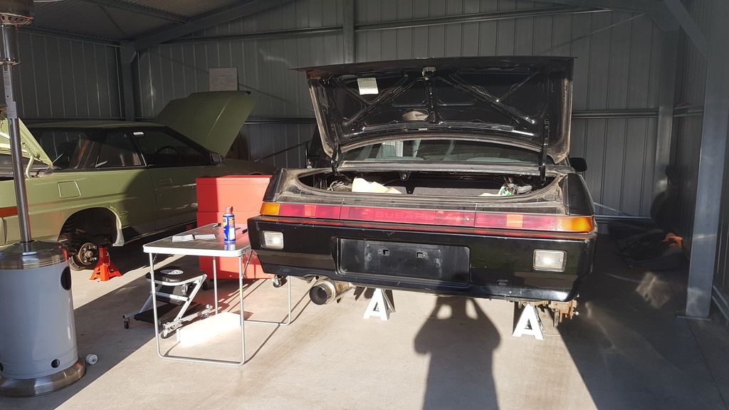

Just a small update.

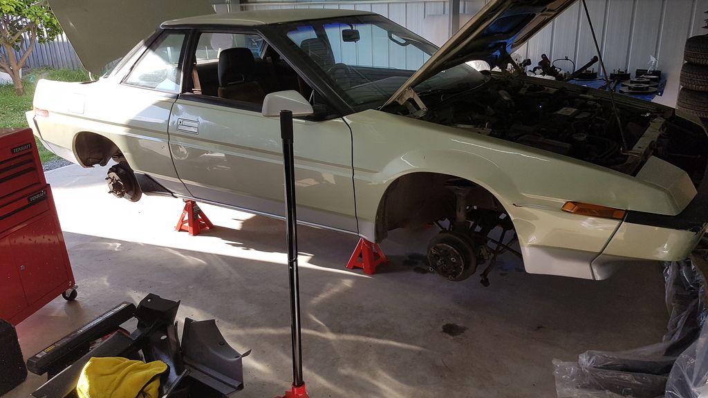

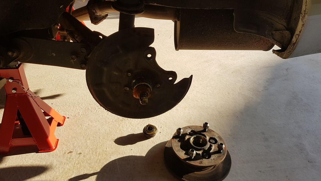

I have started to do the conversion and now have both cars on stands, removed the wheels and have removed the rear diff and rear axle. Only problem I am having is removing the front hub from the Green Vortex as it is pretty stuck. I have used an impact wrench and a breaker bar with an extension for more torque but still won’t budge (even sprayed the wd40). Is there another way of removing the stubborn hubs because I am tempted of getting a angle grinder and just cutting it off completely lol.

Post by El_Freddo » Sun Nov 12, 2017 9:18 pm
Looking good mate!
Front hub, are you talking about the 36mm castellated nut? If so I've always cracked these with the tyre on the ground with 3/4 inch drive breaker bar by jumping on the breaker bar.
On stands I've found that trying to crack this nut only results on spinning the hub due to the hand brake not able to hold the torque that's applied.
dfoyl
Posts: 717
Post by dfoyl » Wed Nov 15, 2017 7:31 pm
If it's on a stand get your significant other to sit in the car and press hard on the brake pedal. But yes, much easier with a wheel attached and jumping on the breaker bar. Force + speed works best, not just force.

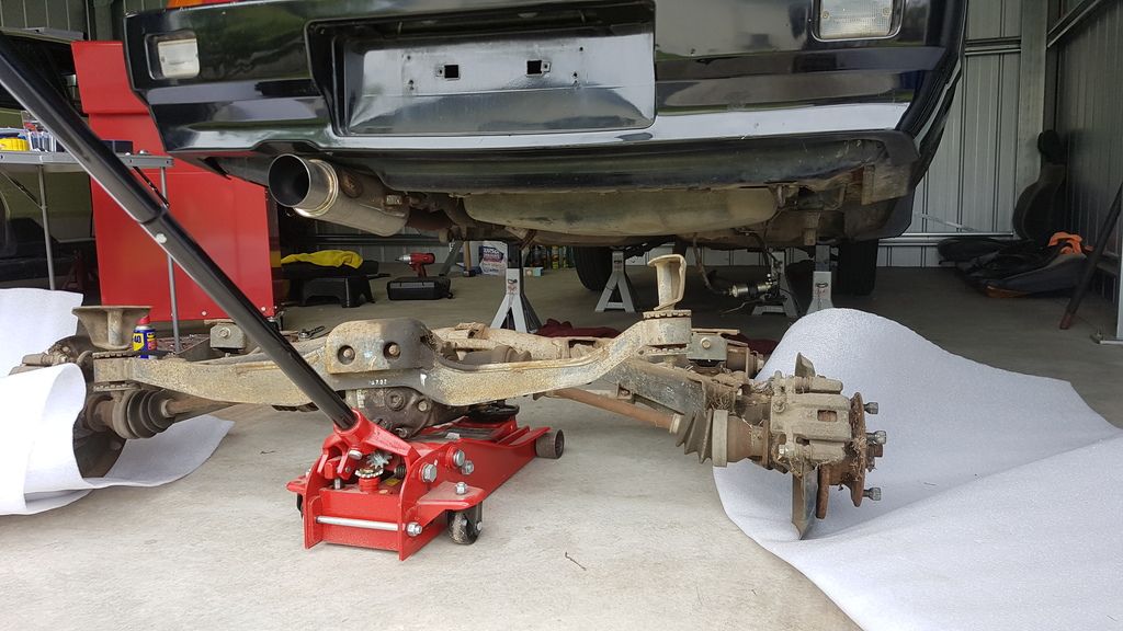

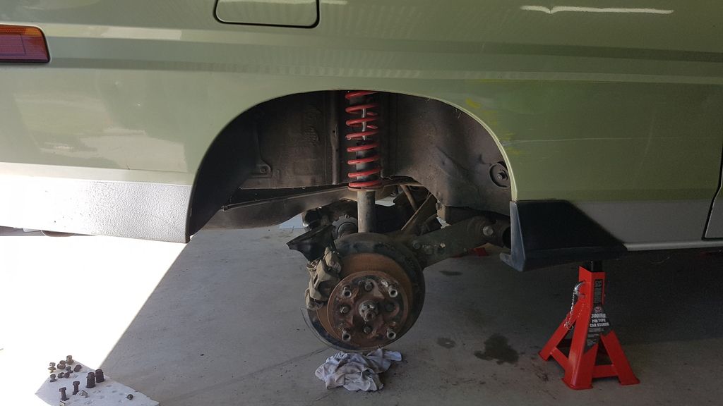

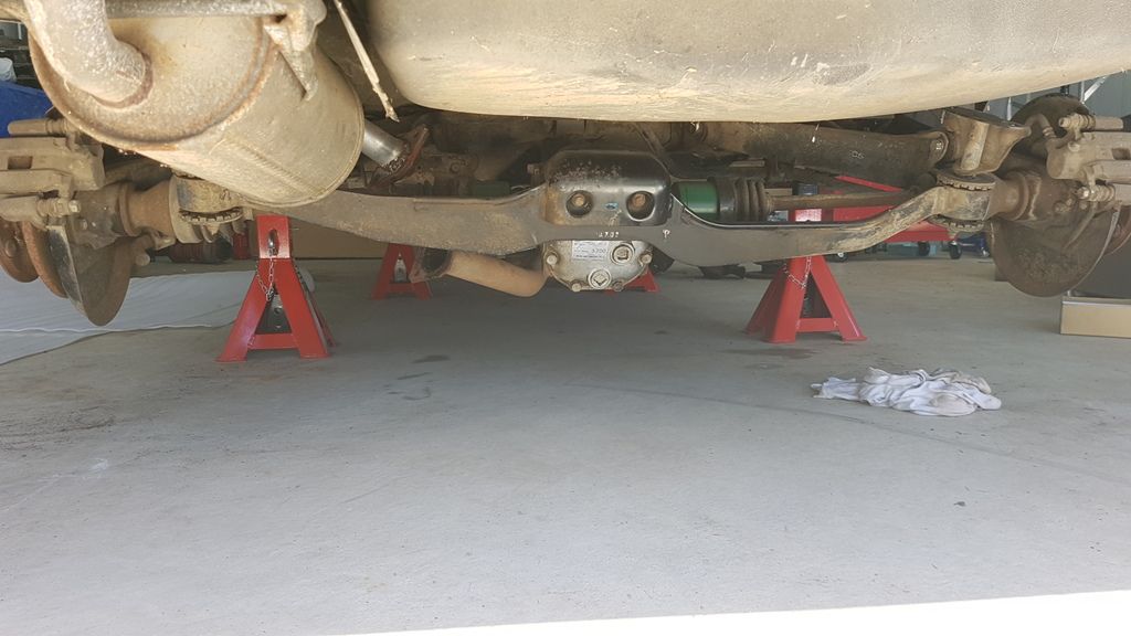

Just an update
Managed to install the rear diff into the new car but will need to drill new holes for the cross members to fit (not sure if i am calling it the correct part) and installed the rear shocks :)
The next part I will need to do is put the rear brakes, so far I haven’t had any major issues.

Post by El_Freddo » Wed Dec 13, 2017 4:45 pm
Looks good low ;)
Dunno what air suspension is worth... I'm sure someone will pick it up - chuck it up on gumtree.
Before you do, I'd be keen to see pics, particularly of the rear shocks ;)
The rear crossmember that you talk about is commonly known as the mustache bar...
