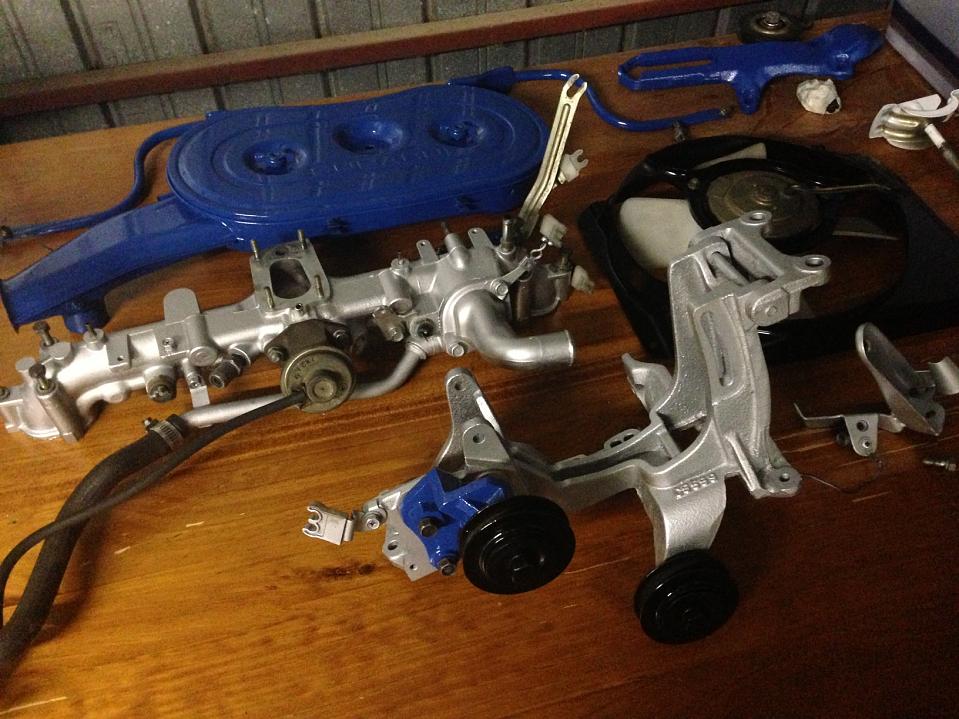

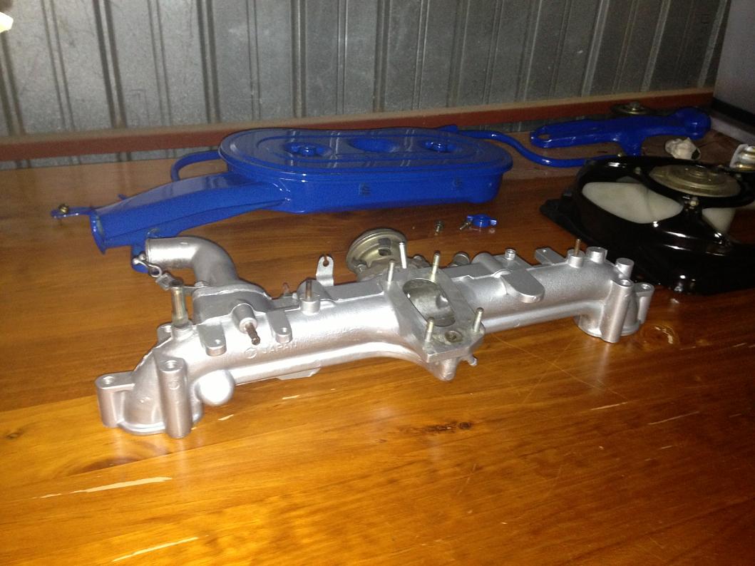

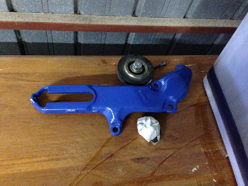

Post by 1983wagon » Fri Aug 23, 2013 6:58 pm
Thought id share what ive been up to :)
